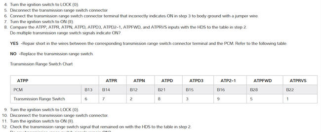

code p0705
2006 HONDA CIVIC
GABY2006
  • 9 POSTS
my car when its off and turn on after a moment the d light comes flashing and check engine is on with code p0705 . when car off and turn back on the d light is normal after a while the d lights flashes on and off i do feel that the trans feels weird when that happen but when the d light is normal the car runs perfect. check all connector for any short and nothing
Jun 8, 2015 at 8:24 AM
HMAC300
  • 48,601 POSTS
that codes means there is a short in transmission range selector.
Jun 9, 2015 at 12:27 AM
GABY2006
  • 9 POSTS
my mechanic check all the voltages and check all wiring cant find the problem. Will this short make my d light flash?
Jun 9, 2015 at 9:53 PM
HMAC300
  • 48,601 POSTS

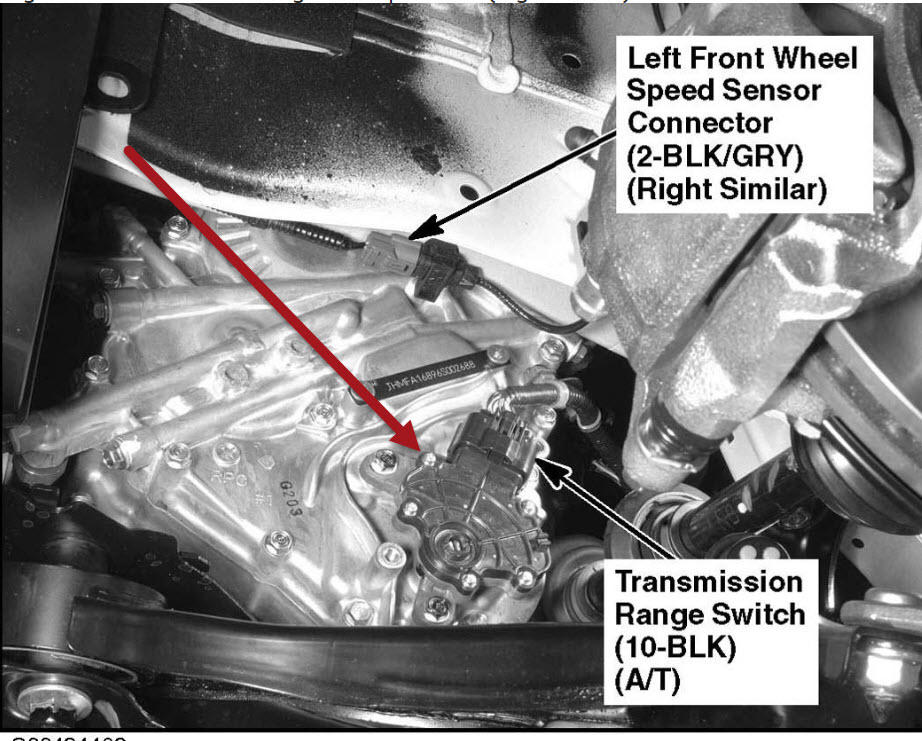

it's a short in the part that is pointed to in pic and yes it would do what you are saying it is.
Jun 10, 2015 at 12:19 AM
GABY2006
  • 9 POSTS
thank you very much because my mechanic replace it to a new one and still doing the aame thing
Jun 10, 2015 at 12:52 AM
HMAC300
  • 48,601 POSTS

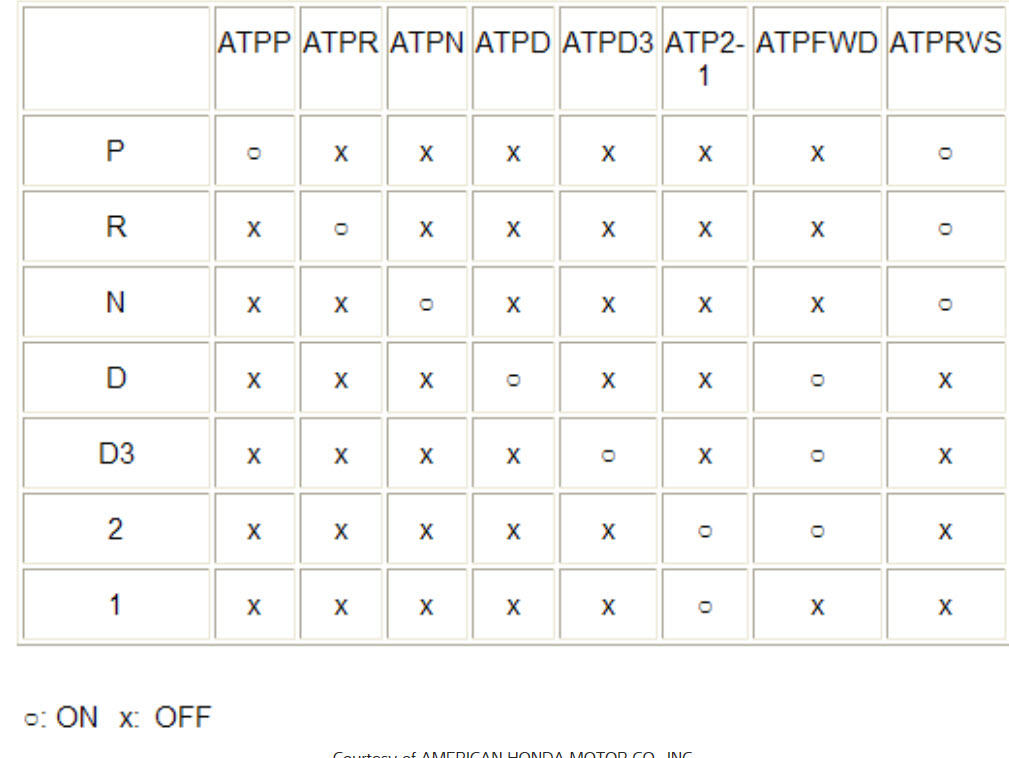

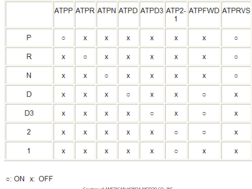

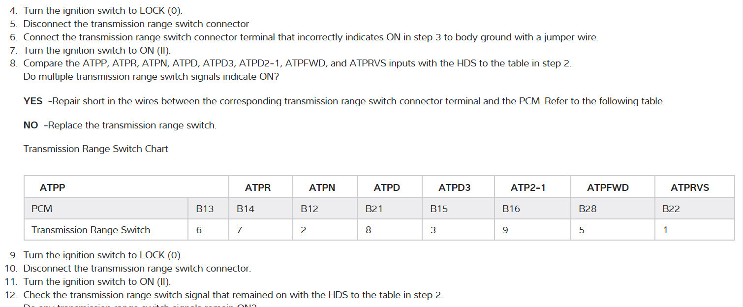

print the two things si'm sending and have him use a scanner to test this the way it says to.
Jun 10, 2015 at 3:24 AM
GABY2006
  • 9 POSTS
thank you very much ill let him know
Jun 10, 2015 at 12:53 PM
GABY2006
  • 9 POSTS
the first picture that you send me with the trans range sensor the shory your pointing would be the red arrow?
Jun 11, 2015 at 3:21 AM
HMAC300
  • 48,601 POSTS
the arrow points to the transmission range selector, It says switch but it's the same part.
