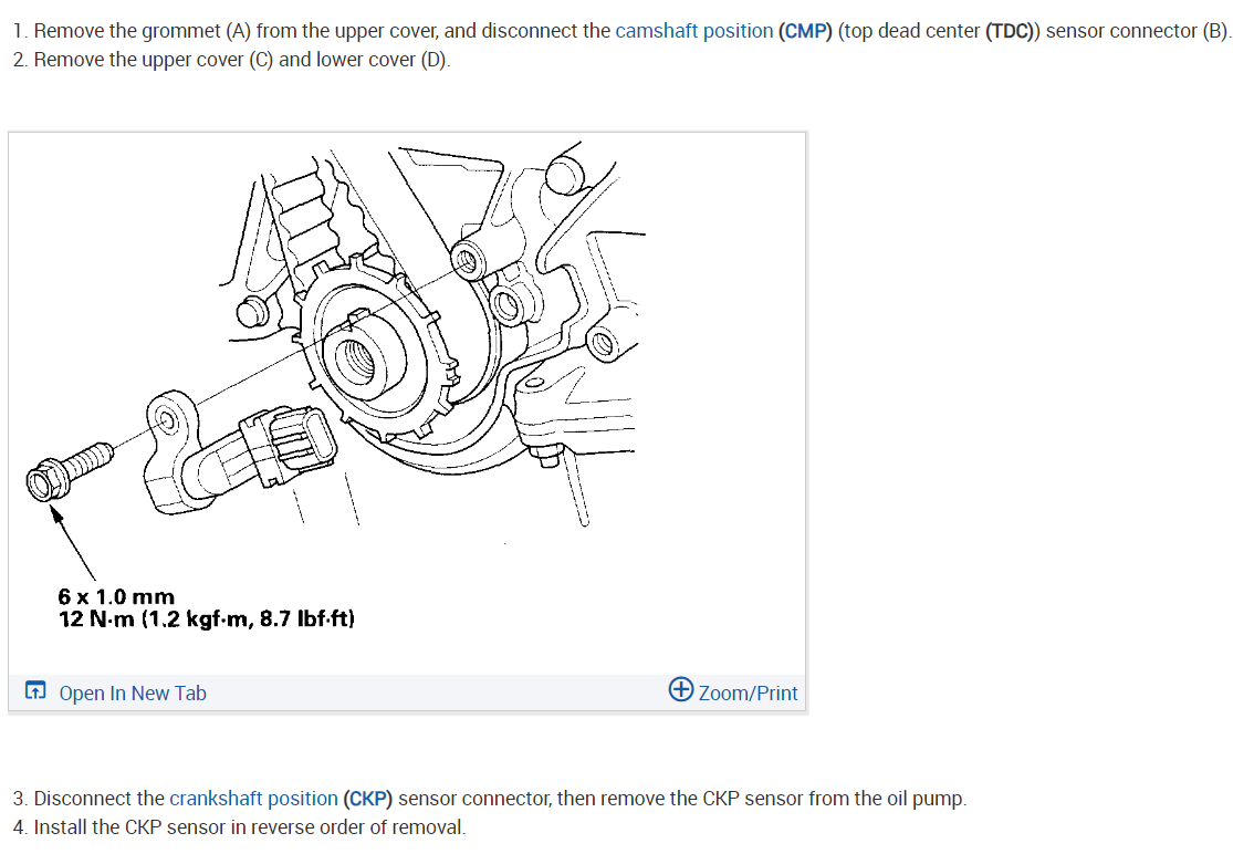

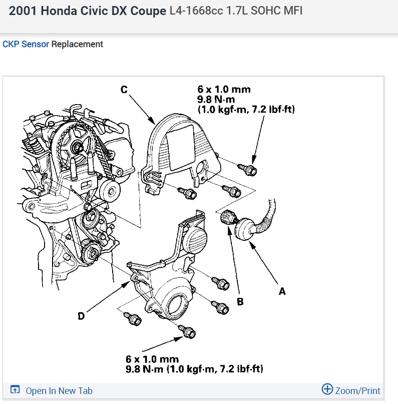

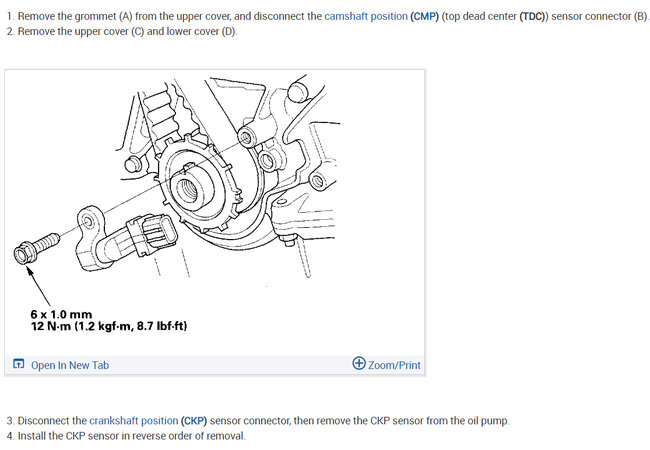

Yep, we need the codes so we can head in the right direction on fixing it, this guide can help
I have seen the crankshaft angle sensor go out and cause this problem, here is how to change it out incase you need it or if you get any kind of ignition codes. Check out the images (below). Please let us know what happens.
