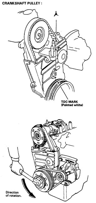

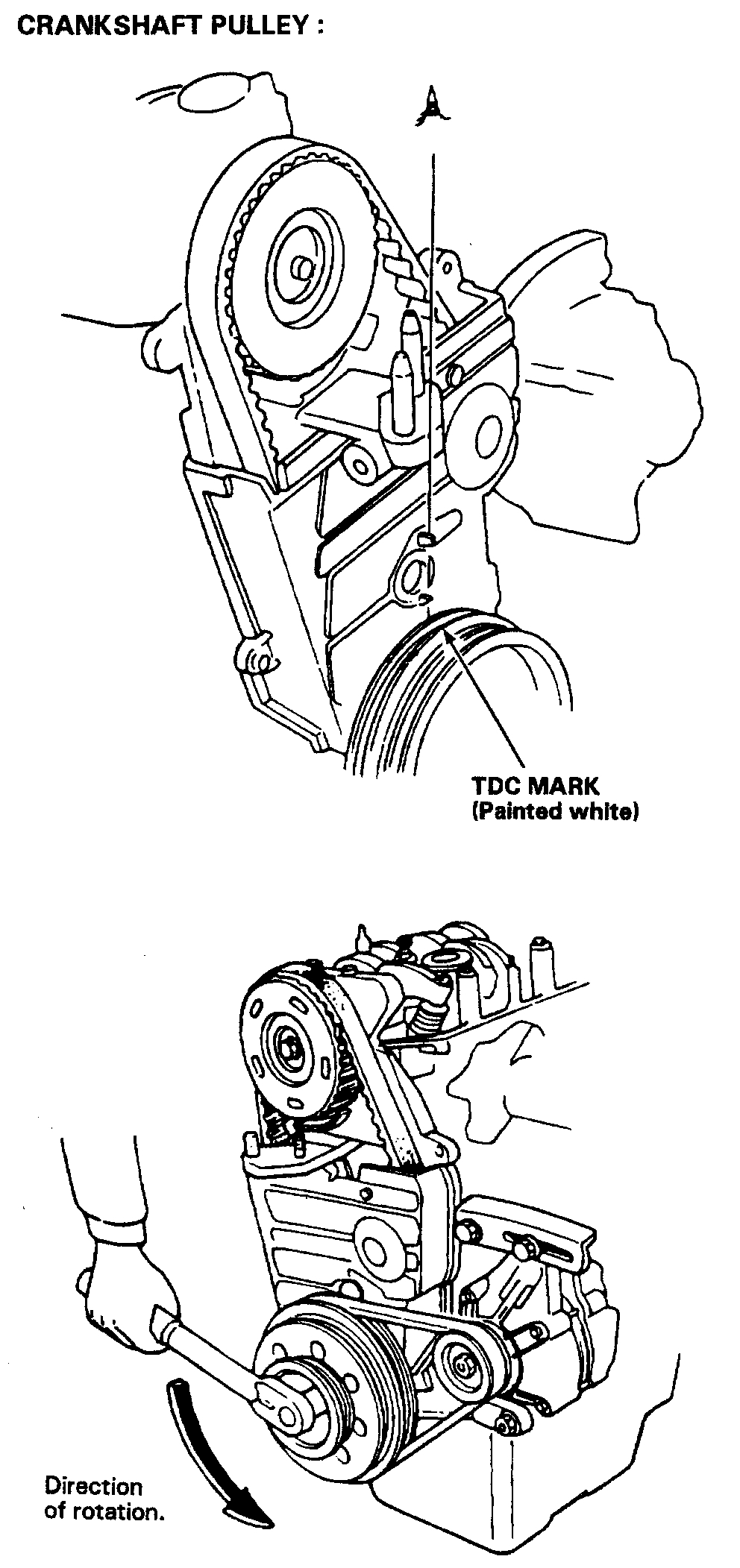

Here are the directions which explain how to reinstall the distributor. However, I noticed it does not mention that the timing mark on the crankshaft pulley must be at top dead center (TDC).
Make sure it is on TDC (see picture 1). Once that is done, then follow the directions. All remaining pictures correlate with the following directions.

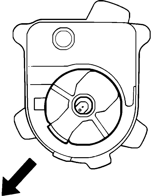

Rotor Positioning
1. Install the rotor, then turn it so that it faces in the direction shown (toward the No. 1 cylinder).

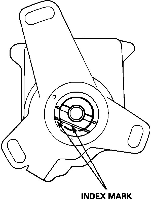

Distributor Index Mark
2. Set the thrust washer and coupling on the shaft.
3. Check that the rotor is still pointing toward the No. 1 cylinder, then align the index mark on the housing with the index mark on the coupling.
4. Drive in the pin and secure it with the pin retainer.

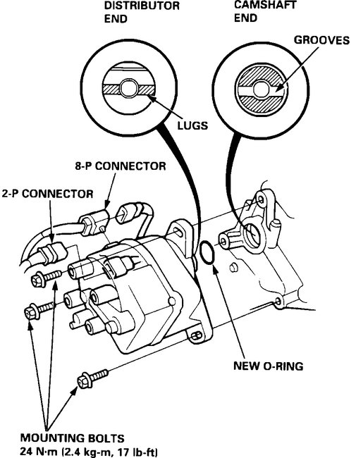

INSTALLATION
Distributor Installation
1. Coat a new 0-ring with engine oil then install it.
2. Slip the distributor into position. The lugs on the end of the distributor and its mating grooves in the camshaft end are both offset to eliminate the possibility of installing the distributor 180° out of time.
3. Install the hold-down bolts and tighten temporarily.
4. Connect the two pin and eight pin connectors to the distributor.

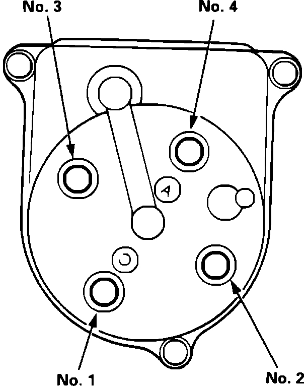

Spark Plug Wire Cap Location
5. Connect the spark plug wires as shown.
6. Set the timing with a timing light and With Service Check Connector Jumped and engine at idle speed.
Specification: 16° ± 2° BTDC.
7. After adjusting, tighten the hold-down bolts. Distributor hold down bolts torque: 24 Nm (17 lb-ft).

Let me know if this helps. Remember, you want TDC (cylinder 1) and the distributor rotor pointing at the number 1 spark plug wire on the distributor cap. Make sure you have the wires correctly placed in the cap also.

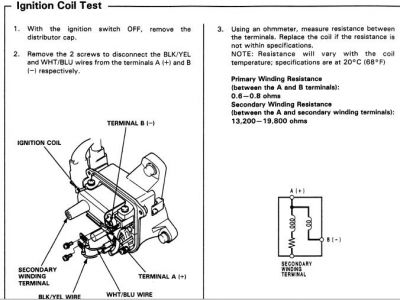

F4I_GUY
  • 3,302 POSTS
https://images.2carpros.com/forum/automotive_pictures/276698_coil_test_1.jpg
https://images.2carpros.com/forum/automotive_pictures/276698_igniter_3.jpg
Test the coil and ICM that is internally inside the distributor. First check your basics though, fuses, loose wires, connections.

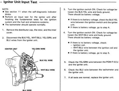

F4I_GUY
  • 3,302 POSTS
Was this distributor used or new? Have you checked the wiring. Do this ICM test, this will help you see if you have all the proper wiring to the ICM.
https://images.2carpros.com/forum/automotive_pictures/276698_igniter_4.jpg

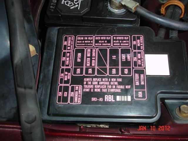

S1920L
While driving my battery light came on. On the way home I stopped at the local auto parts store to have the battery and alternator checked. The battery was fine but the alternator came up bad. Drove home and parked the car. I went to start it two days later and it would turn over fine but no spark. Could a defective alternator toast my distributor? The distributor was replaced in September by the way.
Jan 4, 2021 at 12:29 PM (Merged)
HMAC300
  • 48,601 POSTS
the alternator shouldn't toast the distributor but starnger thing have happened. check your underhood fuses though, there is one for the alternator, i thinkis #41 otherwise it may be an module problem not the distributor. or a ground for the module.
S1920L
There is no #41 fuse. There is a fuseable link #41 printed on the wiring diagram but no such fuse.
HMAC300
  • 48,601 POSTS
well check that s they burn up. in our manual it was listed as a fuse. oh well stranger things have happened.

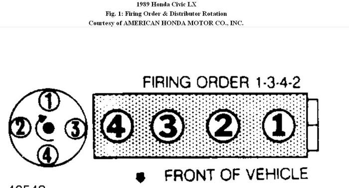

i have a 89 Honda civic lx I put a new distributor on and it won't start its getting gas and had good spark it fires but won't start
Jan 4, 2021 at 12:30 PM (Merged)
KHLOW2008
  • 41,814 POSTS
Were the firing order of the spark plugs lined up correctly?
What was the reason for replacing the distributor?
BUTCH SWICKARD
  • 10 POSTS
Dome one stole it and the firing orders fight
KHLOW2008
  • 41,814 POSTS
Retime the distributor. Turn piston # 1 to TDC on firing stroke and note if distributor rotor is pointing to # 1 cylinder. Some remand distributors are installed 180 degrees oposite so the firing order would be out.
If engine had been idle for extended periods, check the compression. They could be low due to the cylinders drying out and does not have any lubrications to seal the piston rings. Remove spark plugs and pump some engine oil into cylinders. Crank the engine for a few seconds and reinstall spark plugs and retest.
BUTCH SWICKARD
  • 10 POSTS
How do I put the distributor to number 1 piston
KHLOW2008
  • 41,814 POSTS
Note the position of the spark plug wire for # 1 cylinder on distributor cap and when crankshsft is turned to the correct position, the rotor should be pointing at the place where the #1 spark plug wire should be when distributior cap is installed.
BUTCH SWICKARD
  • 10 POSTS
What is the firing order how do u know which one is the number one looking at it straight on
KHLOW2008
  • 41,814 POSTS
See attached diagram.
BUTCH SWICKARD
  • 10 POSTS
What why I'm I looking at the 1342
KHLOW2008
  • 41,814 POSTS
Have you got it correct?
