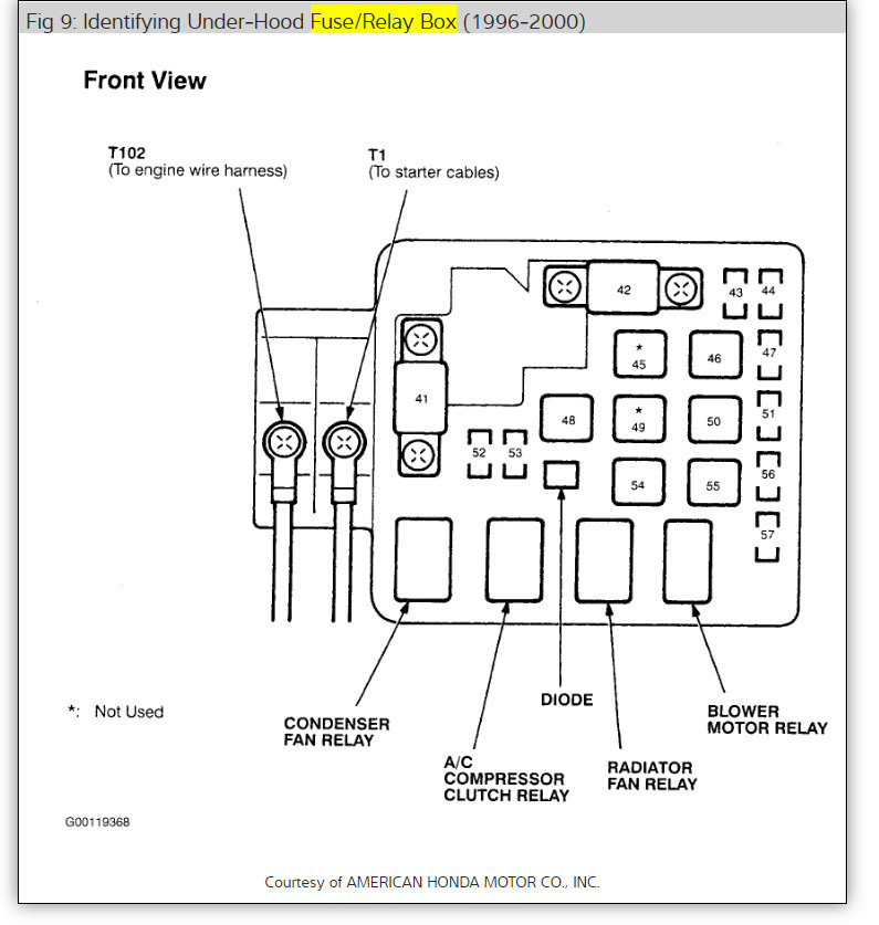

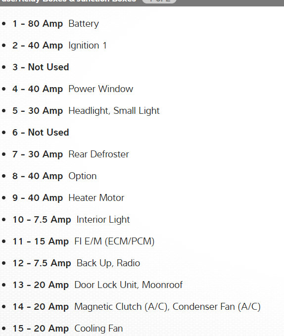

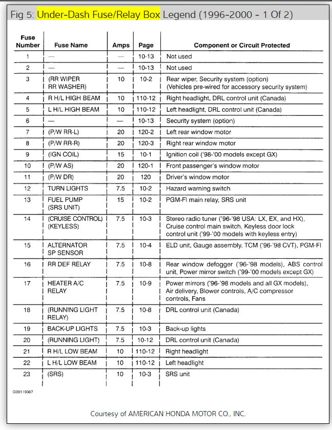

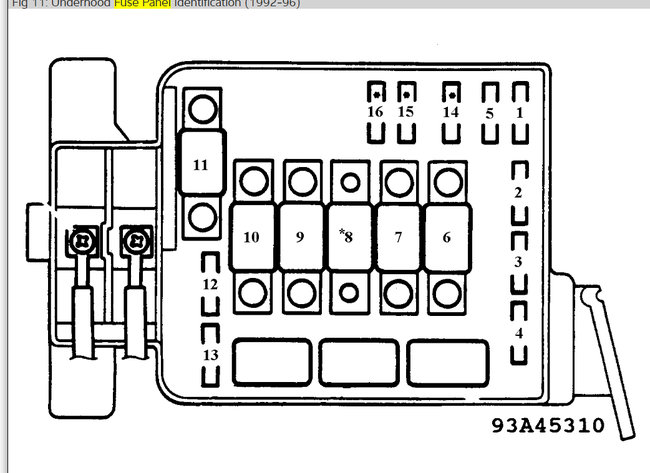

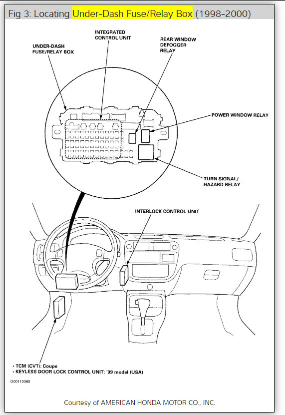

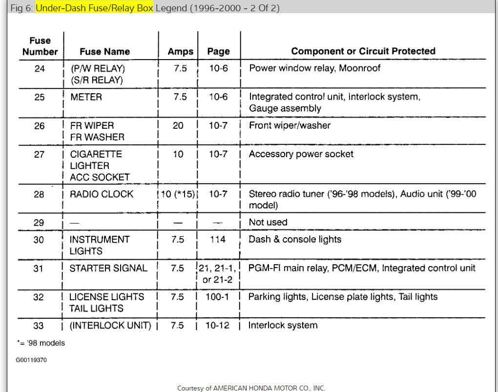

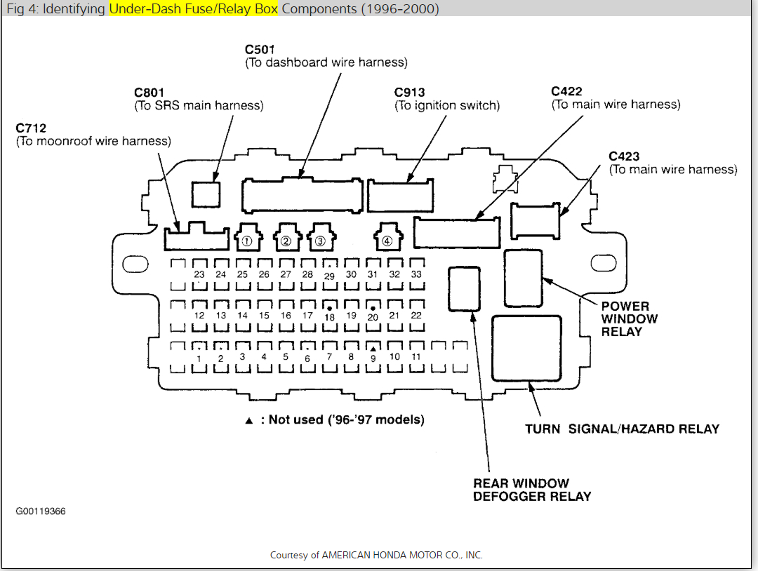

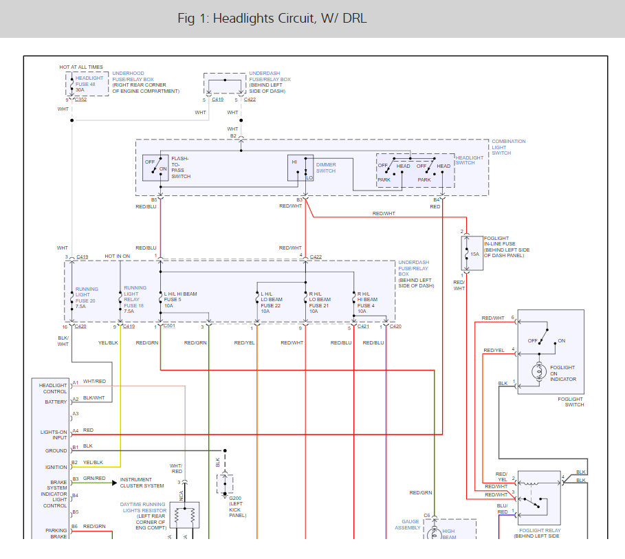

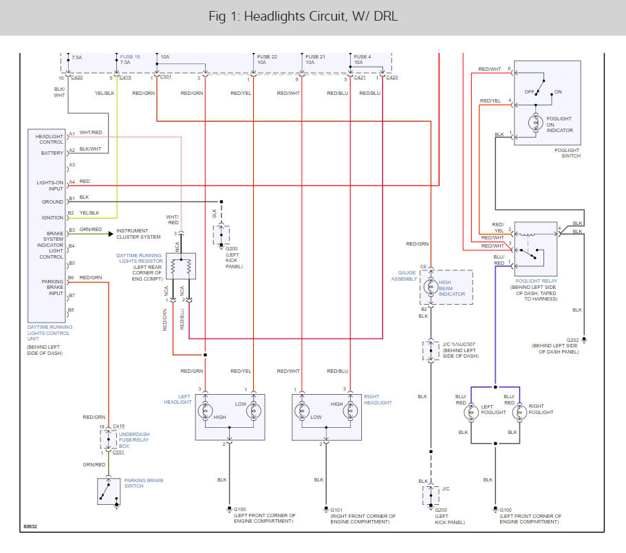

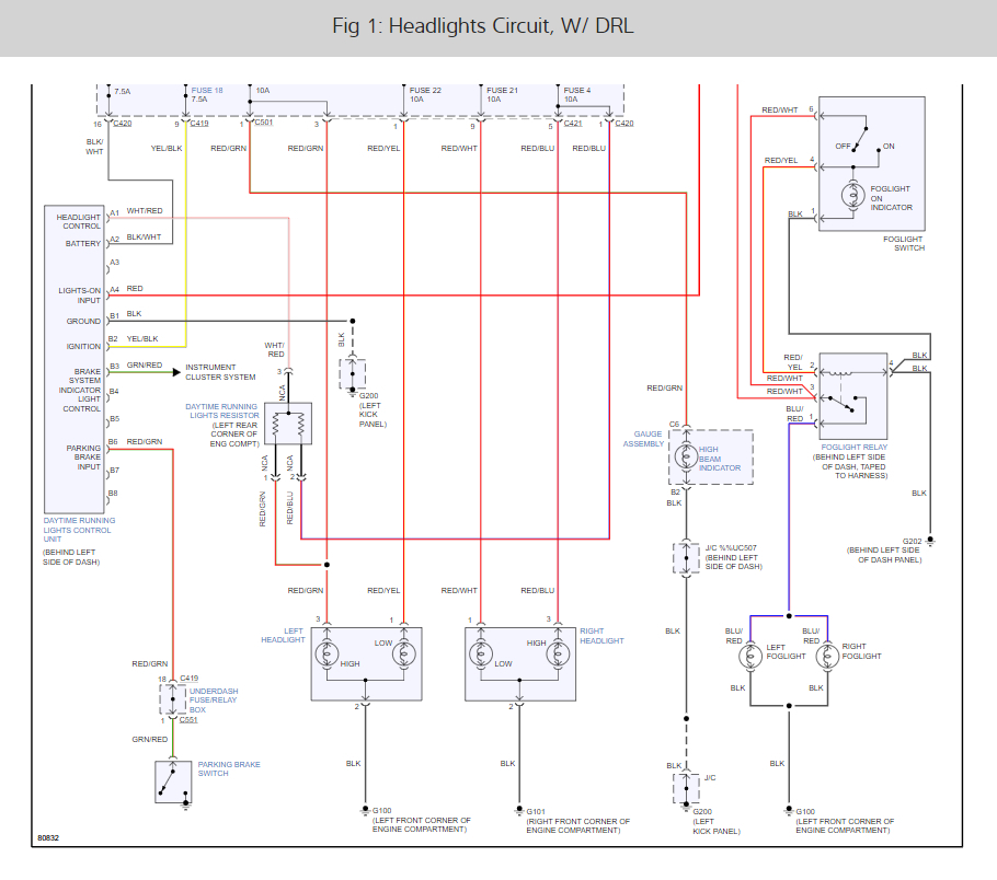

My headlights don't work but my brights do. I changed new bulbs but no help. Also my turn signal flasher is slow to flash. Any ideas on how to fix or where to go?
Wednesday, September 29th, 2010 AT 6:32 AM
KHLOW2008
  • 41,814 POSTS
Hi Byron,

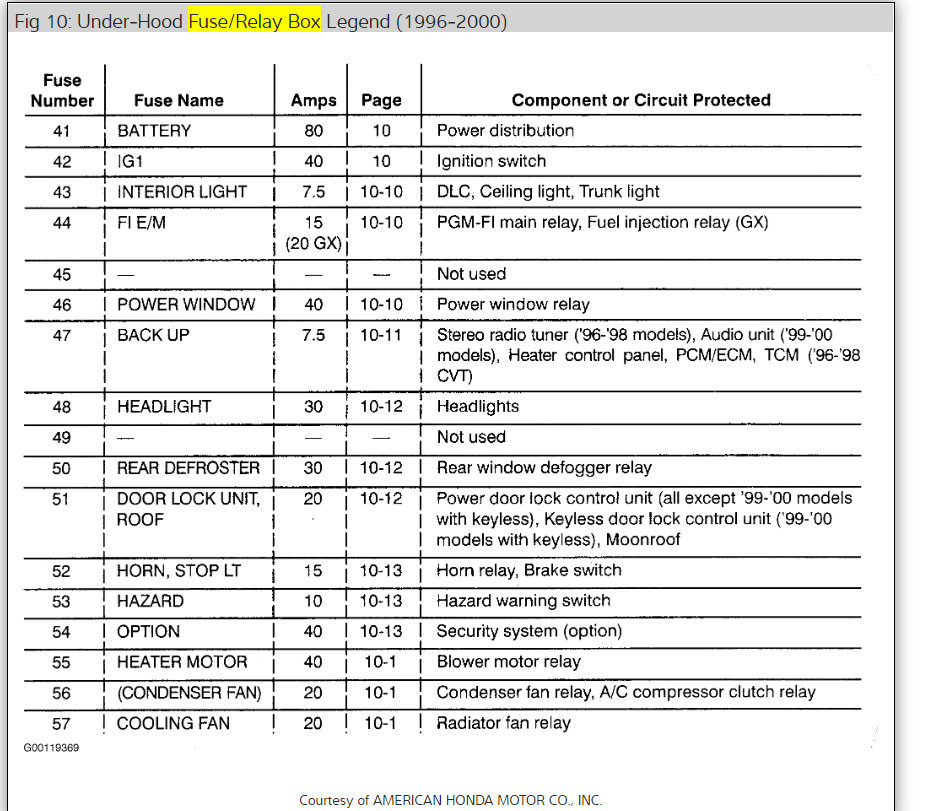

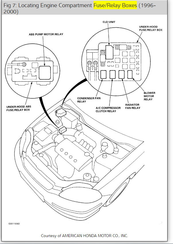

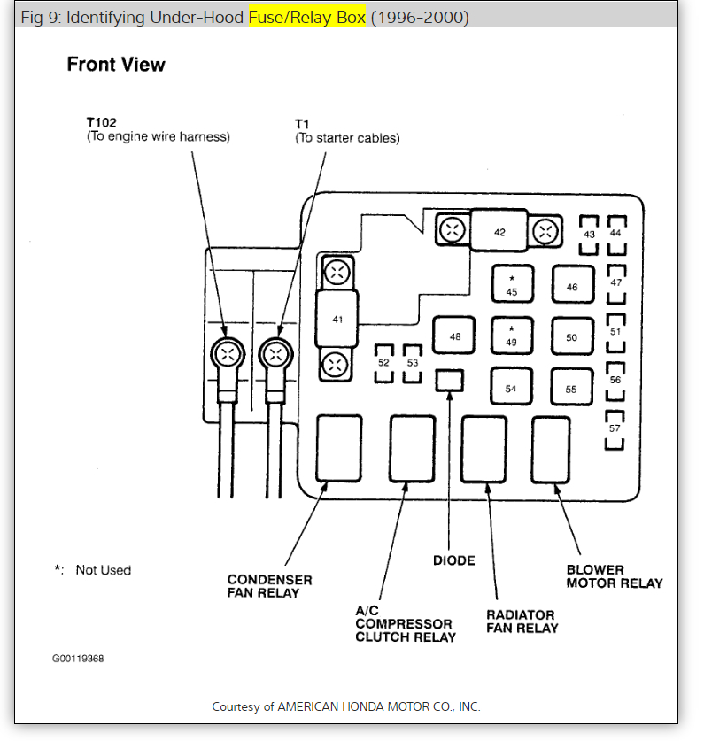

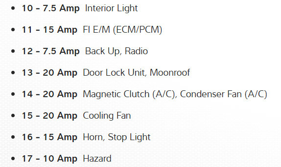

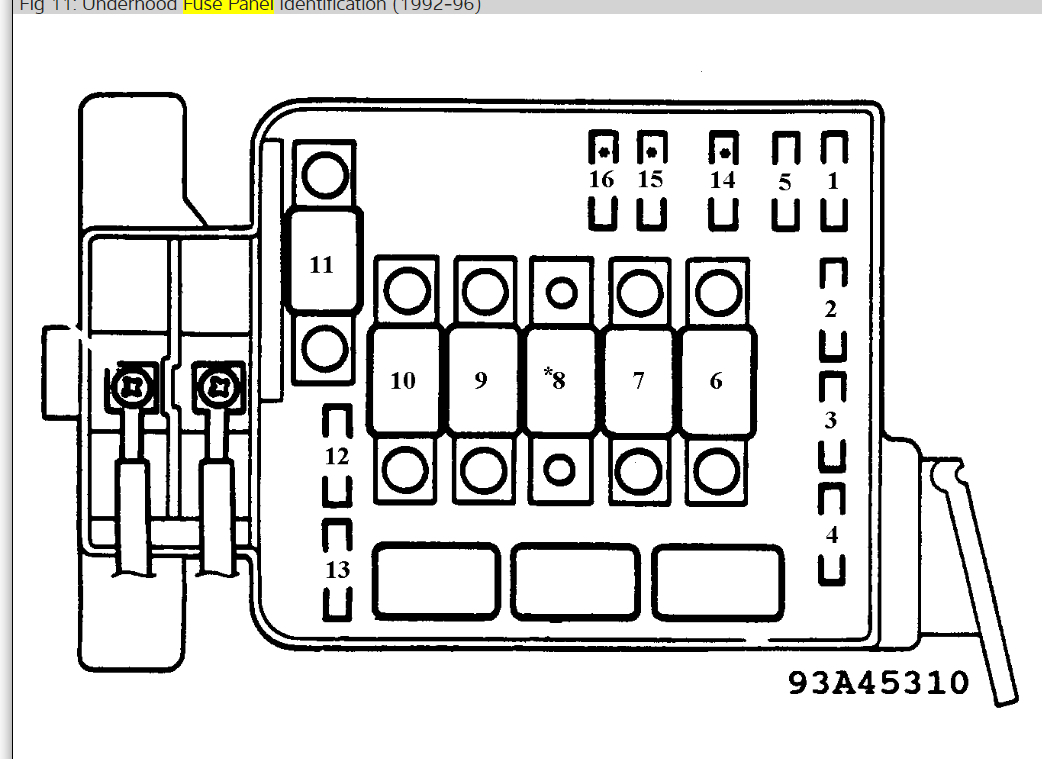

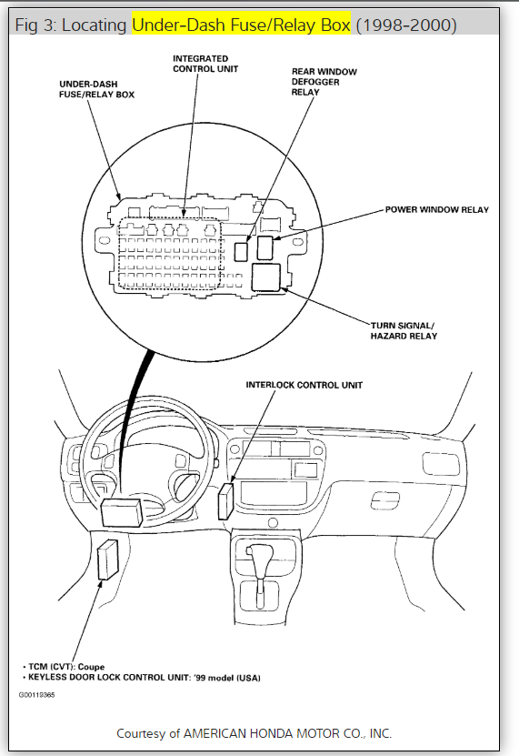

Have you checked the fuses? If they are good, you would have to test the light switch. THese guides and the headlight wiring diagrams below should help us fix it.
and
I have also included the headlight wiring diagrams so you can see how the system works. Check out the diagrams (Below). Please let us know what you find.
