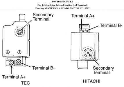

Ignition Coil Resistance Test
Turn ignition off.
Remove distributor cap.
Remove primary leads from ignition coil.
Using an ohmmeter, check primary resistance between ignition coil terminals "A+" and "B-". See Fig. 1 .
Resistance should be as specified.
Check secondary resistance between ignition coil terminal "A" (+) and secondary output terminal (coil tower).
If readings are not as specified, replace ignition coil.
http://www.2carpros.com/forum/automotive_pictures/192750_IgnitionCoil99AccordFig01_1.jpg

Primary is around 1 or a little below - ohm meter not precise enough to measure better than that and around 16.5 k on secondary.
