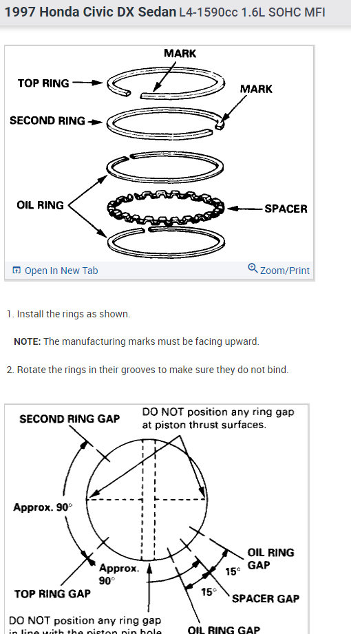

Son drove car with low oil level. Now using 1 qt oil for every 400-500 miles and showing blue smoke under acceleration. Tried "oil restore" additive but only provided moderate reduction in showing blue smoke. I am a weekend mechanic and not sure how to determine if the problem might be valves or piston rings so wondering if replacing piston rings would be a worthwhile first step to repair this problem? Or with a high mileage engine such as this should we just consider a re-built or used engine replacement instead?

As you know the blue smoke is due the engine burning oil.
Now you could have piston rings leaking and allowing oil to enter the combustion chamber.

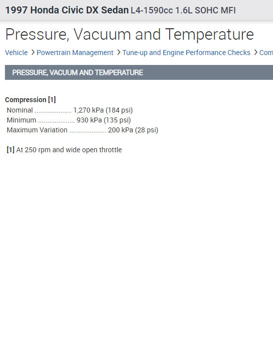

First you need to do a compression test for all the cylinders.
You can get a compression tester from you local auto parts store, they will usually rent those.
You should have minimum of 135 PSI of compression and the maximum variance between the highest to lowest cylinder cannot be over 28 PSI
Here is a helpful guide of compression test:
