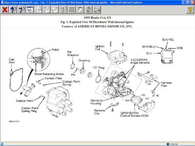

Ugh. We got the car towed to the dealer last night and I just talked to the tech. Apparently the entire distributor is foobed.
I was told that the distributor sub assembly is leaking oil. The coil and igniter need to be replaced just to get the car moving, it'll run for a while with a leaking sub assembly but that needs to be replaced as well. The fun part is that they don't have parts on hand and need to order them. I'm looking at about $800 in parts alone and about a week before they get them in hand because of the holidays.
Dad's thoroughly confused about the "sub assembly is leaking oil" part. Leaking into the sub assembly? Leaking out of it? He didn't know there was oil in there. And what exactly is the sub assembly compared to ordering a distributor with cap and rotor from someone like PartZone, which I'm seeing for about $250?
I'm hoping that the costs and repair needs they're quoting are legitimate and not just a case of taking advantage of a girl who doesn't know better. With 208K miles on the car and this is still original equipment, I guess I'm not surprised that it needs to be done. I'm gasping at the cost.
Tuesday, December 23rd, 2008 AT 1:01 PM
BRUCE HUNT
  • 3,754 POSTS
Well first off the sub assembly will be the case that the distributor is in. The shell so to speak or the outside. Now, the distributor does not contain oil and should not. That leak they speak off can cause the parts to go bad. The subassembly has an oring that can be replaced.
http://www.2carpros.com/forum/automotive_pictures/10316_95_Dist_1.jpg
Personally, I would go with the other distributor. The diagram shows all of the components in the distributor. There are quite a few. Buy the distributor and put it on yourself. The only two big things to watch for are to have the timing checked once it is put on and to make sure that you note where the plug wires came off from and put them back on exactly like they came off from the old one.
