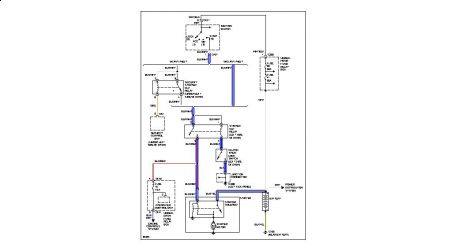

If battery and connections are okay-start check the following:
Check and test the starter cut relay and clutch interlock switch and starter itself
http://www.2carpros.com/forum/automotive_pictures/12900_starter_honda_civic_1.jpg
