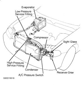

Hello, I have had my car for 2 yrs without any issues. When I got the car the AC needed recharged, done; drove the car it was cold. the next afernoon the air didn't blow cold at all, thought there was a leak, no leak. I did some research, replaced the thermal sensor and the relays, still nothing. Lastly I noticed the AC would only work then the car was cool (not sitting in the sun all day) . I could get cold air first thing in the morning, but never after work, when the car sat in the sun all day. Any ideas?

Can you tell me if the A/C compressor clutch is engaging at all? Get back to me and we will take it from there.

Ok so if it is blowing hot air and the clutch is engaging then the system is low meaning it leaked out over the winter. Now if the clutch is not engaging the system is either to low to engage the clutch or one of the pressure switches is not functioning right. I have included a pic of the reciever dryer. If there is a sight glass on it then I need you to turn the a/c on if the clutch engages then look in the sight glass does it look like liquid or like liquid with air bubbles in it?

Well I am not 100% sure where that is located, if it is on the drivers side front just under the steering fluid reservoir, I didn't see a glass opening. Maybe I am looking in the wrong place.

Ok it is in the drivers side front corner under the hood. Here is a pic of the system and it shows that there should be a sight glase on it, it is labeled as reciever dryer. It may have a rubber boot or cover on it. Let me know what you find.
