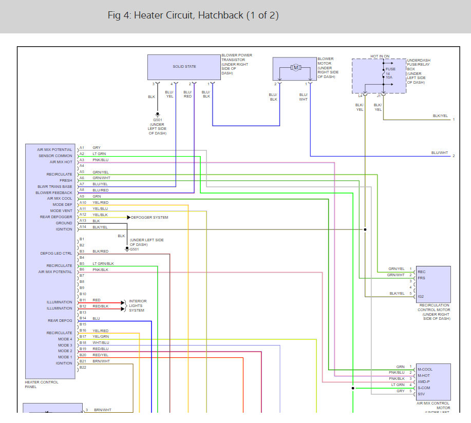

MY A/C was working on Friday. When I got in the car on Saturday. It stayed cold while it was working then all of a sudden just would not work anymore. The blower doesn't even come on when I turn on the blower switch. Even if i just turn on the heater the blower will not come on. All fuses that I can find are good. Even the cooling fan runs but I don't know if there is a separate fan for the A/C. What else besides fuses can I check? If there is a relay problem how do I test it?

The compressor isn't coming on either. Nothing with the a/c works at all now and this just happened all at once. Could the blower switch inside the passenger compartment be bad since the blower wont come on when the heater is set to come on as well?

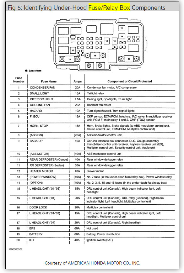

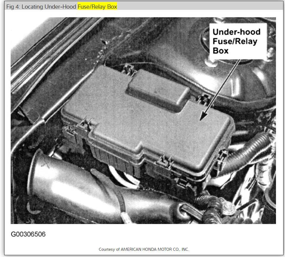

It would more likely be a fuse problem since so many items failed at the same time.
Check the underhood fuses.

[quote:0034b73ebb="KHLow2008"]It would more likely be a fuse problem since so many items failed at the same time.
Check the underhood fuses.[/quote:0034b73ebb]
All those fuses are good as I stated in the original question. Are there any more fuses anywhere in the vehicle that could be causing this? Could it be a relay?

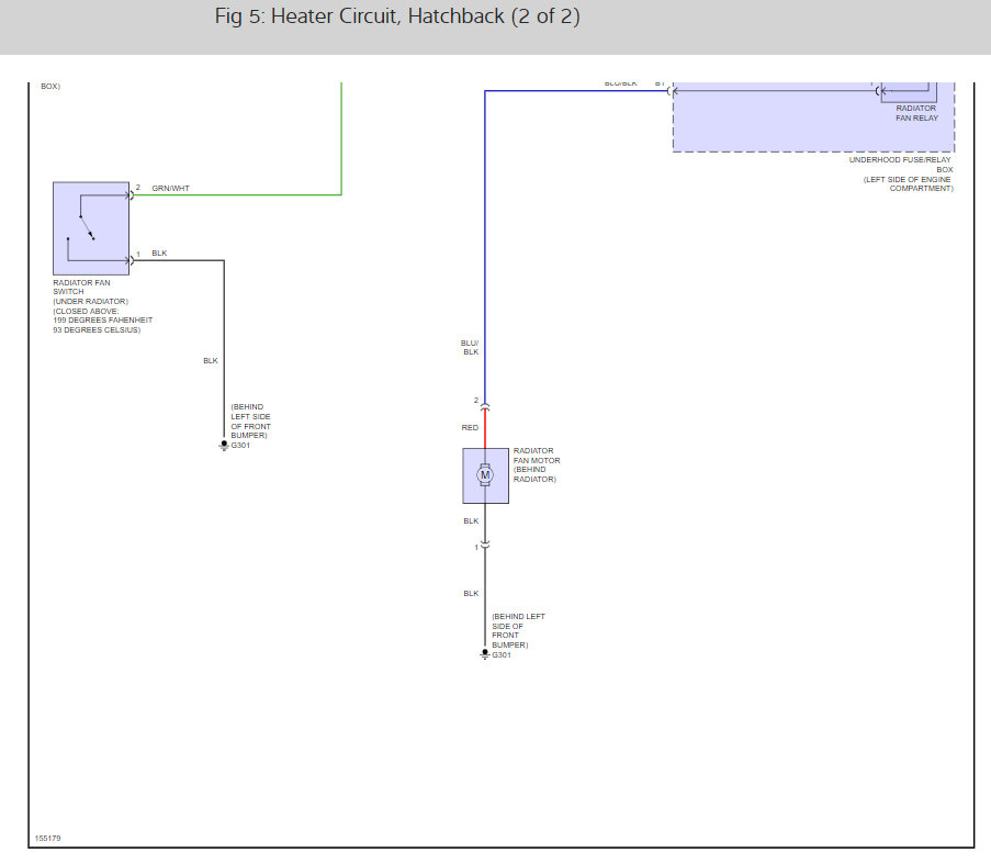

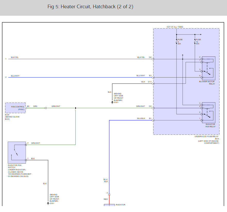

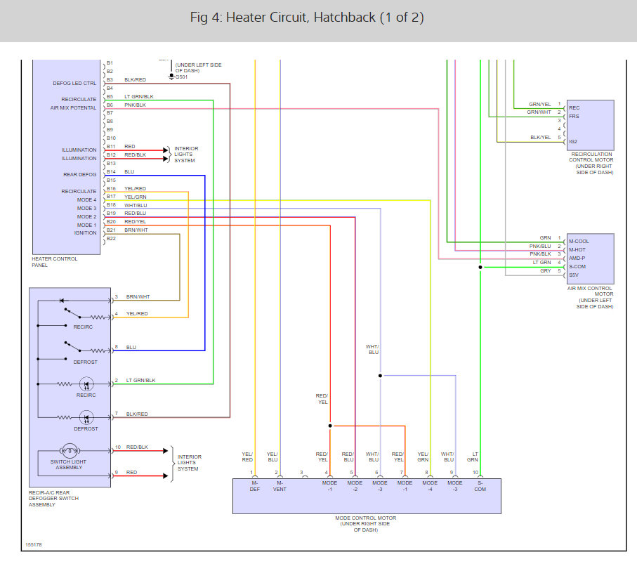

KHLOW2008
  • 41,814 POSTS

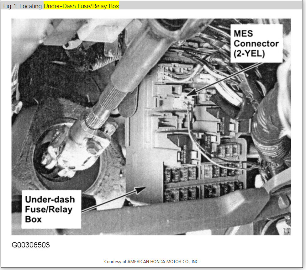

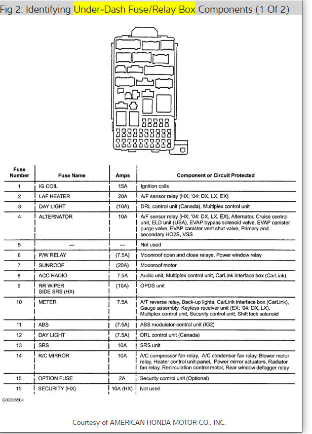

Here are the schematics for the AC. Check through them for fuses and relay. Here is a guide to help you test the relay and wiring diagrams to help you see how the system works.
Check out the diagrams (Below). Please let us know what you find.
Cheers
