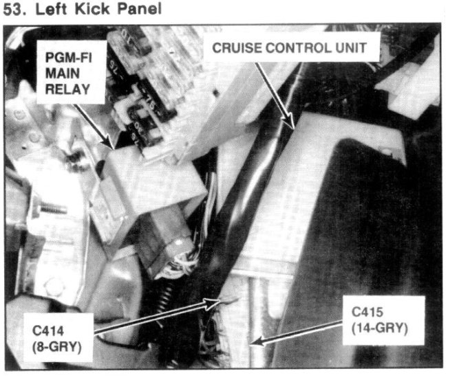

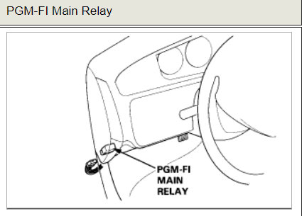

I am totally ignorant of car repair. I have a shade tree mechanic who is ill right now. He tells me that I need to replace the main relay for the fuel pump and that this is simple. I have located the part, but am unsure of where the item is located on the car and how to go about switching it out.

Here is a guide to help you see how to remove the relay
Here is the location the fuel pump relay is called a PGM- FI relay btw.

Fuel pump relay does not use any switches. It is controlled by the engine computer.
