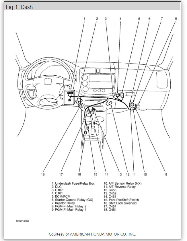

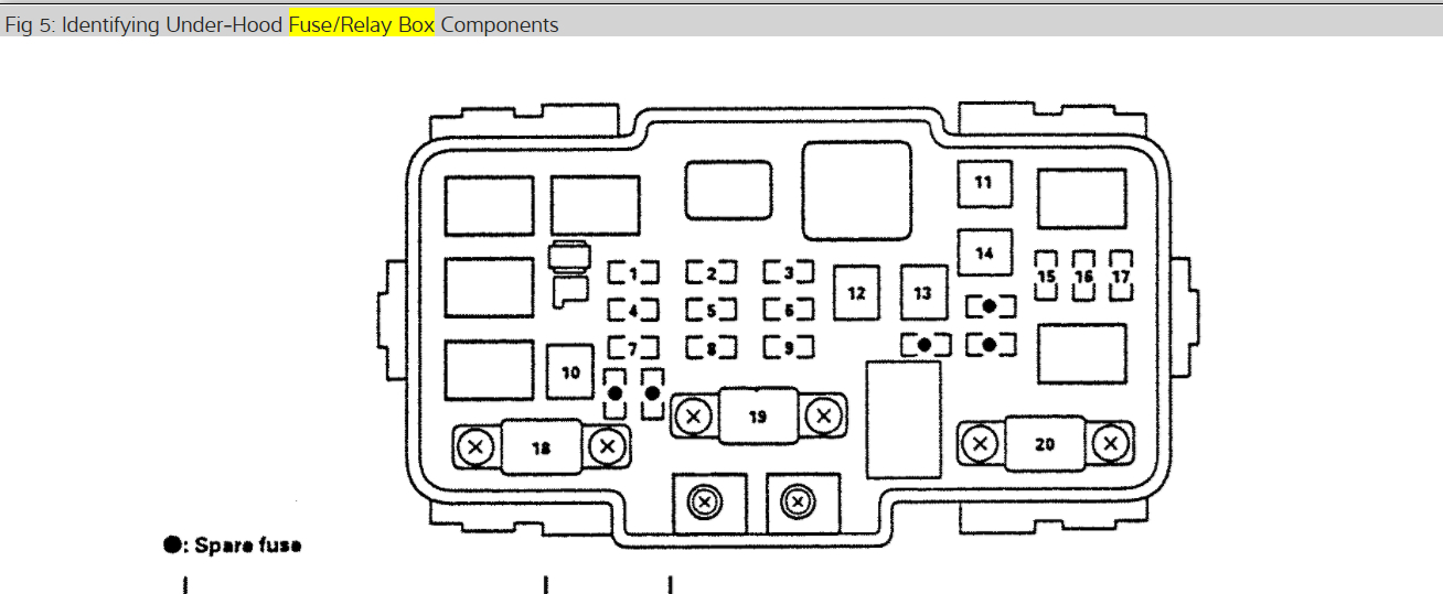

This sounds like you want to replace the PGM-FI relay which controls the fuel pump and the ECM there are two for your car here is a guide to help you test the relay
The location of the fuel pump (PGM-FI) is in the center of the dash

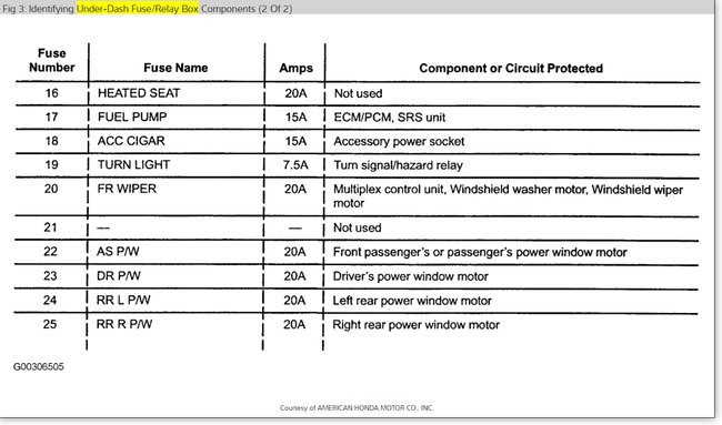

Can I by past the fuel pump relay?
Sep 30, 2019 at 12:17 AM
STEVE W.
  • 15,348 POSTS
Bypassing the relay for testing is okay however keeping the bypass in place will let the pump run all the time and drain the battery in short order. What is the vehicle and issue you are having?

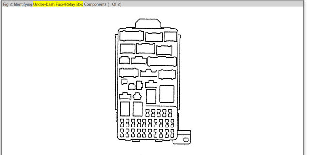

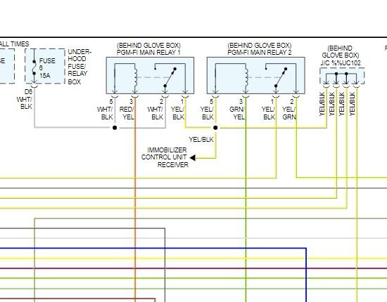

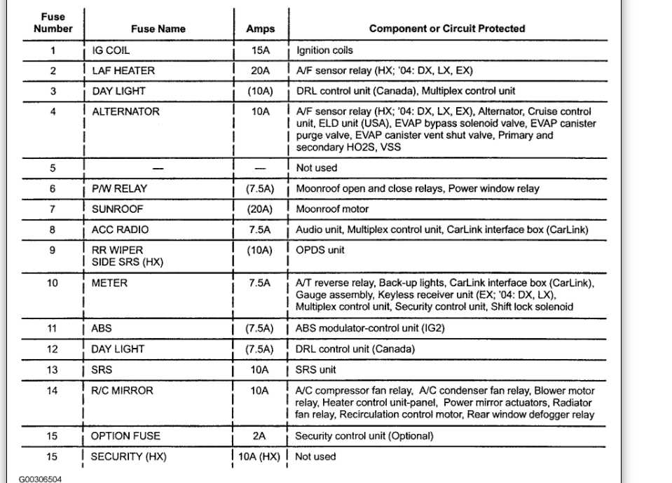

Hello there , my 2001 civic LX sedan 4 door only has 3 relays behind the glove box
From left to right
Black , [Empty Spot] , Blue , Brown
I wanted to ask if you had a diagram of these relays .
The empty spot has no wires to hold the relay in place
And I've noticed that the other diagrams mention 2 PGM FI relays
Jan 27, 2020 at 4:25 AM
STEVE W.
  • 15,348 POSTS

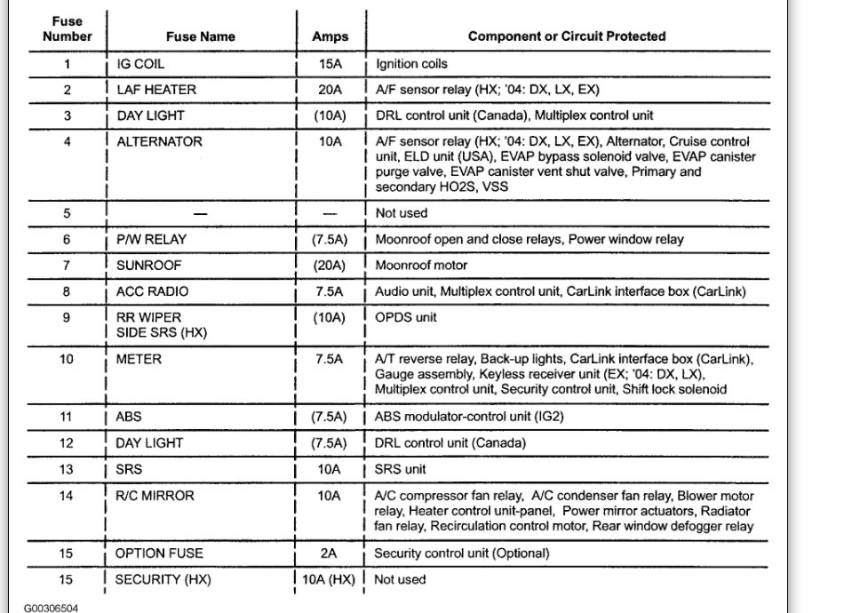

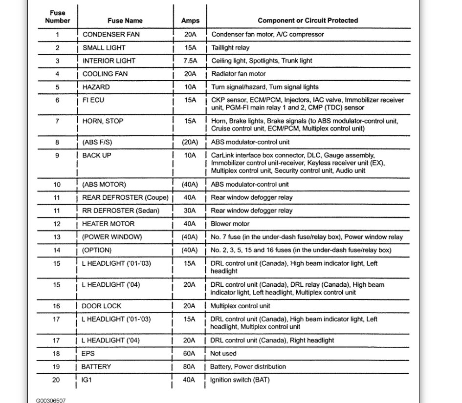

Correct there are 2 PGM relays, but they are interconnected. The first relay turns on and it supplies power to the second relay which is controlled by the immobilizer part of the anti-theft system. The first relay gets power in on the White wire with black trace from fuse 6. When it is activated by the PCM in response to the key, it then supplies power through the Yellow wire with black trace to the 2nd PGM relay. If the immobilizer detects the correct key it provides a ground to that relay which powers the other parts of the engine control systems.
The third relay is for reverse. If you had another model of the Civic the relays are a bit different, that is why there are the extra places.
