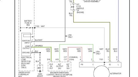

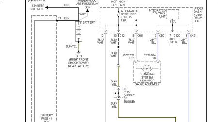

i just replaced battery, alternator, sparkplugs, cables and distribuitor but it's still not starting but it only does it once in a while because some days it works great and some days I have to jump it in order to start I also cleaned the conections to the alternator but it is still displaying the battery warning light. I understand its an old car but if there is anythingelse I could do please let me know thanks

Check the power wire running from the alternator to the battery. Perform a voltage drop test on it. Anything more than 0.3V is unacceptable.
