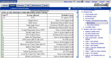

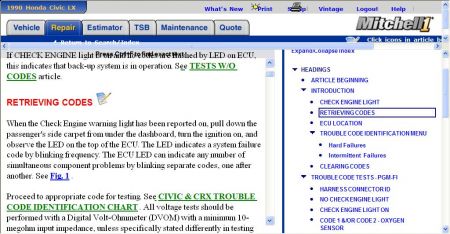

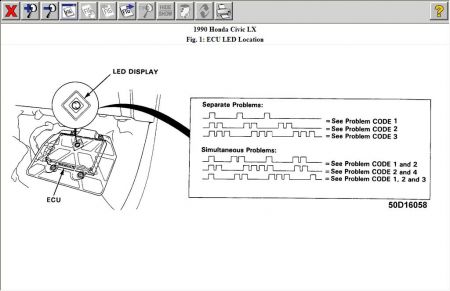

I wanted to know how to read and check the engine light code on my 90 Civic HB. I think it's a 1.5 liter dual point fuel injected. I don't know how to read it and I think it may be my Idle air control valve because the rpms going up and down from 1500 to 500. I just need some steps on how to check the codes and maybe clearing it. Thanks.

https://www.2carpros.com/forum/automotive_pictures/12900_code_reading_1.jpg
https://www.2carpros.com/forum/automotive_pictures/12900_code_reading1_1.jpg
https://www.2carpros.com/forum/automotive_pictures/12900_code_reading2_1.jpg

Clean out the idle air control valve could be sticking and also look for vacuum leaks
