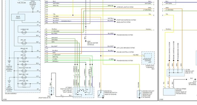

I have a 1995 Honda Accord LX 2.2L with 152,000 miles I have a had a problem with my speedometer and odometer not working. Sometimes they both work but most of the time my speedometer reads 20 MPH with the car started and my odometer doesn't move. What could be the issue?

Sounds like it could be a problem with the VSS (Vehicle Speed Sensor). Does the transmission shift correctly? If so the VSS is most likely good and you are looking at an issue in the instrument cluster
See the attached wiring diagram- The VSS goes straight to the cluster for speedometer/odometer

The odometer and trip odometer have stopped working on my 1994 Accord. The speedometer and Tach are fine, just the odometer(s).
What could be the problem and how is it fixed?

KHLOW2008
  • 41,814 POSTS
Hi mak1010,
Try pushing the trip meter button a few times to see if the odometer starts working again.
As speedometer is working, it is not a bad vehicle speed sensor. The problem lies in the meter cluster, it could be a bad motor for running the odometer and trip meter.
It could also be a bad printed circuit in the meter cluster.
