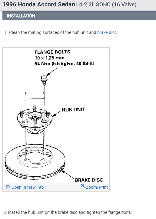

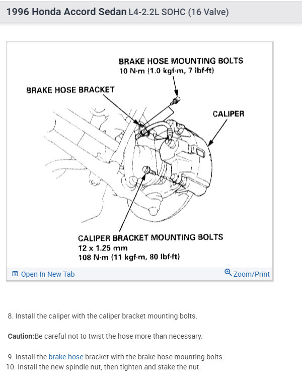

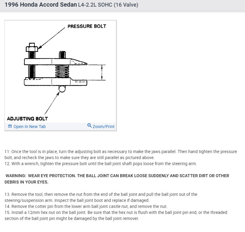

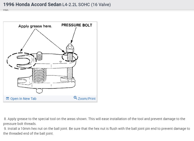

I have been trying for hours to get the front rotor off, I've followed all the steps. I am at the 6 of 10 step now. I even rented a tool that was suppose to help pull it off, but it still is not coming off.
Saturday, October 6th, 2007 AT 9:00 PM
SQM
  • 6,383 POSTS

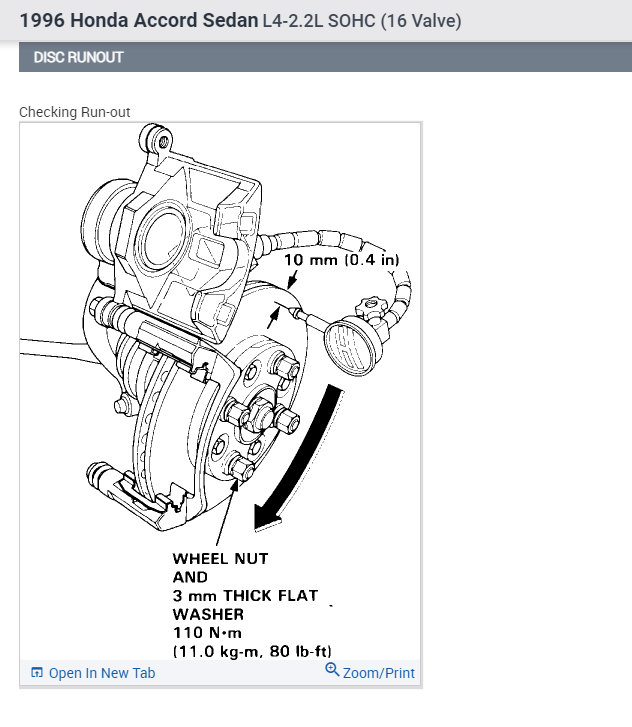

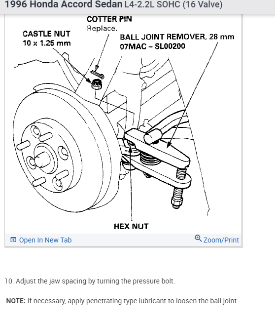

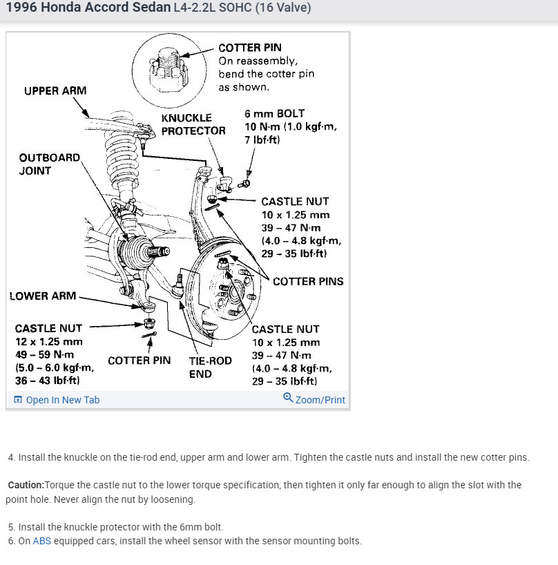

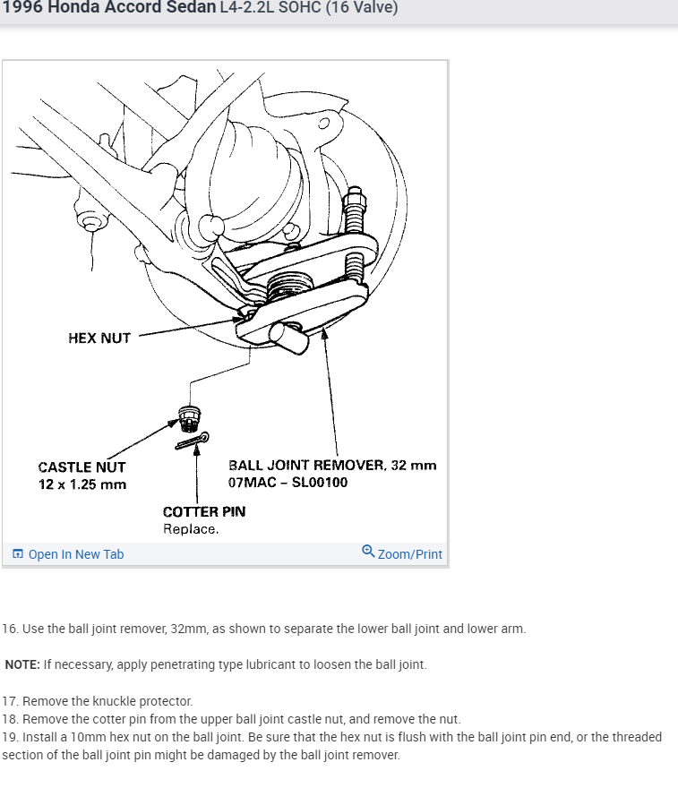

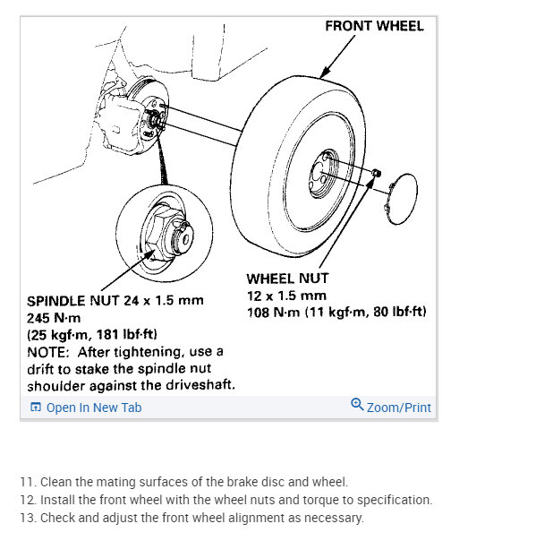

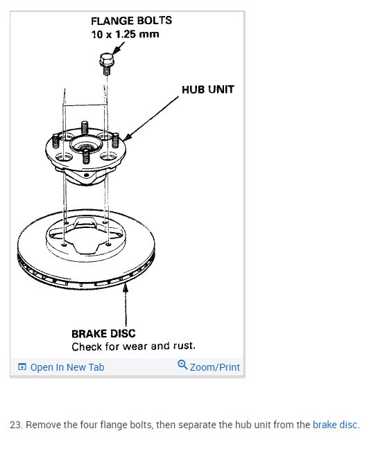

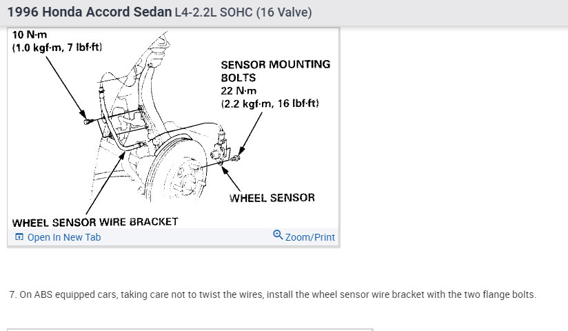

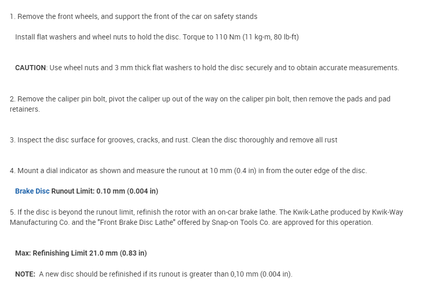

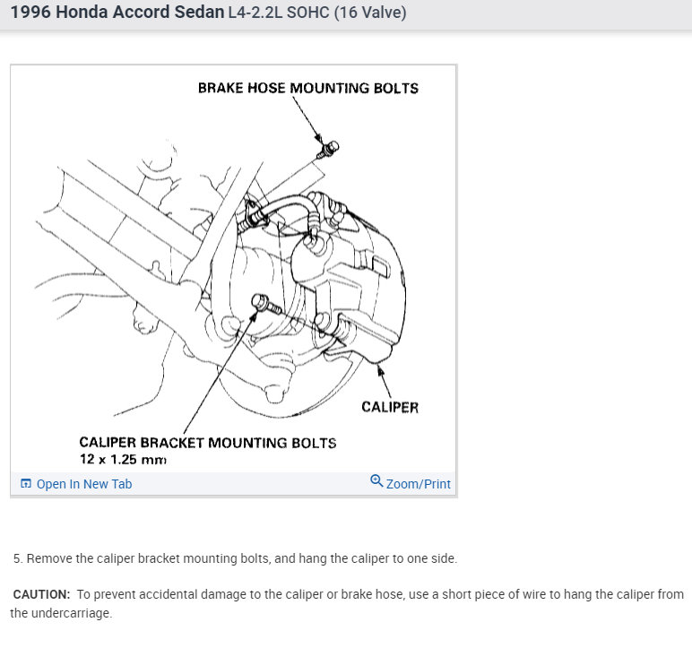

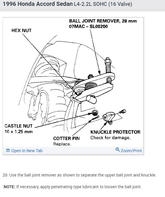

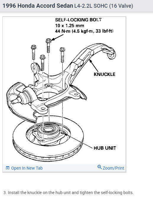

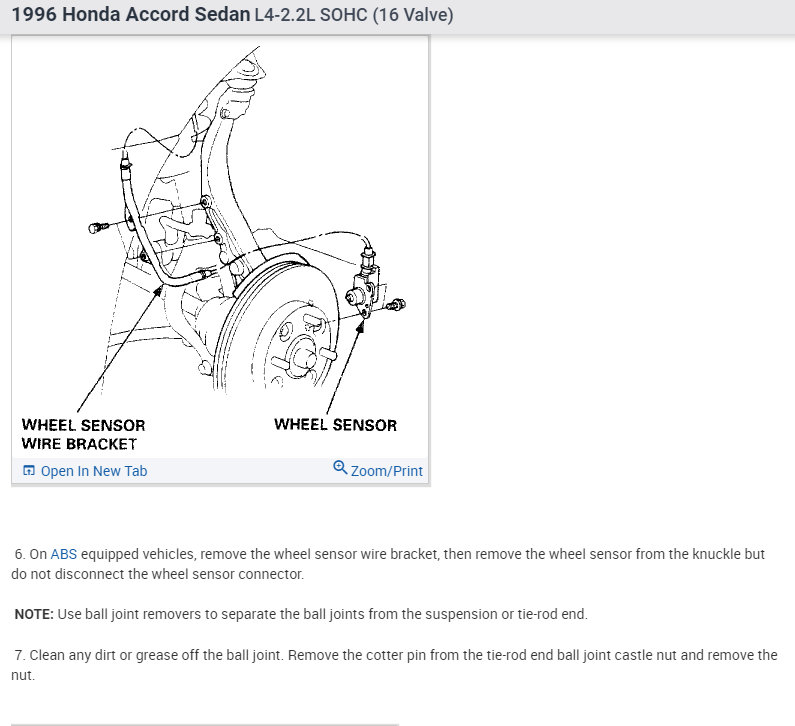

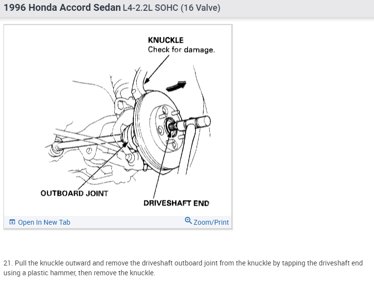

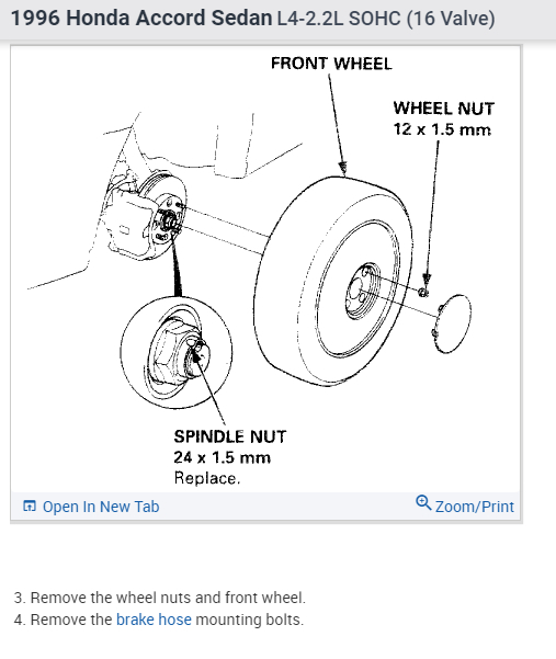

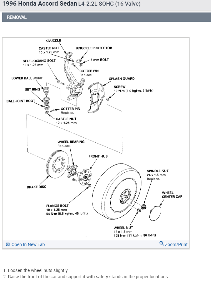

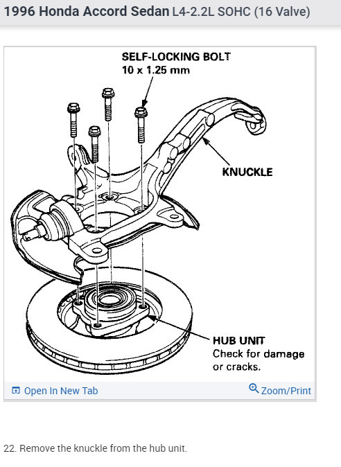

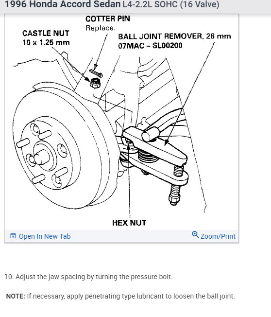

The rotor removal for this vehicle does require few extra steps.
The knuckle needs to be remove in order to replace the rotors.
I have attached the replacement instructions below.
