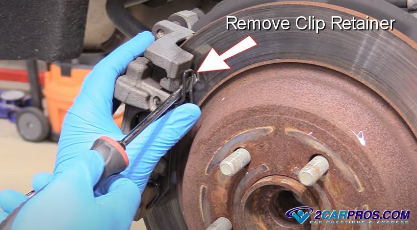

1. To begin, remove the brake caliper by undoing the brake caliper mounting clips and bolts, then rock the caliper back and forth to loosen it from the brake rotor.
remove brake caliper retainer clip

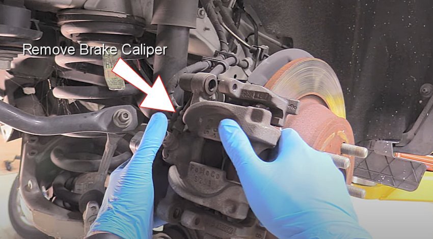

2. Grasp the brake caliper and lift it from the caliper mount and set it off to the side, do not allow the brake caliper to hang from the brake hose, most mechanics will use zip ties to secure the caliper.
lift brake caliper from brake rotor

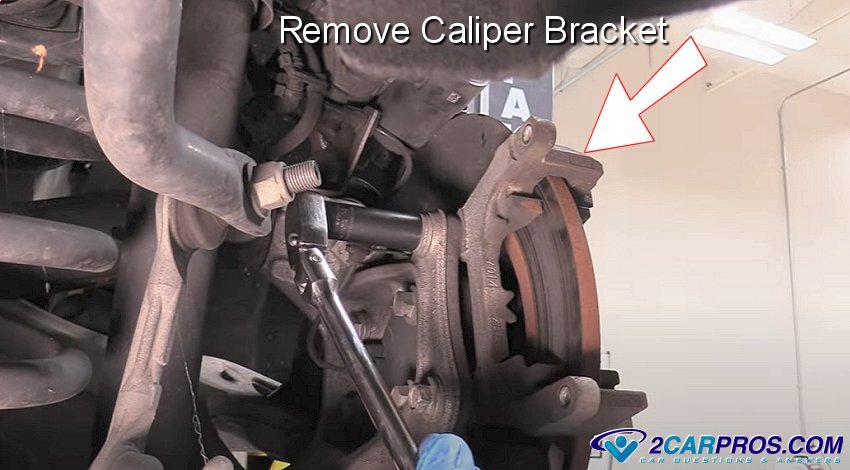

4. On some cars the brake rotor will be able to be removed at the this point, but most will require you to remove the caliper mounting bracket which will be held on by two bolts from behind.
remove brake caliper bracket
