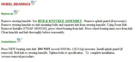

I want to know how to remove the two front brake rotors. I have no problem removing the back two. But the front 2 just dont seem to budge. Can some one PLZ help me!

The front wheel hub and bearing assembly must first be removed to remove the rotors. If you need assistance removing those components just let me know.

:yaa did help: how do u remove the bearing assembly?

http://www.2carpros.com/forum/automotive_pictures/261618_Noname_874.jpg
http://www.2carpros.com/forum/automotive_pictures/261618_Noname2_229.jpg

How can I remove the hub?

The hub and knuckle assembly removal procedures are described in my last post.
