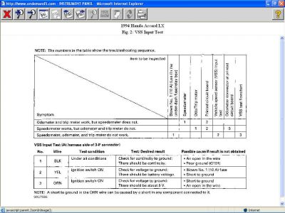

I have a 94 accord lx manual transmission. the speedometer only works about 1/4 of the time when i am driving. I already replaced the VSS with a new one and i have pulled the drive gear for the vss and inspected it and it looks fine. But all of this made no change. I would really appreciate any insight. thank you

Take a gander through this
https://images.2carpros.com/forum/automotive_pictures/10316_94_spe1_1.jpg
Should give you an indicator that since the VSS was replaced that it does not leave much else except the speedometer itself.

Suggested Repair
With the vehicle speed sensor already replaced and the VSS drive gear inspected and found intact, the remaining likely cause is a faulty speedometer. Repair or replace the speedometer.
