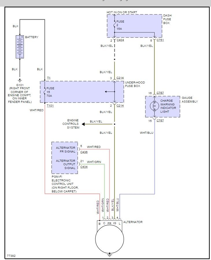

battery fuse keeps blowing when i attempt to connect battery to terminals. What equipment do i need (voltmeter, bulb test) and what should i be looking for?

polarity is correct, no problem with insulation.
I did have brakes, master cylinder and booster replaced by reputable dealer. The next day, the battery was dead. Jumped it and let it run, turned off engine and it started ok but 3 hrs later it was dead again. Replaced battery because i thought it wouldnt hold charge but sounds like it was being drained by a short. I connected the terminals to battery and blew the 80 amp battery fuse (correct polarity). How do I narrow down my search for the short? I do have a 12 tester with red and green light and a new 80 amp fuse.

Hey MEZZYJ,
It looks like you have an alternator that is out, here is a guide and a wiring diagram that can help you get the problem fixed.
https://www.2carpros.com/articles/how-to-replace-an-alternator
Replace the alternator and recheck the problem.
