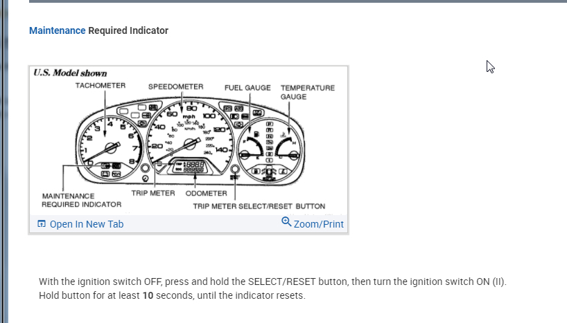

I attached the info from the manual just for all others in case they need it as well.

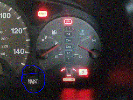

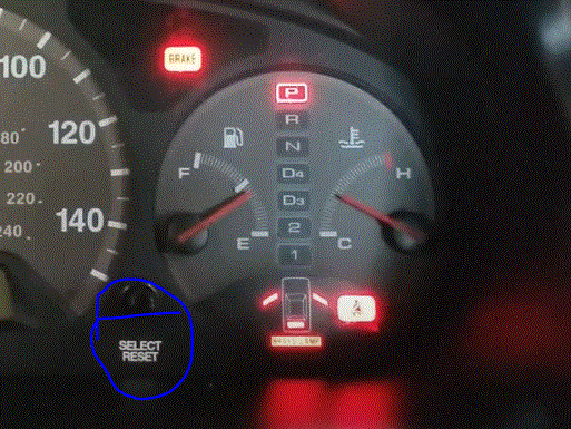

  • 110,037 POSTS
If it is the reset for service (oil change). Do the following:
1) With the key on, press and hold the trip odometer reset button and turn the key off. See pic 1 for location.
2) While still holding the reset button, turn the key on.
3) Hold the button for approximately 10 seconds until you see the maintenance required light begin to flash.
4) Continue holding the button until the maintenance required light turns off.
5) Turn the key off and it should be reset.
Let us know if this helps.
