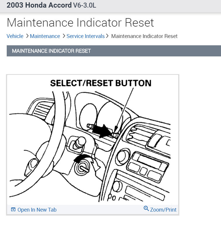

Turn ingition switch to off position, press and hold SELECT/RESET button and turn
ignition switch to ON, continue to hold button for ten seconds or until the light
goes out.

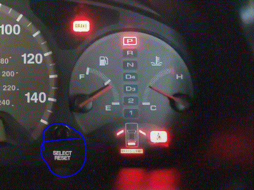

JMALDRICH
[quote:71d092b96b="merlin2021"]Turn ingition switch to off position, press and hold SELECT/RESET button and turn
goes out.[/quote:71d092b96b]
Which "SELECT/RESET" button are you talking about? Is that the "trip odometer" button?

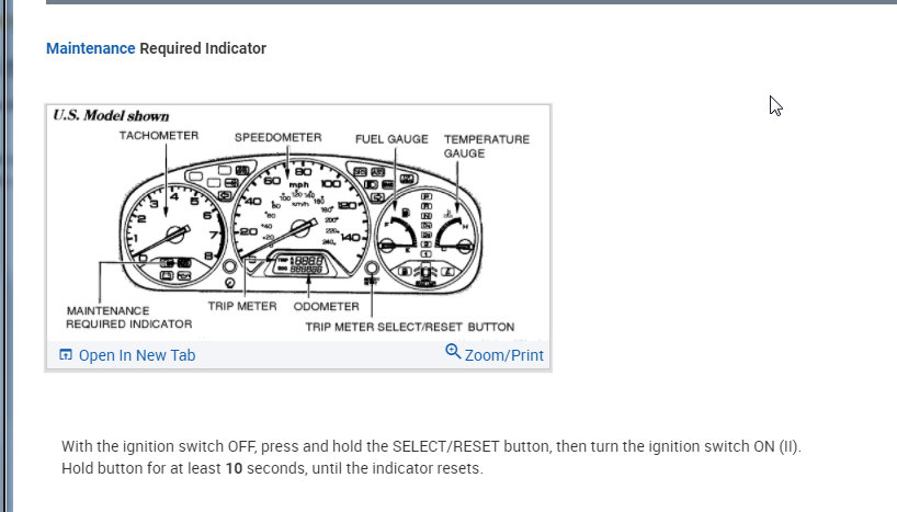

MHPAUTOS
  • 31,937 POSTS
Hi there,
It needs to be reset after the engine oil change here is how. Check out the diagrams (Below). Please let us know if you need anything else to get the problem fixed.

NITERDA
Honda Accord 1998-02, Odyssey 1998, Civic 2002-06, Civic Hybrid & Pilot 2003-06
To reset MAINT REQ'D light; press and hold SELECT/RESET button on the instrument panel. Turn ignition
on and hold until the light goes out.

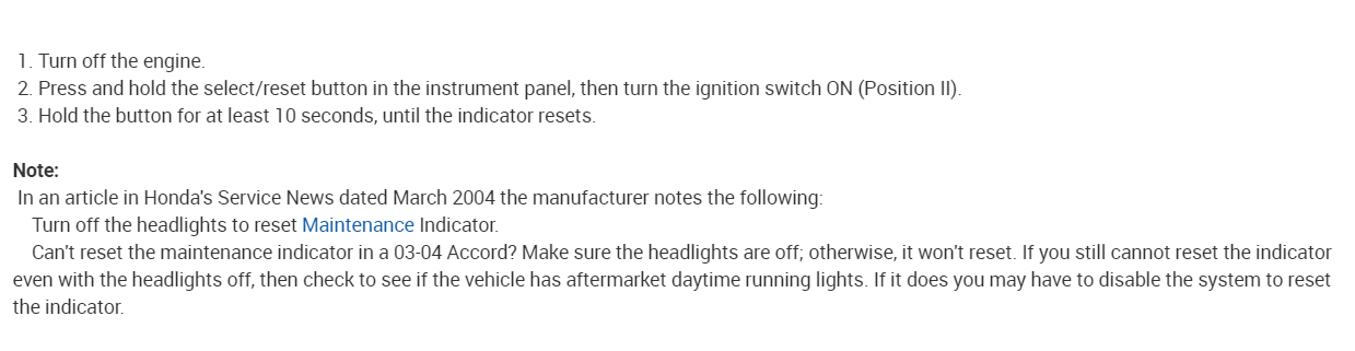

ACCORDRIVER01
just the other morning when i was going about an interview i looked at the gauges on my car and realized that my maintenance required light was on i kept an eye on all the other gauges to make sure that nothing was running hot and went home after i was done. my dad owns his own auto shop and put his dignostic tool on it and couldn't find any codes showing what was wrong. he said it may be like a oil change light so i tried pumping the gas but that didn't work. just wandered if anyone has encountered this problem and had any suggestions.
Aug 25, 2020 at 12:13 PM (Merged)

I attached the info from the manual just for all others in case they need it as well.
Thanks to both of you. Please come back to 2CarPros in the future.

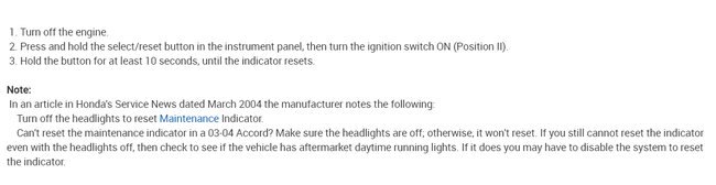

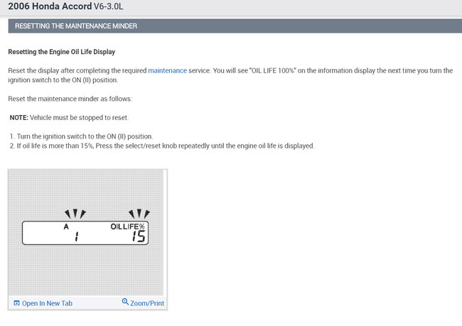

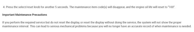

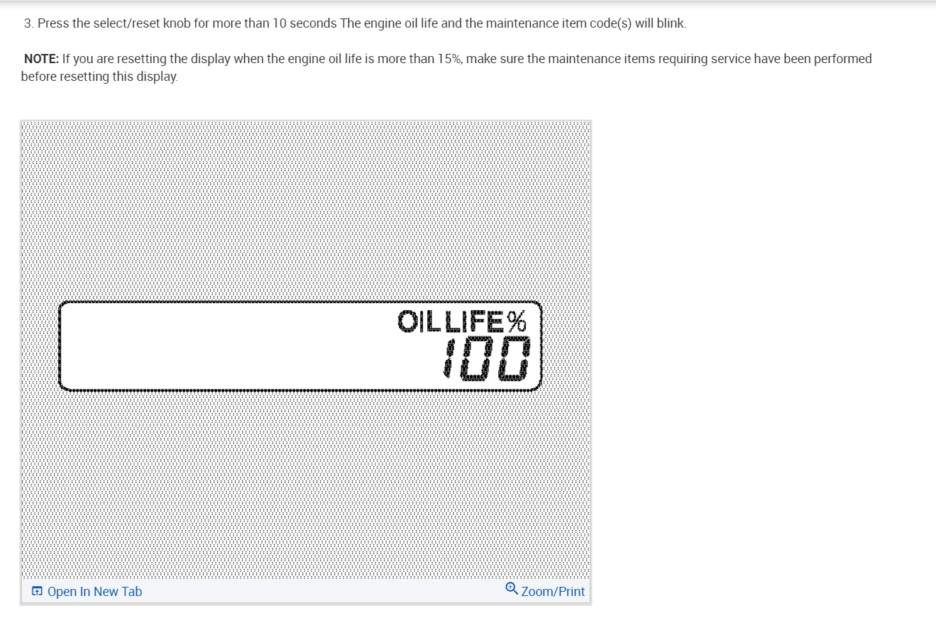

  • 110,244 POSTS
If it is the reset for service (oil change). Do the following:
1) With the key on, press and hold the trip odometer reset button and turn the key off. See pic 1 for location.
2) While still holding the reset button, turn the key on.
3) Hold the button for approximately 10 seconds until you see the maintenance required light begin to flash.
4) Continue holding the button until the maintenance required light turns off.
5) Turn the key off and it should be reset.
Let us know if this helps.
