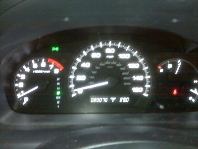

LEORSIY
OK so it looks a little more than 700. I included a picture its a little fuzy the car is moving so.... What are the "side effects" of having the car idle fast besides the car moving. Is it easy to diagnosis if its a vacumn leakages or a stuck Idle Air Control valve? Thanks Again for all your help

KHLOW2008
  • 41,814 POSTS
You can try resetting the PCM/ECM and perform the idling relearn procedure.
1. Make sure all electrical items (A/C, audio, rear window defogger, lights, etc.) are off.
2. Reset the ECM/PCM with the HDS.
3. Turn the ignition switch ON (II), and wait 2 seconds.
4. Start the engine. Hold the engine speed at 3,000 rpm without load (in Park or neutral) until the radiator fan comes on, or until the engine coolant temperature reaches 194°F (90°C).
5. Let the engine idle for about 5 minutes with the throttle fully closed.
NOTE: If the radiator fan comes on, do not include its running time in the 5 minutes.
