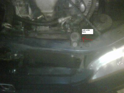

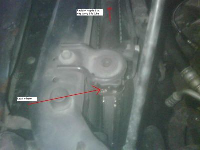

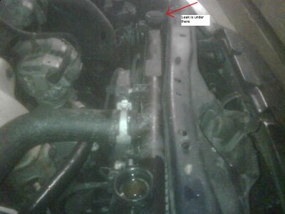

MARKDUBI
My car runs out of water in the radiator, and starts to overheat almost weekly. Today, I think I found the leak, I took pictures from my camera phone (low quality). I could get some better pics if needed. The caption on the first pic says "Leak under there" where the arrow is pointing. On the 2nd pick, "Leak under there" , on the 3rd pic, the leak is where the big arrow is pointing, and the arrow at the top is just pointing out the location of the radiator cap.
https://images.2carpros.com/forum/automotive_pictures/386187_top_view_1.jpg
https://images.2carpros.com/forum/automotive_pictures/386187_from_right_side_view_1.jpg
https://images.2carpros.com/forum/automotive_pictures/386187_close_up_1.jpg

KHLOW2008
  • 41,814 POSTS
Hi markdubi,
The radiator top tank is bad causing the leaks. This often happens when coolant level drops and instead of coolant, steam which has a higher temperature than boiling coolant is moving around in the radiator. This would cause the tank to burst over time.
You need to get a new radiator unless you are able to get a replacement top tank.
After replacement of the radiator, pressure test the syatem for possible leaks at other area in the system.

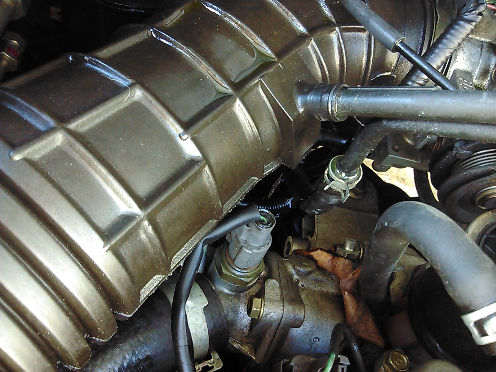

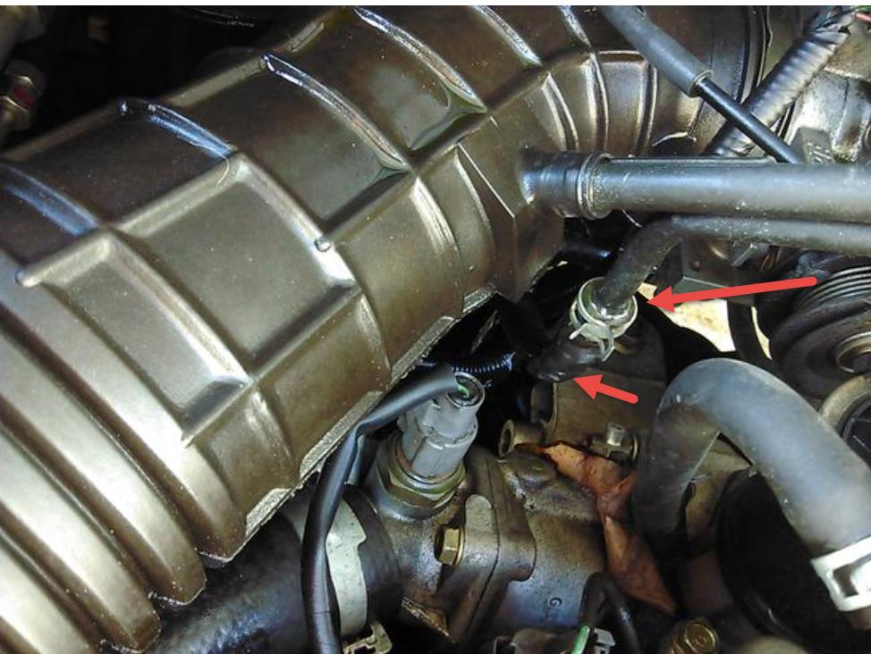

CLARKBEAR
My car seems to be leaking antifreeze from some where in the back of the engine. I've been trying to find proper diagram pictures that would pinpoint which of the hoses is causing the problem. I took a picture of where I suspect the leak is. It's right around the EVAP two way valve.
Jan 2, 2020 at 8:12 PM (Merged)
HMAC300
  • 48,601 POSTS
from your pic it looks like the one pointed to with the arrow check all of yoru hoses however for being soft as they will leak if soft soon.
