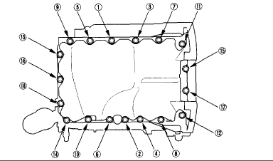

I need instructions on changing the oil pan on a 2004 Honda Accord 6 cylinder.

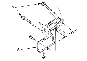

Remove the torque converter cover (A) and the two bolts (B) securing the transmission. Remove the bolts securing the oil pan.

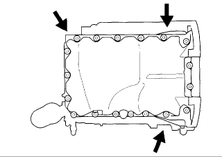

Using a flat blade screwdriver, separate the oil pan from the block in the places shown. Remove the oil pan. Oil Pan Installation Remove all of the old liquid gasket from the oil pan mating surfaces, bolts, and bolt holes. Clean and dry the oil pan mating surfaces.

Tighten the bolts in two or three steps. In the final step, tighten all bolts, in sequence, to 12 Nm (1.2 kgf-m, 8.7 ft. lbs.) . NOTE: After assembly, wait at least 30 minutes before filling the engine with oil.
https://images.2carpros.com/forum/automotive_pictures/12900_o5_1.gif
Tighten the two bolts (A) securing the transmission, then install the torque converter cover (B). If the engine is still in the vehicle, do the following steps. Install exhaust pipe A using new gaskets and new self-locking nuts. Install the splash shield. Refill the engine with oil. Lower the vehicle on the hoist. https://www.2carpros.com/kpages/auto_repair_manuals_alldata.htm
