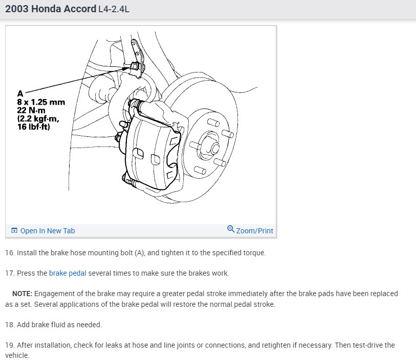

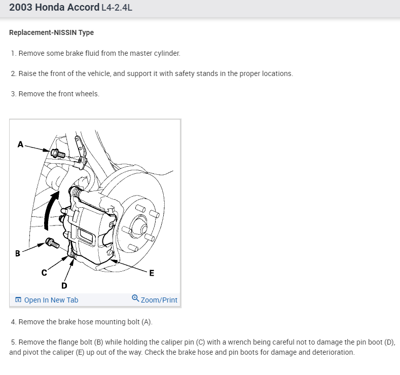

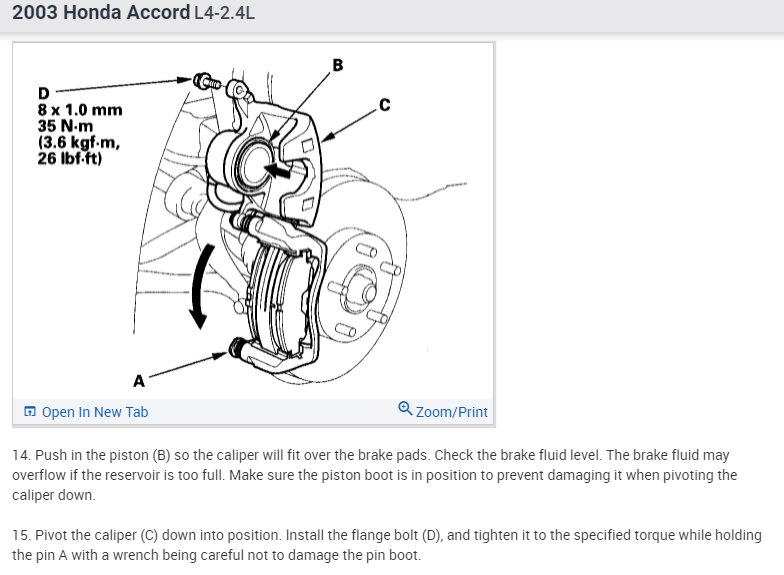

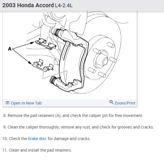

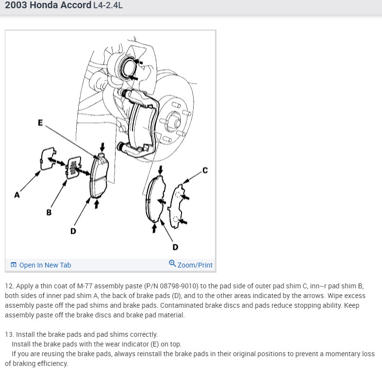

Are the front rotors removable by hand or pressed on?
PATALBO
  • 2003 HONDA ACCORD
  • 4 CYL
  • FWD
  • 100,000 MILES
Friday, December 5th, 2008 AT 2:35 PM
SQM
  • 6,383 POSTS

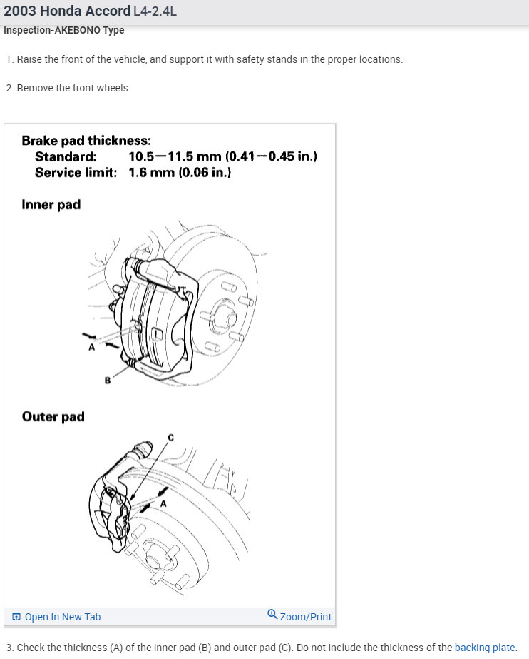

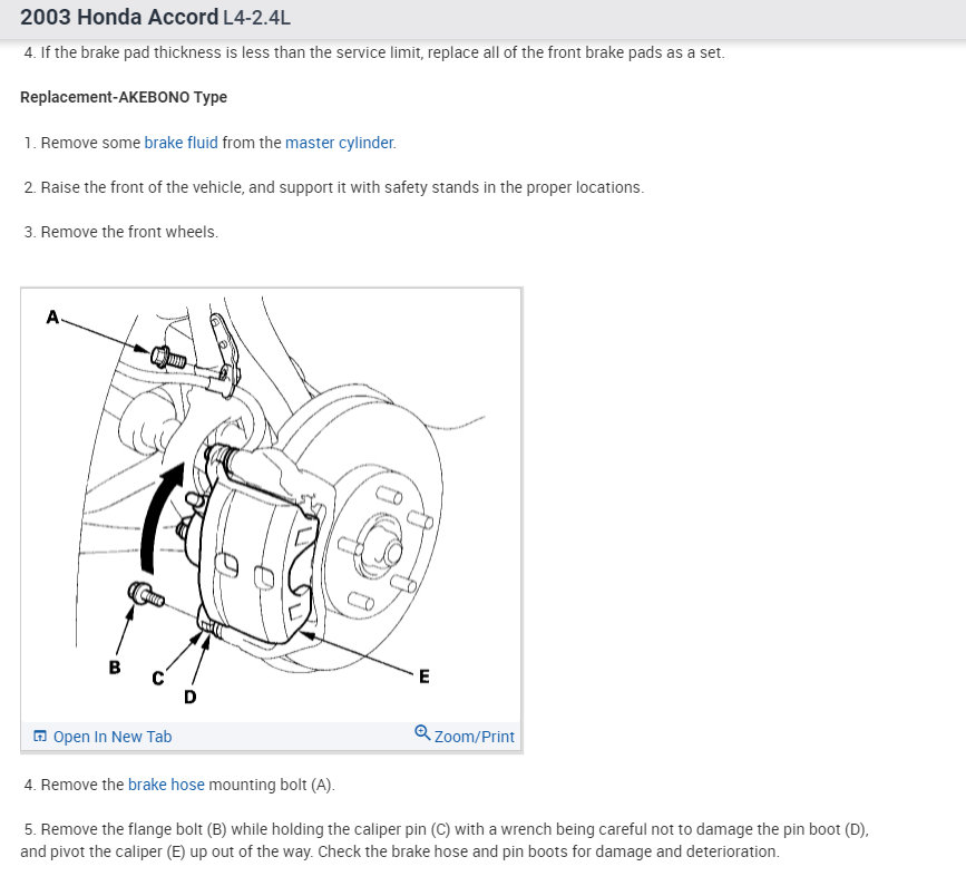

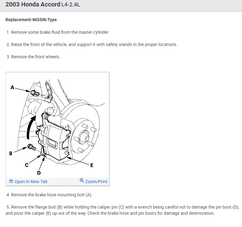

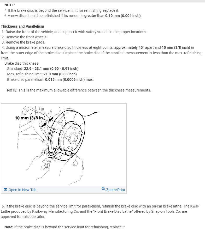

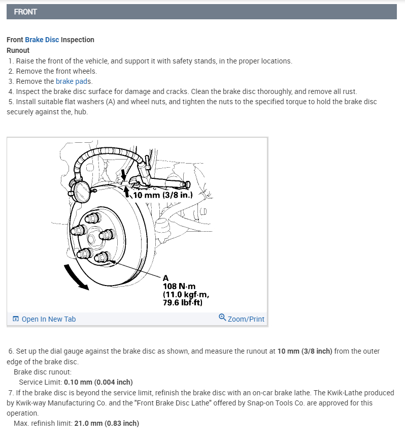

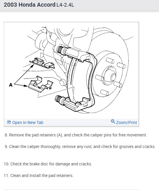

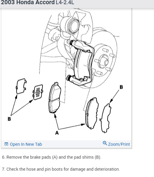

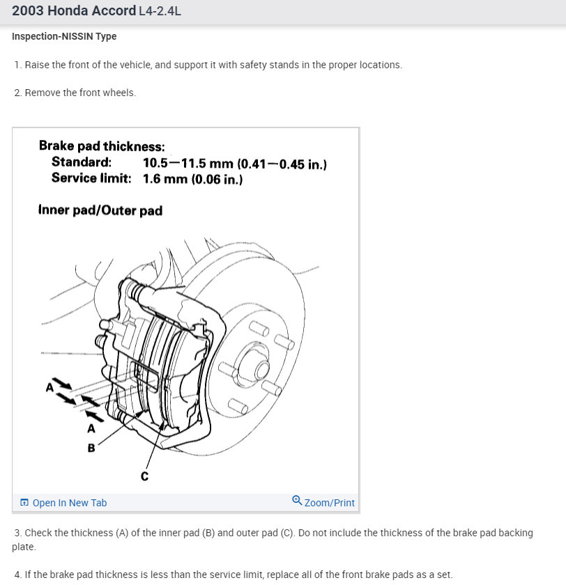

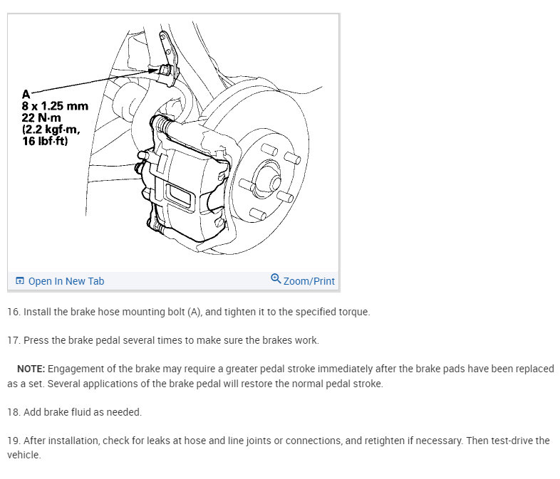

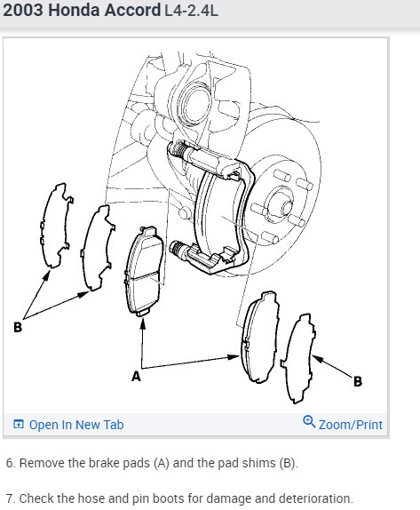

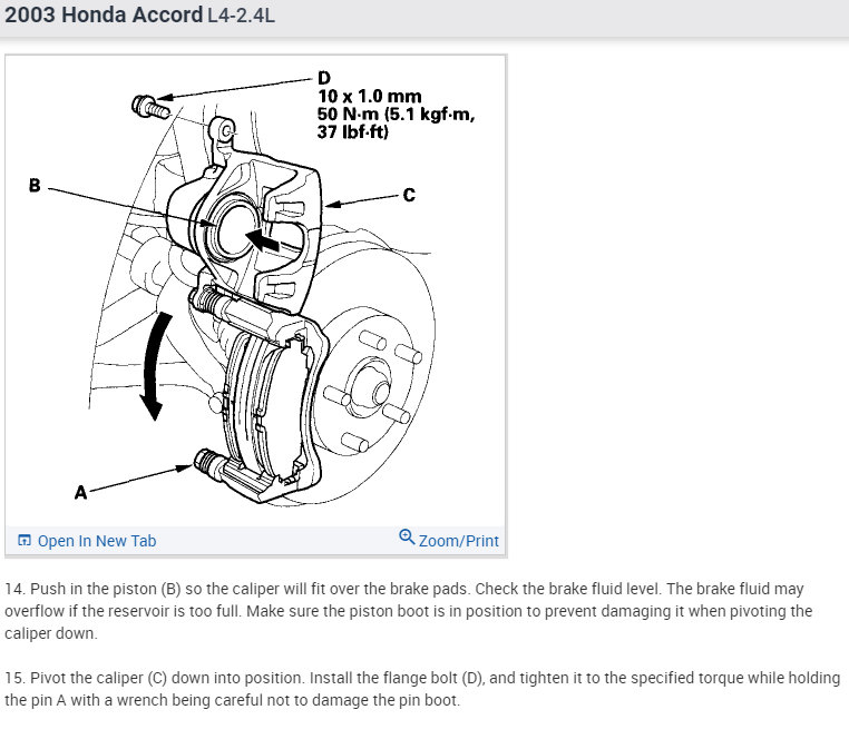

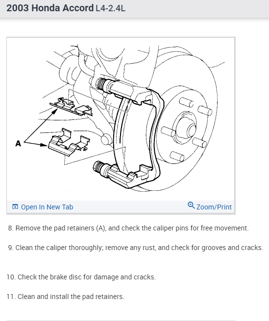

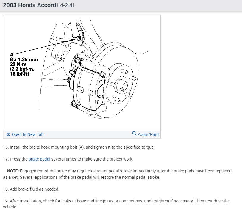

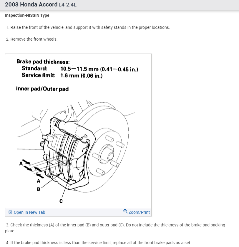

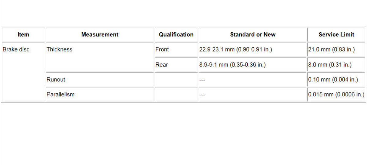

After you remove the caliper and the bracket. You will have to remove those two screws at the center hub of the rotor. Then it will come out. It is not a pressed-on rotor.
After removal of the screws, you might have to use a hammer or mallet to tap on the rotor to break it loose from the hub.
Here is a helpful guide:
