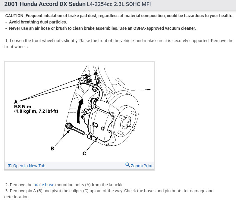

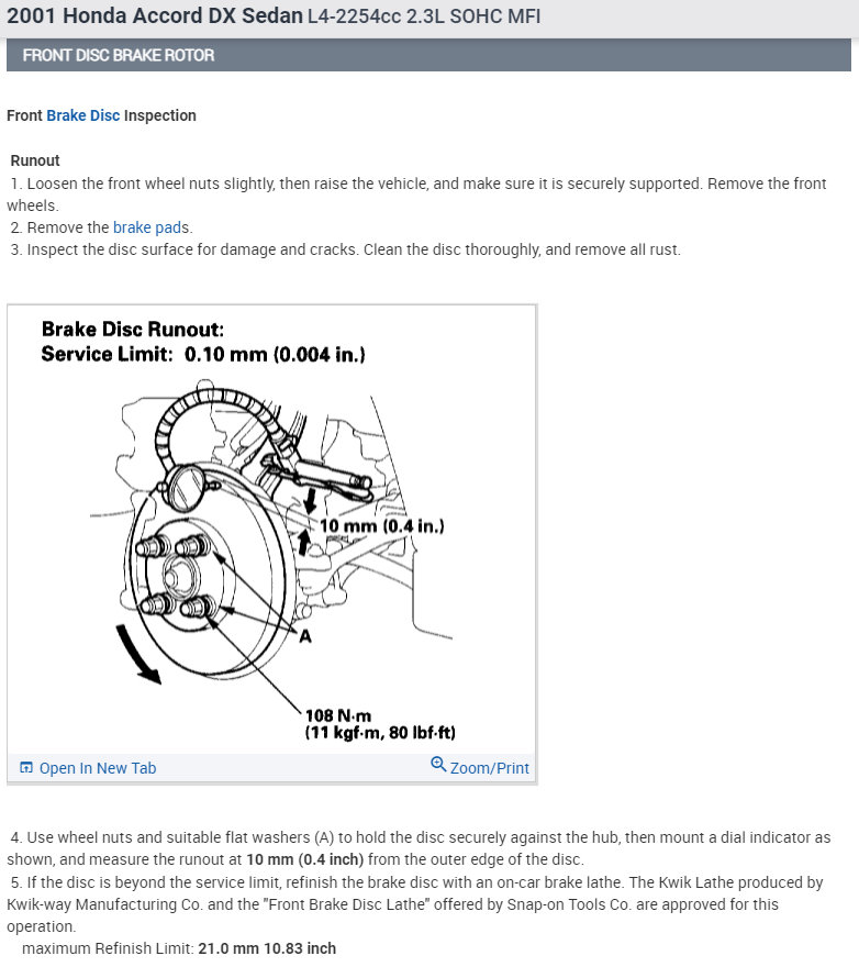

It is not required to have those screws. They are primality there to keep the rotor in place during assembly process.
So, it can be installed as is.
