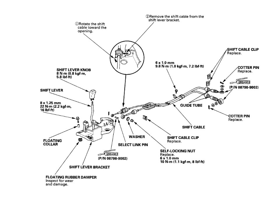

MICHAEL SHAW2
Okay, so I know for sure one cable snapped. so I removed both cables and put in new ones, but the shifter won’t go past first or second gear. When in first or second gear it’s in neither gear like the car will move but it seems to be third gear in first and maybe fifth in second not to sure.

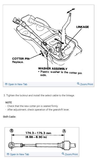

Sep 26, 2020 at 5:07 AM (Merged)
  • 55,381 POSTS
It sounds like you got the shifter cables mixed up. here is how to correctly replace them. Check out the diagrams (below). Please let us know what you find. We are interested to see what it is.

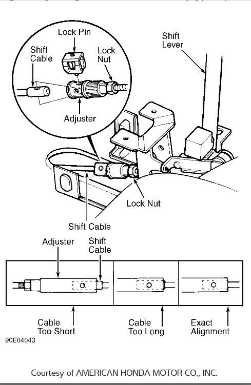

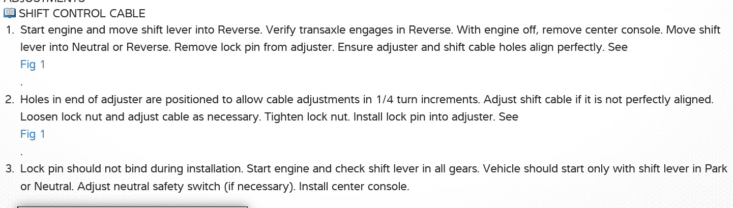

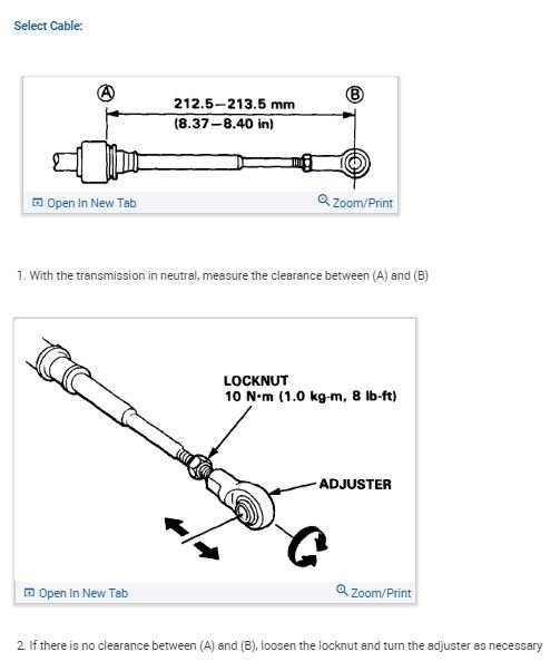

SHELLY-ANN SEIGNORET
I need to move shifter to first position to move on first gear and second position to move on second gear. If I leave shifter on drive four it will move on fourth gear.
Sep 26, 2020 at 5:08 AM (Merged)

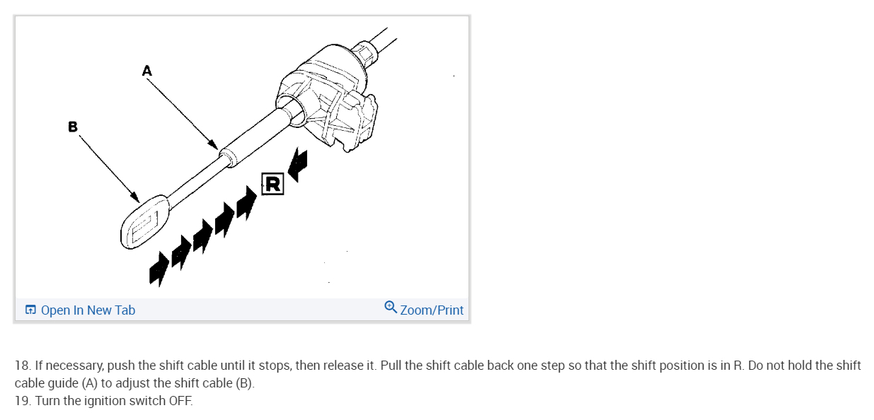

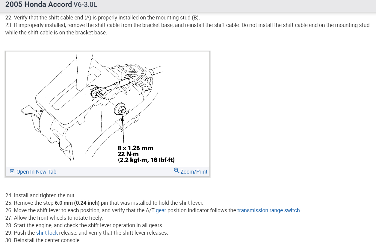

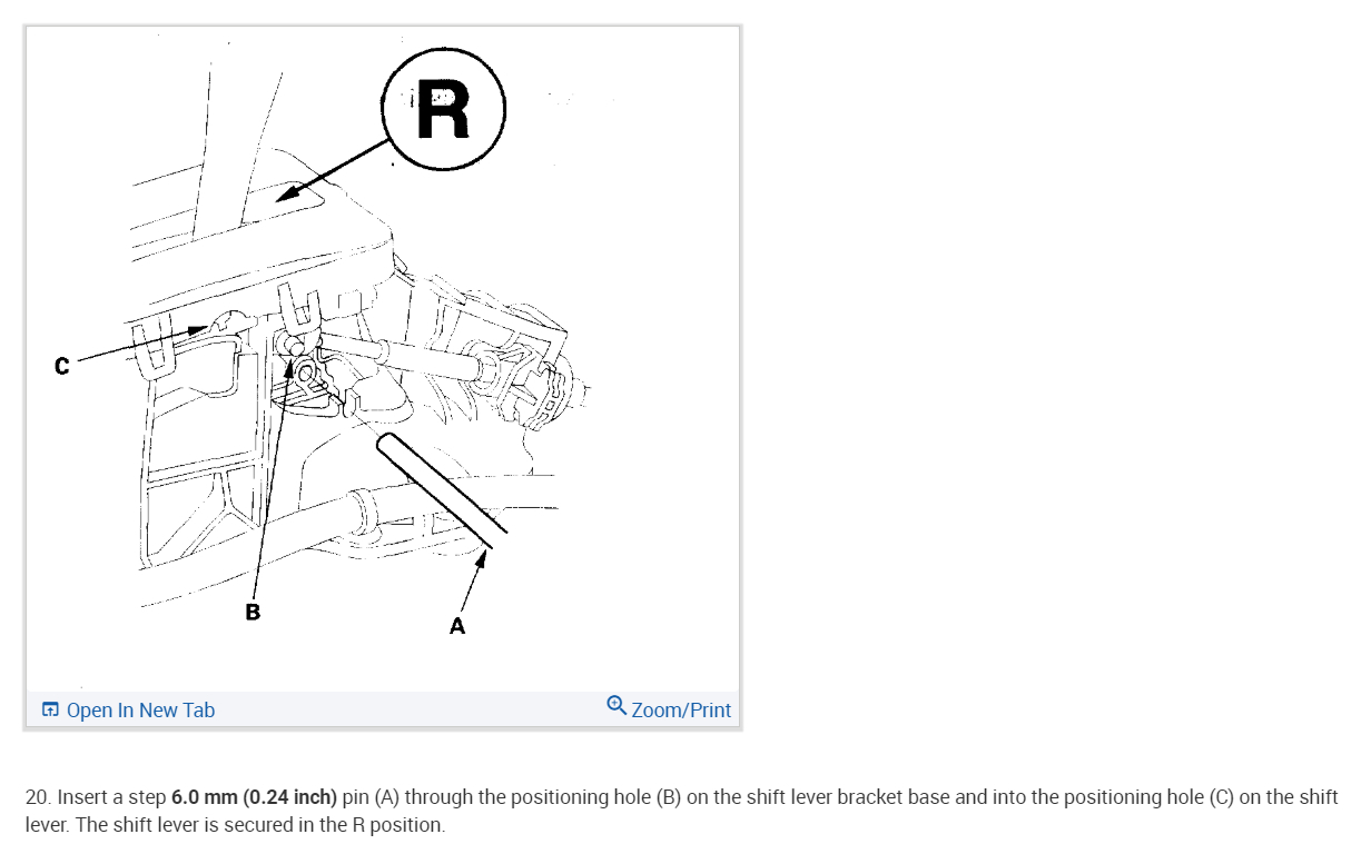

HMAC300
  • 48,601 POSTS
check for a broken or worn out shift cable . It may be out of adjustment as well. See pictures for adjustments.

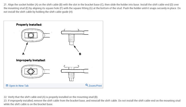

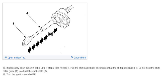

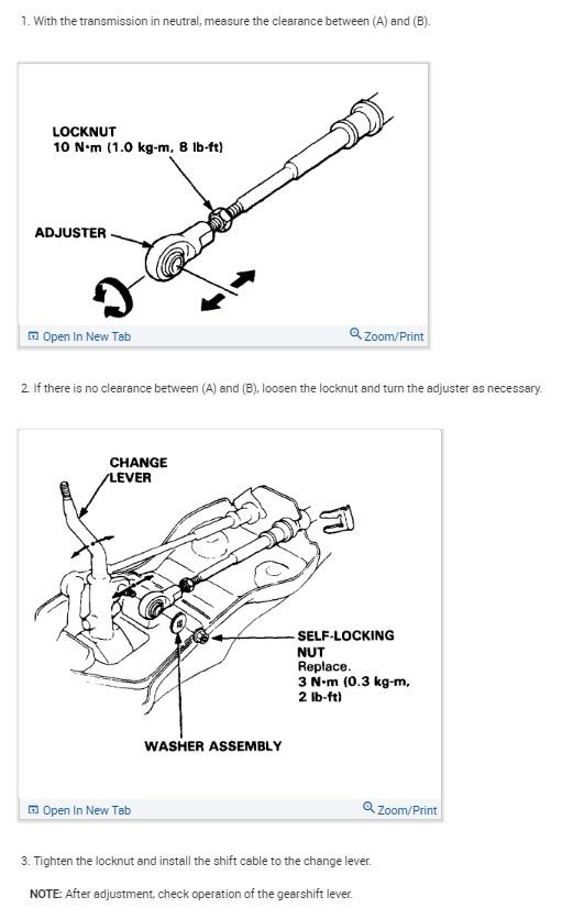

CHRISBOBB

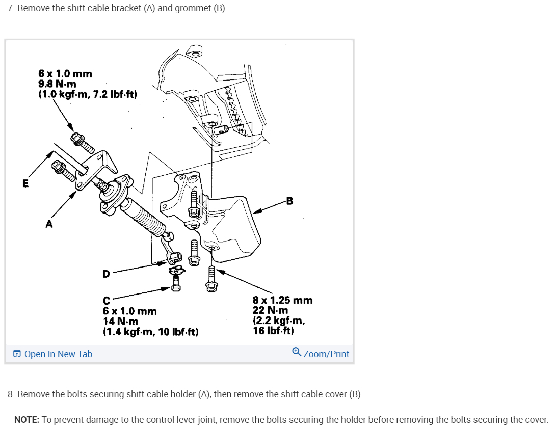

The car will not shift into 1st,3rd or 5th gear. upon inspection, it was found that the right side shift cable is broken. How tough a repair is this and can i find the part.
Sep 26, 2020 at 5:09 AM (Merged)
KHLOW2008
  • 41,814 POSTS
Hi chrisbobb,
Getting the part should not be a problem.

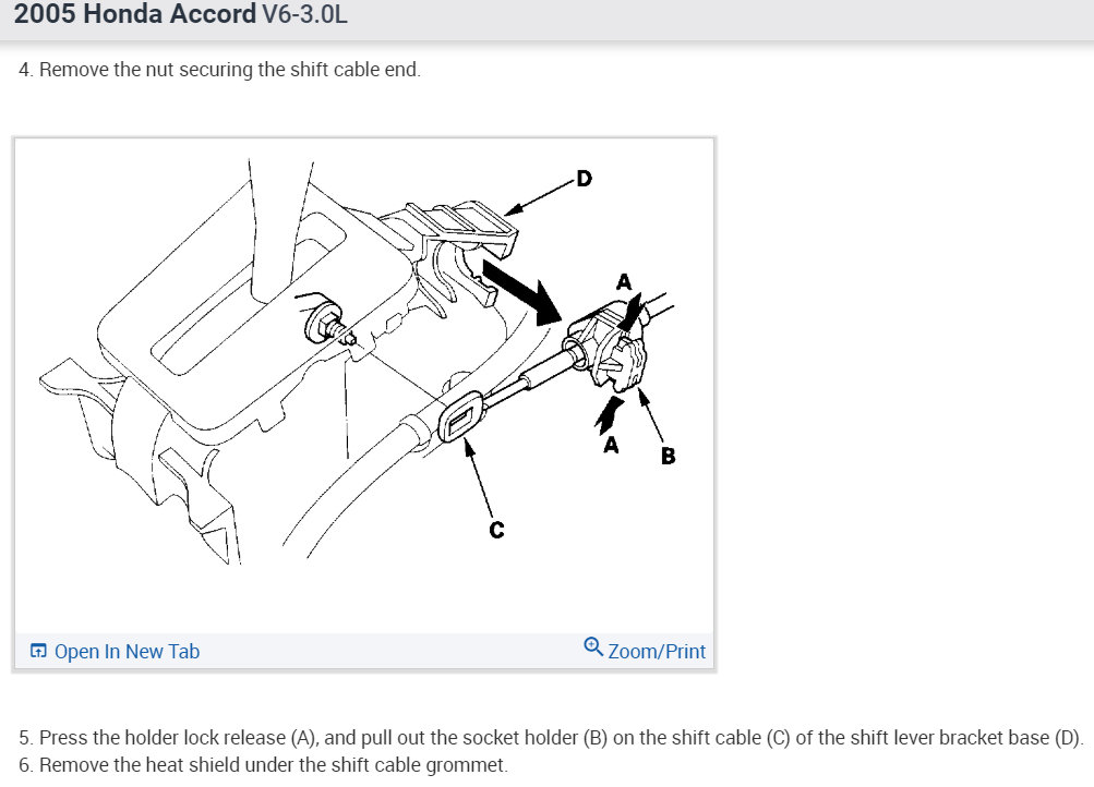

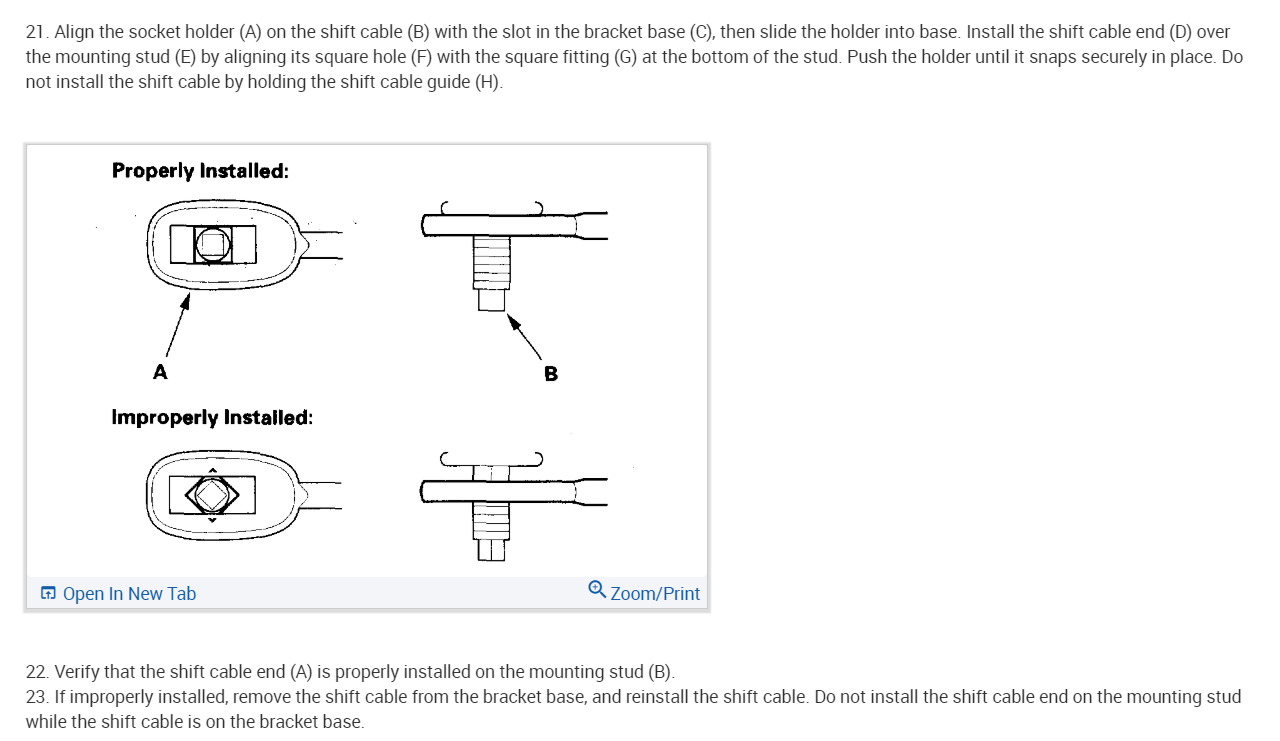

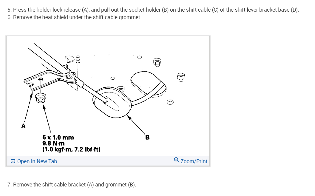

I couldn't find any specific replacement instructions in the manual, I did however find how to adjust them. This will show how they attach to the shifter and how to adjust once replaced
See the diagrams below

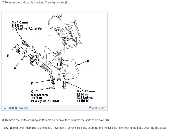

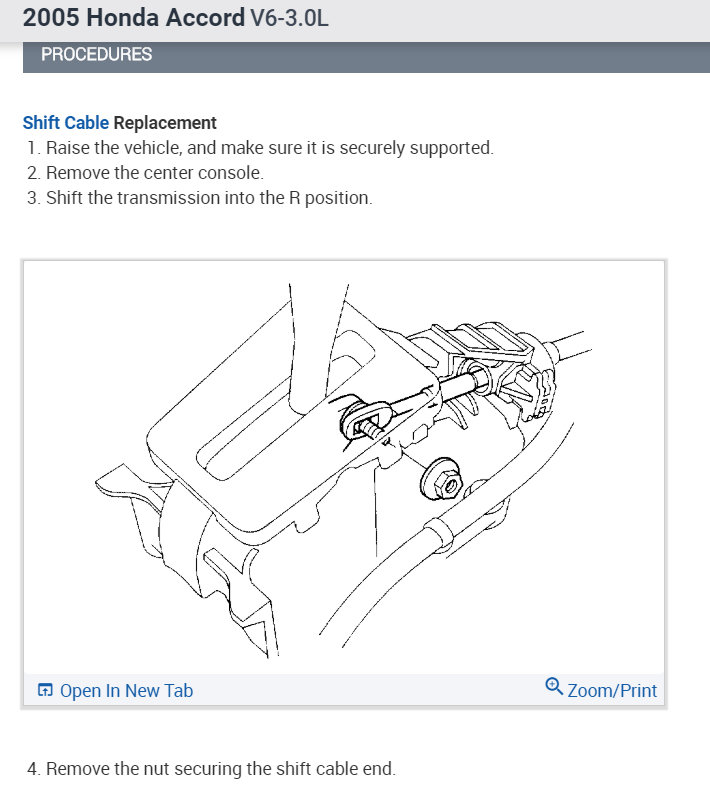

CORINTHEA13
How do you replace the shifter cable?
KHLOW2008
  • 41,814 POSTS
Hi corinthea13,
You need to remove the central console box.
Remove the locking pin connecting the cable to the gear shift.
At lower end of vehicle, remove the front exhaust heat shield to get access to the cable mountiing poit to body. Remove 2 pcs of 10mm hex bolt.
At trans side, remove cable holding clamp and dust cover.
Remove 10mm hex bolt after unlocking tab.
Remove cable and proceed with replacement.
DO NOT bend end of cable, if not shifting from Park to Reverse would be very stiff.
Before installing of locking at gearshift, ensure locking holes are in alignment, failing which gearshift would be out of position.

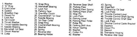

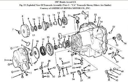

DANNYBOY63
  • 6 POSTS
i put in a new shifter cable and when i first drive my car and put it into park i get a loud grinding sound but after that everything is fine just happens when you first put it into park.
KHLOW2008
  • 41,814 POSTS
Hi dannyboy63,
Did this happen prior to replacing the cable?
Was the cable adjusted correctly.
If vehicle is not at complete stop, a grinding noise would be emitted when shifted into park.
DANNYBOY63
  • 6 POSTS
as a matter of fact it started happying after i replaced it because when i got the car when i was putting it in park felt like reverse because still wanted to roll thats why i replaced it does it mean it has to be adjusted.
KHLOW2008
  • 41,814 POSTS
The problem seems to be from the trans rather than the cable. When stationary, the parking pawls should be at a stop. If it is turning, it would cause rachetting noise when trying to engage. This is usually caused by a faulty 1 way clutch/parking gear. Gear assy is located at end of trans and if you are able to remove the cover, you can check if the lock nuts ( item # 7 and 17 ) are loose, which often happens, and retighten to rectify.
https://images.2carpros.com/forum/automotive_pictures/192750_TransView87Accord02_1.jpg
https://images.2carpros.com/forum/automotive_pictures/192750_TransView87Accord02a_1.jpg
