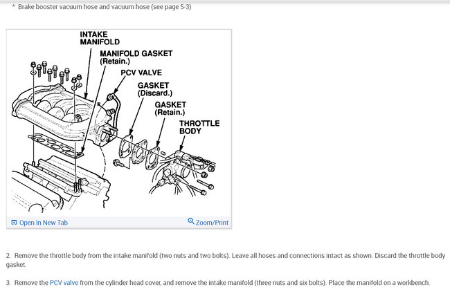

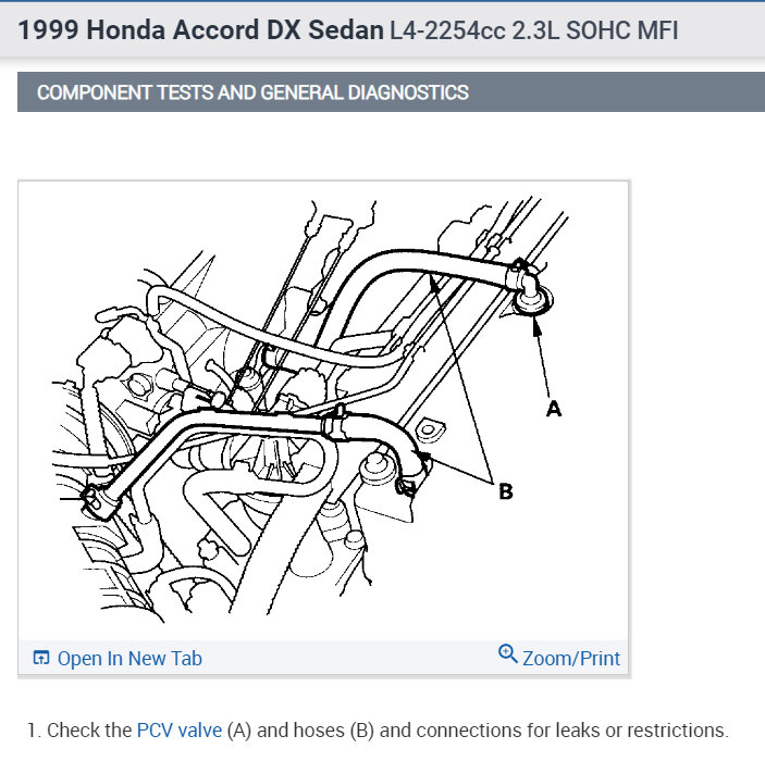

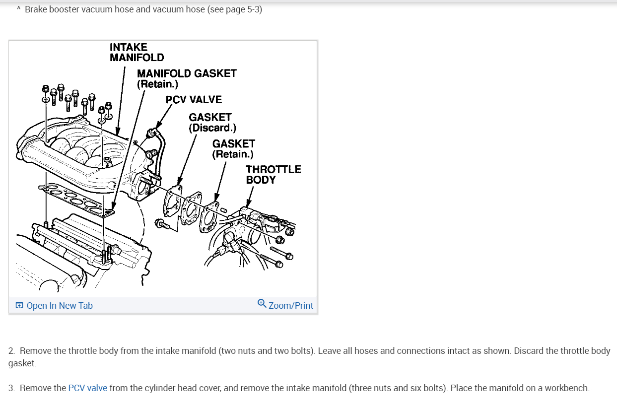

it sounds like you could have a stuck PCV which can suck oil in at highway speeds. Here is the location so you can check it out. Check out the images (Below). Please let us know how it goes
