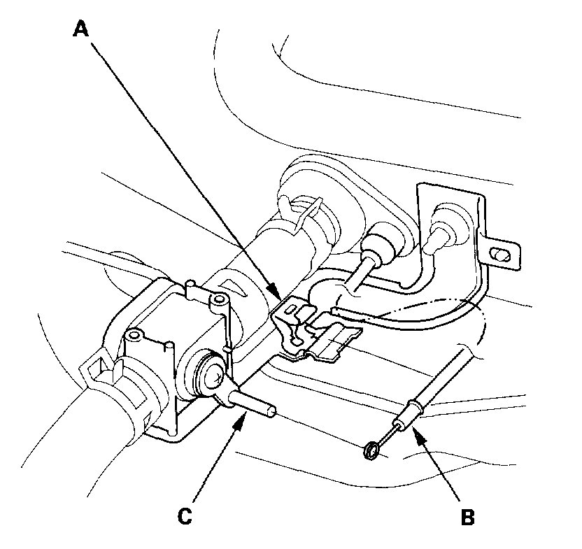

JUNE4YOU
  • 1999 HONDA ACCORD
  • 225,000 MILES
Will not blow hot air.
Wednesday, December 30th, 2020 AT 11:15 AM (Merged)
  • 109,885 POSTS
Hi and thanks for using 2carpros.com.
There are only a few things that can cause this, low coolant, plugged heater core, or a bad blend air door actuator. Take a look through this link:
Now, if the coolant level is full, start the engine and turn the heater on high. Wait until the engine reaches operating temperature and turn the engine off. Next, there are two heater core hoses that you will see attached at the firewall under the hood. Feel both. They both should be hot. If they are, suspect a problem with the blend air door. If only one is hot, suspect that heater core is plugged or the heater control valve isn't working. I attached a picture of the control valve to help identify it.
The valve is located under the hood at the fire wall and will be attached to one of the heater hoses. Have a helper change the temperature controller in the vehicle while you watch to see if the control valve is moving. If it isn't, then either there is a cable problem or the valve is corroded or rusted shut.
Do these things and let me know the results so I can direct you to a fix.

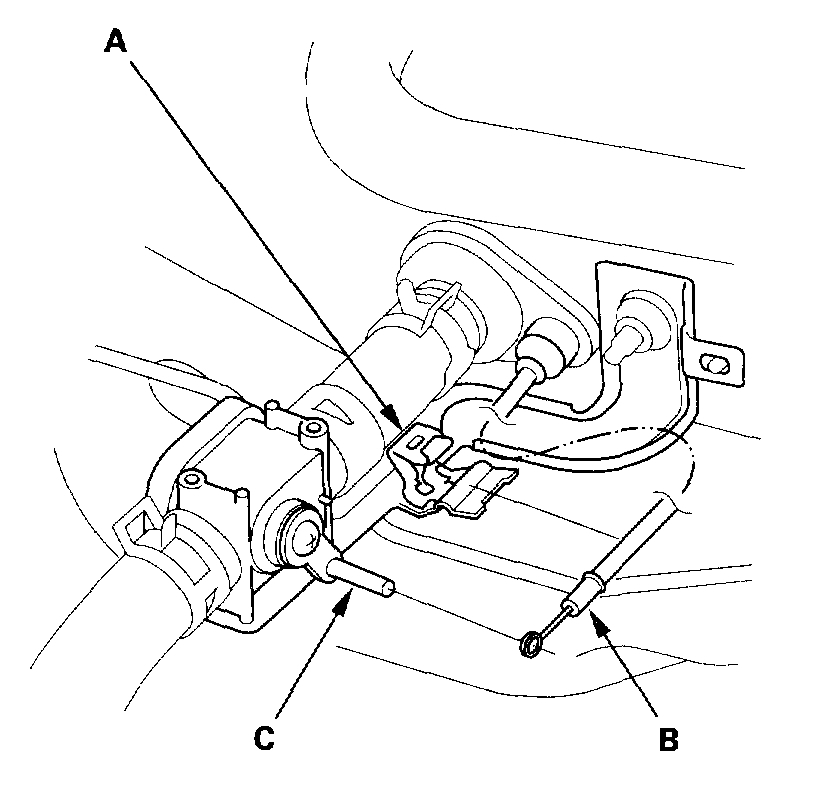

JEMINTUN
  • 1997 HONDA ACCORD
  • 4 CYL
  • FWD
  • 197,500 MILES
My heater is not blowing hot air. It will convert the temp if it is not colder than about 50degreees out to warmer air but does not blow hot. A few years ago, I found that the temperature control was broken. The actual cable. I can turn the knob from hot to cold, but not from cold to hot. I can reach under the dash, and manually push the lever to warm. However, It still does not blow hot. I know the cable is broken one way. But it seems there must be another problem going on as well. Otherwise, it should be blowing hot when I manually push the lever as far as it will go. My mechanic said it was the hvac control mode motor. I have looked that up and there doens't seem to be such a part. I have recently moved from Phoenix to Omaha.I'm going to need all the heat I can get!
KHLOW2008
  • 41,814 POSTS
Hi jemintun,
Seems the cable has been dislodged or improperly adjusted. Check if the cable housinng is seated properly on the clip.
Check if the heater hoses from engine to heater core is clogged or might have been disconnected.
