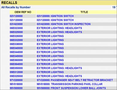

Hello. Also, it looks like you may have some recalls on your vehicle. The dealer may fix these for free. Please contact the dealer service department, give them the VIN number of your car and have them check on these to see if they apply to you.
https://images.2carpros.com/forum/automotive_pictures/248015_Recalls_37.jpg

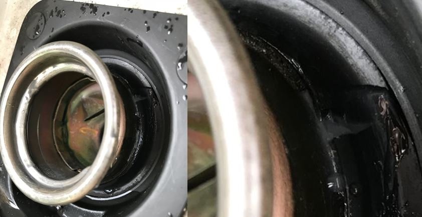

My 1998 Accord LX four cylinder automatic is giving a P1456 EVAP Emission leak detected (fuel tank leak) error. I have cleared the engine light more than once but it comes back after a few days or a week. I have noticed a dip in car mileage.
I found that behind my gas cap, a gasket appears at the top of the filler tube. It appears to have a split. Could that be causing the problem?

To test the theory that the leak is where I suspect it is located, I applied some caulk to try to patch the leak. I will drive it this way for a few weeks to see if the engine light and P1456 come back.
Jun 23, 2018 at 11:33 AM
  • 54,859 POSTS
Sorry, that might not change anything because that really does not seal anything the tube travels below that. I have seen the charcoal canister leak on these cars. Here is a diagram so you can remove it and test is for leaks also check the hoses from it to the tank and the purge solenoid. Check the seal on the gas cap as well.

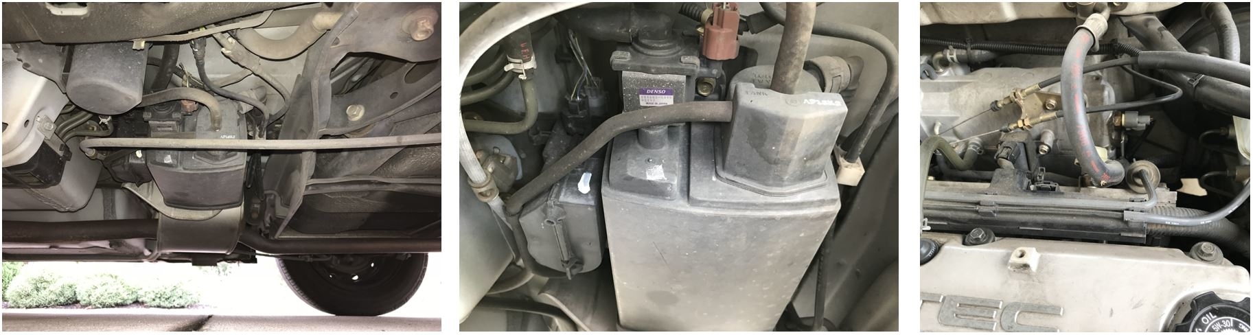

I had some difficulty locating the charcoal canister, but did find that it is underneath the car body, below the rear seat on the driver’s side. I believe the canister part number is 17011-S84-A00. I have attached photos corresponding to the diagrams provided.
How would I test the canister for leaks? Do I need some particular type of tool?
How would I test the hoses from the canister to the tank and from the canister to the purge solenoid?

You will need to rig something to plug hose ports and something to blow a little pressure into it while holding it under water much like a balloon. Also, check all hoses for the system here is a diagram so you can see which ones to look at. Check out the diagrams (below). Please let us know what happens.

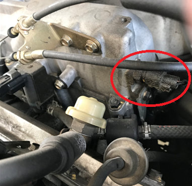

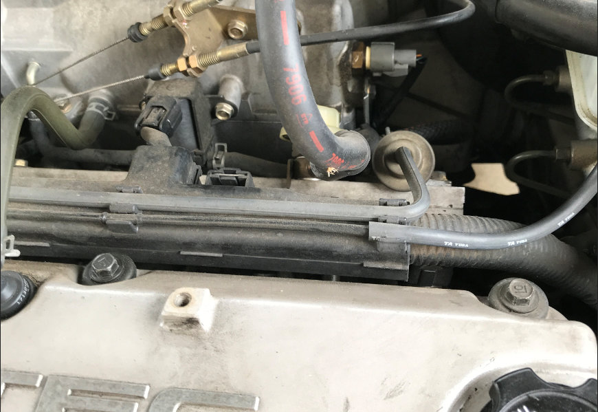

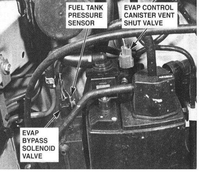

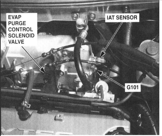

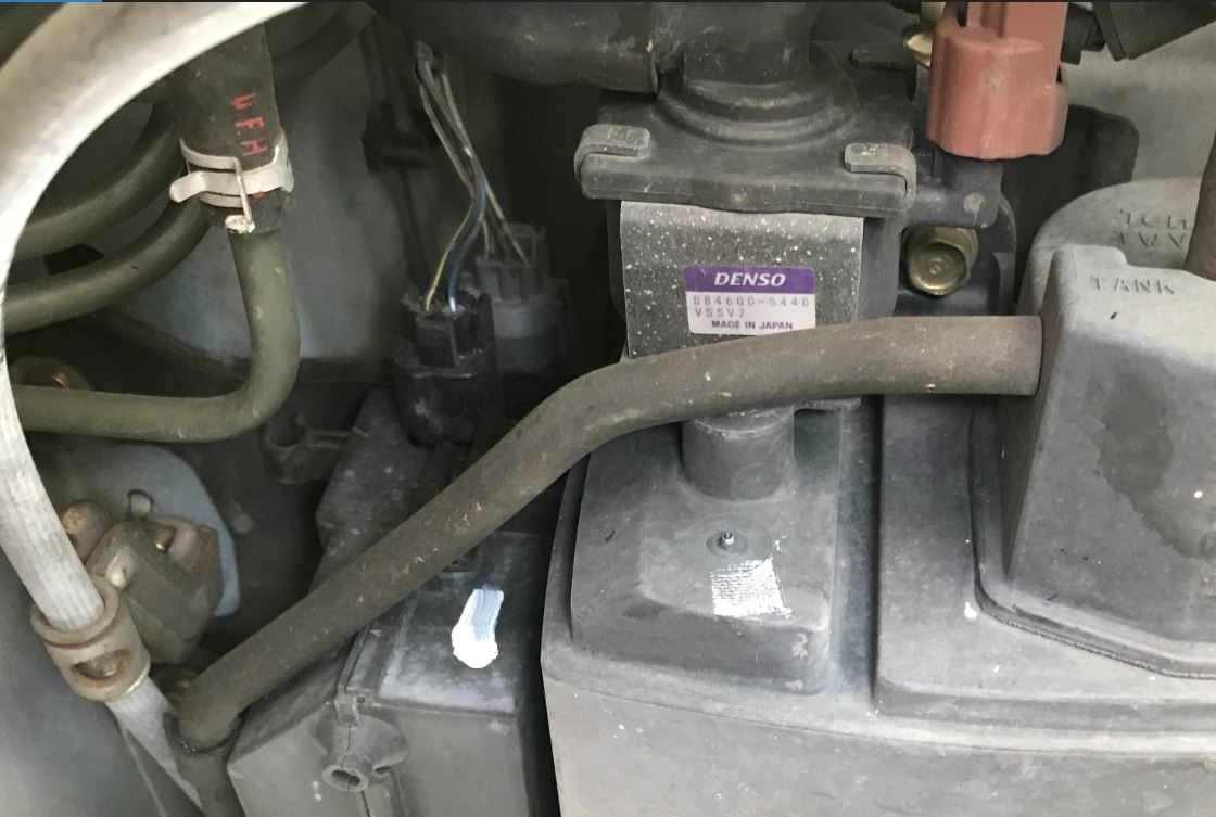

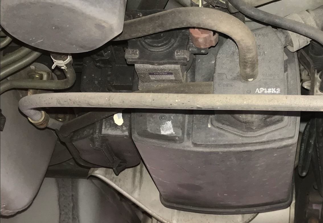

I also found that one of my pictures shows evidence of a leak near the "EVAP bypass solenoid valve". See the first attached image, dark area left of center.
But another picture (second image) taken at a later time seems to not show any evidence of a leak. I am wondering if maybe I had fuel present in the first picture that evaporated by the time I took the second one or it could have been wet dirt from driving in the rain, but why just in that area? This may not help, but does seem odd.
Jun 24, 2018 at 1:42 PM

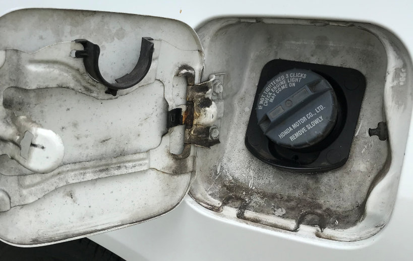

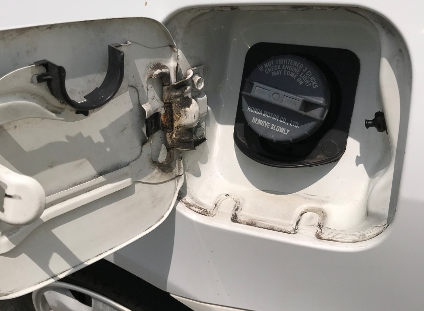

Other comments:

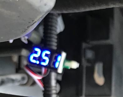

I used my code reader to execute an “EVAP Sys. Leak test”. The code reader indicates “Command Sent” and I heard what sounded like a relay near the canister. This did not cause any malfunction indicator light (Check Engine Light) nor did it set any codes. However, the gas tank is near full so this may not be a legitimate test.
I found some areas that may show evidence of leaks and cleaned them up so that I could check for future evidence of leaking.
The first image is a dirty IAT sensor. The second image is the same sensor cleaned up so that I can check for future leaks.

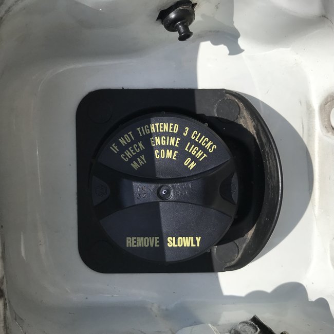

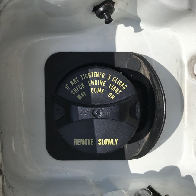

The third image may indicate leaks from the gas cap. The fourth image is the same area cleaned up so that I can check for future leaks.

The elak will be gas vapor so its hard to see. I do not see anything in the pictures that warrant a leak you are going to need to test the castistner and lines with the control valves to find the leak. Have you tried a new gas cap?

I did order a new Honda gas cap online. I will give that a try.
If (after installing the new cap) I get a check engine light, I will provide an update. If I do not get a check engine light after a couple of tanks of gas, I will report presumed success, but that will probably take a few weeks to know.

Since the last time I had the check engine light (and the P1456), I have made two changes. (1) I applied the caulk described in my 6/23/18 post and (2) I replaced the gas cap on 6/30/18. Ken responded to the 6/23/18 post and indicated that the caulk would not help. I have not yet checked the canister for leaks.
I installed a new gas cap on 6/30/2018. The original gas cap had been in use since I bought the car in October 1997. The sticker near the driver’s side door indicates the car was built 09/97.
When the new fuel cap was installed, the car had around a three quarter full gas tank. It has been driven a few times (several trips) so that it is now just over half full. The check engine light has not yet come back on. I think if it gets through the next tank of gas after the current one, the problem is likely fixed by the new gas cap.

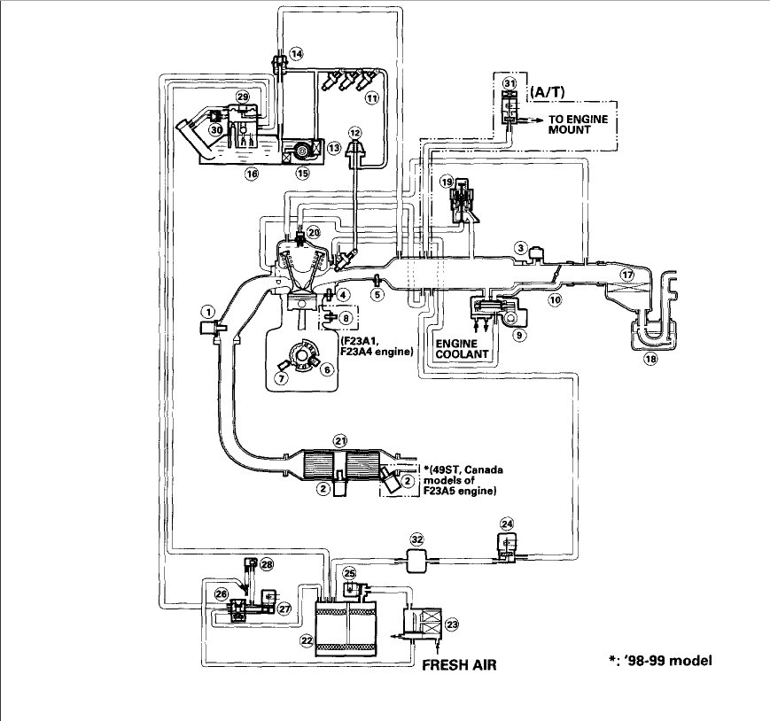

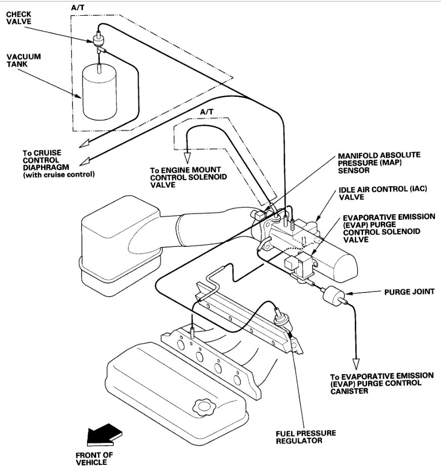

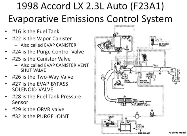

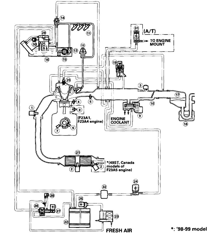

It is a simple system of hoses valves and air tight containers. You should be able to eliminate components by using simple tests.
Here is the entire system so you can start at the front and work your way back.

I tried to label items on the diagram. Did I get them correct?
Jul 22, 2018 at 4:57 PM
  • 54,859 POSTS
Yes, looks right to me. Let me know what you find. Happy hunting. ;)

I use this car to go to work so I am hesitant to take off parts that I have never taken off before. Because of that, I would like to be able to do as much testing as I can with the parts still installed on the car. I would also like to test as much as i can without the engine running.
It is even better if I can test with the ignition key in the off position. I cannot do all of the testing that way, as testing the fuel tank pressure sensor appears to depend on having the ignition key on, and using a volt meter, but the engine does not need to be running.
I think I could do much of the testing with the ignition off. I need some tools, one being a hand vacuum pump (Mityvac, which I have not yet bought). I also need something to activate some of the solenoids. I do not know of a tool for that, so I might make something using a 9 volt battery, but wish I could find a real tool for this purpose.
For example, if I want to test the purge control valve (#24), I think I can do that with the ignition off. I can disconnect the vacuum hose from the manifold that leads to the purge control valve. I can connect the hand vacuum pump to the hose and create a vacuum. I would expect the purge control valve to be closed since the ignition is off, and I would expect the vacuum to hold unless the purge control valve leaks. I am not sure how much of a vacuum I will need, but assume I can figure that out. I think that if the vacuum holds for two minutes or so, the purge control valve does not leak. I would also want to be sure that the purge control valve opens when it is supposed to open. If I disconnect the two pin connector from the purge control valve solenoid, I should be able to test it by applying power from a 9 volt battery to the solenoid. I do need to figure out which side is positive (+) and which is negative (-) on the solenoid. If I find the vacuum holding at some level just before I apply power, I would expect the vacuum to immediately drop when the 9 volt battery power is correctly applied to the solenoid. I can do that test without even looking under the car. If the purge control valve is good, I would reconnect the vacuum hose between the purge control valve and the intake manifold. I would also reconnect the two pin connector to the purge control valve solenoid to make sure I put things back the way they started.
I understand that manifold vacuum pressure (perhaps negative pressure) gets to the EVAP canister via the purge control valve. If the purge control valve appears to be doing its job, I could then move testing to the other side of the purge control valve by disconnecting the vacuum hose from the purge control valve that leads to the EVAP canister. I would connect the hand vacuum pump to the open end of that vacuum hose, where I disconnected it from the purge control valve. This places the vacuum suction past the purge control valve, but for the rest of the system suction would appear to be coming from the intake manifold. If I try to create a vacuum, it should fail because, as I understand it, the EVAP canister vent shut valve is normally open. Doing that test shows that either the EVAP canister vent valve does its job when no power is applied to its solenoid, or some other leak is occurring.
The EVAP canister vent valve closes when power is applied to the EVAP canister vent shut valve solenoid. If I disconnect the two pin connector from the EVAP bypass solenoid valve, I could apply power from a 9 volt battery to that solenoid. I think I should be able to create and hold a vacuum in this condition, because the rest of the system appears to be a closed system. However, my supposedly closed system seems to have a leak, which means it is not truly closed. I could then try clamping shut the all of the hoses that connect to the EVAP canister except the line that leads back towards the purge control valve (or hand vacuum pump when configured for this test). With the 9 volt battery attached to the EVAP canister vent shut valve solenoid, I should be able to create a vacuum with the hand pump. If I cannot create a vacuum, I have a leak in my canister (#22), a leak in my evap canister vent shut valve (#25), or a leak in the vacuum hose or purge joint (#32) on the route back to the purge control valve (#24). I can test the vacuum hose part by placing a clamp on that hose near where it attaches to the canister and trying to create a vacuum using the hand pump.
If the vacuum hose is good, that indicates that either the (#22) canister or (#25) vent shut valve leaks. In that case, I probably need to remove the canister to try to isolate which has failed. At that point, I might want to replace both unless I can figure out how to test the vent shut valve by itself. Or as you suggested quite some time ago, I could plug holes in the canister and check it for leaks, but I would have to remove the vent shut valve first. After replacing either or both, I would clear the code, put things back, and test drive until I get through at least a tank and a half of gas to see if the p1456 comes back.
If instead the above tests indicate working equipment, I need to figure out how to test the (#26) two-way valve, the (#27) eval bypass solenoid valve, and the (#29) ORVR valve. I suppose my new gas cap could also be at fault, which would be a real shame after all of this! I do not quite understand how the two-way valve (#26) is supposed to operate. I think vacuum applied to one of its connections causes it to either connect to the canister or bypass it. Is that correct? What does the eval bypass solenoid valve (#27) do?

You can use 12 volts from the battery and a couple of wire leads to test the solenoids. It seems like we are making this harder than it needs to be. The system is leaking somewhere. Have you removed the canister and plugged it with pressure and held it under water to see if it leaks? Do a visal on the hoses and manually check the control valves using 12 volts, gas cap good?

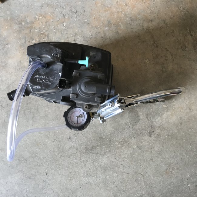

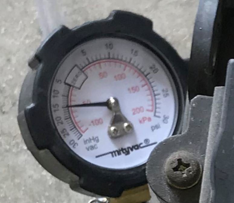

I removed the canister, then plugged all the canister openings except the one labeled 'purge', where engine vacuum is applied when the engine is running. I attached a hand powered vacuum pump to the purge opening and created a vacuum. The canister held 15-inHg vacuum for several (at least ten) minutes. I removed the rubber plug from the canister vent valve and vacuum was immediately lost (dropped to 0-inHg). This indicates that the ‘normally open’ valve was open as expected. I put the plug back in and restored the 15-inHg vacuum. This time I applied 12 volts to close the canister vent shut valve. Then I removed the rubber plug from the canister vent valve and the vacuum dropped to around 8-inHg and held there. I removed the 12 volts and the vacuum again dropped to 0-inHg. I repeated the test with the 12 volts applied and got the same result. How much vacuum should the canister vent valve be able to hold?
Aug 25, 2018 at 11:45 AM
GORDON2
  • 76 POSTS
I disconnected the vacuum line from the canister that goes to the two way valve. I connected a hand powered vacuum pump to that line. I disconnected the tube from the canister that leads back to the ORVR valve and put a rubber plug in that tube. I applied 12V to the two-way valve (evap bypass solenoid). I connected a voltage meter to the fuel tank pressure sensor and noted that with the gas cap removed I have 2.51V. After tightening the gas cap three clicks, I created sufficient vacuum to get the volt meter to read 2.10V. I let that persist for a few minutes. I then loosened the gas cap, and the volt meter went back to 2.51V (pretty timely response, sensitive to how quickly the cap is loosened). I believe this confirms that the gas cap does its job.

Yes, it sounds like everything is working. I am starting to lean toward a bad PCM which can cause the issue as well. I would try a used unit and plug it in to see what happens. Here is the location.

Is the 8-inHg held by the canister vent valve adequate? I was thinking that was a likely candidate for needing replacement.
I was also thinking I still needed to determine whether either the two-way valve or the ORVR valve was problematic. Would you rule those out already?
I would like to run the vacuum/valves/etc., to ground before trying to figure out the PCM business. But if that is where the problem is, I suppose I will end up there.

It does sounds like the canister is leaking slightly, also if you get a used PCM you will not need to program it. Check all electrical and hoses then go for the PCM. Gas cap is good correct?
