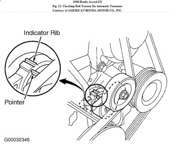

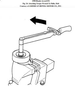

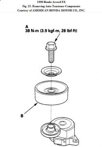

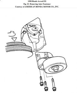

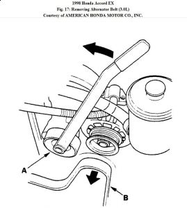

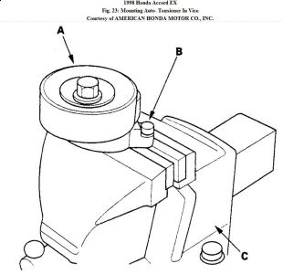

Please advise me how to remove and replace the alternator tensioner on my honda coupe v6. How many bolts to remove as I can only see one on top. Worn bearing on wheel/pulley cannot be removed by itself as bolt backs into wheel well/frame housing when loosening. Diagrams if availble for visual recognition if possible would be appreciated. A side issue is why the automatic transmission lags or hesitates when taking off from a stop when cold? ***Please help, layed off work.

AUTO -TENSIONER
Inspection & Replacement (3.0L)
1 . Check the position of the auto-tensioner indicator's pointer "A", start the engine and check the position of the pointer again. If the position changes, go to step 5 . See Fig. 21 .
https://www.2carpros.com/forum/automotive_pictures/192750_AlternatorBelt98Accord6cylFig21_1.jpg
2 . Check for abnormal noise from the tensioner pulley. If you hear abnormal noise, replace the tensioner pulley.
3 . Stop the engine. Remove the alternator belt. See Fig. 17 .
https://www.2carpros.com/forum/automotive_pictures/192750_AlternatorBelt98Accord6cylFig17_1.jpg
4 . Check if the auto-tensioner "A" moves smoothly and check for abnormal noise when the pulley is turned counterclockwise. If the auto-tensioner does not move smoothly or if the there is abnormal noise, replace the auto-tensioner. Do not move the auto-tensioner beyond its limit. See Fig. 17 .
5 . Stop the engine, then remove the auto-tensioner. See Fig. 22 .
https://www.2carpros.com/forum/automotive_pictures/192750_AlternatorBelt98Accord6cylFig22_1.jpg
6 . Clamp the auto-tensioner "A" by using two 6 mm bolts "B" and a vise "C". Do not clamp the auto-tensioner itself. See Fig. 23 .
https://www.2carpros.com/forum/automotive_pictures/192750_AlternatorBelt98Accord6cylFig23_1.jpg
7 . Attach a torque wrench to the pulley bolt. Measure the torque when the tensioner is turned counterclockwise. If the torque is less than the 17 ft.lbs (23 N.m), replace the auto-tensioner. See Fig. 24 .
https://www.2carpros.com/forum/automotive_pictures/192750_AlternatorBelt98Accord6cylFig24_1.jpg
8 . If necessary, remove the pulley bolt "A" (left-hand threads), and replace the tensioner pulley "B". See Fig. 25 .
https://www.2carpros.com/forum/automotive_pictures/192750_AlternatorBelt98Accord6cylFig25_1.jpg
