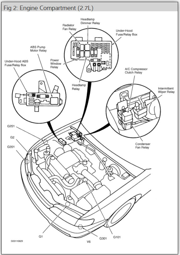

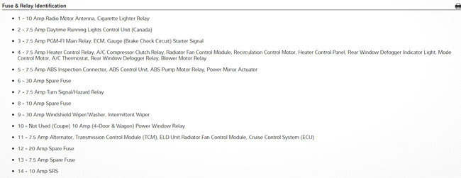

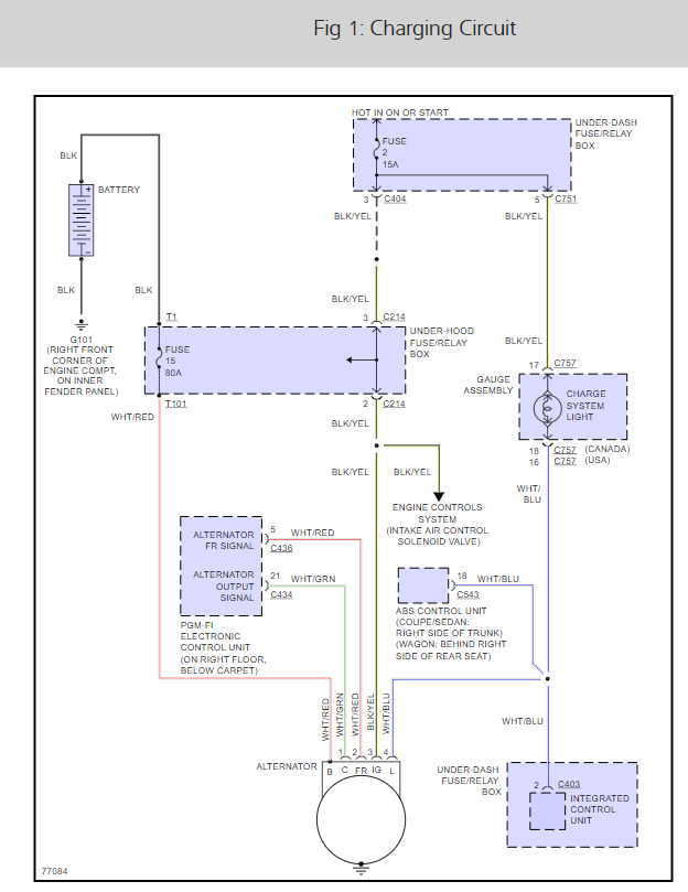

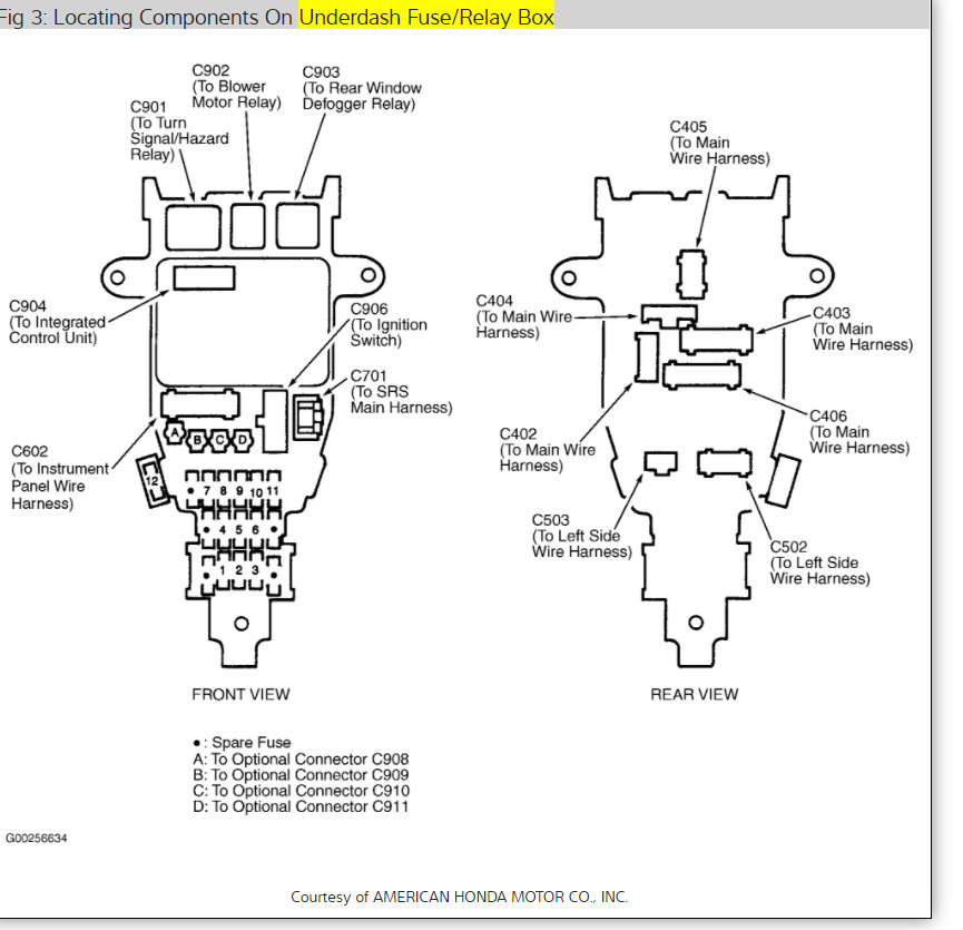

i replaced the alternator but my charge light and abs light are still on. it is charging 13.9 but it is affecting the computer. please help.
Jun 24, 2008 at 4:44 AM
KHLOW2008
  • 41,812 POSTS
Hi CHARLES PIERSON,

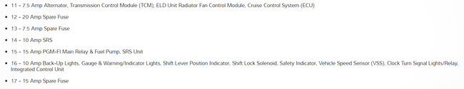

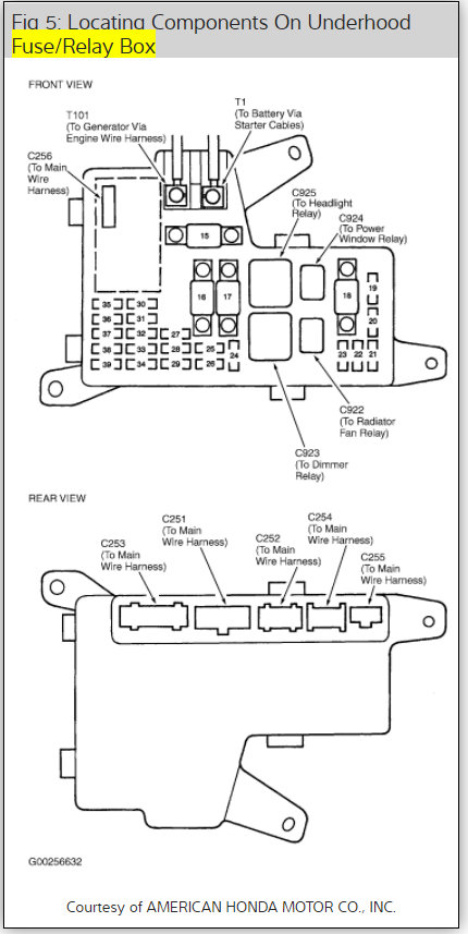

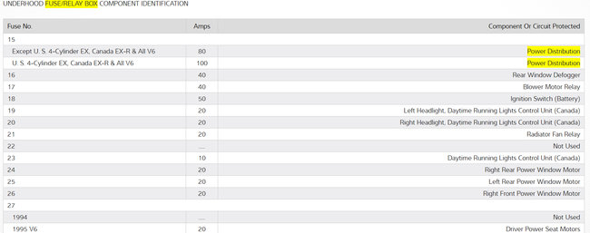

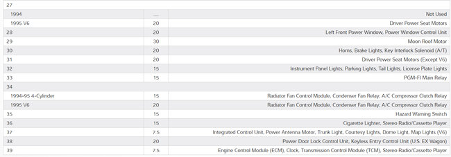

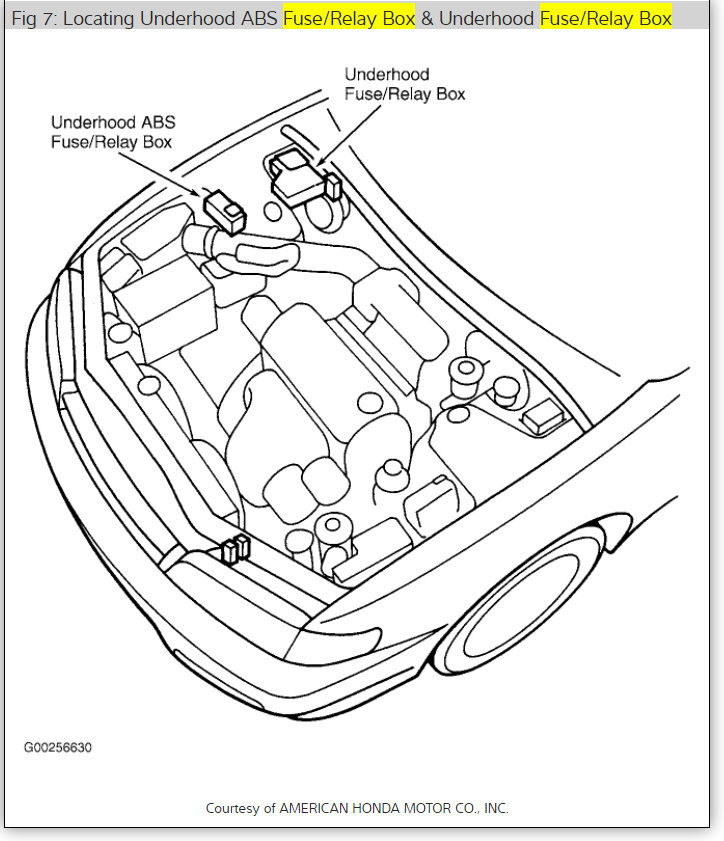

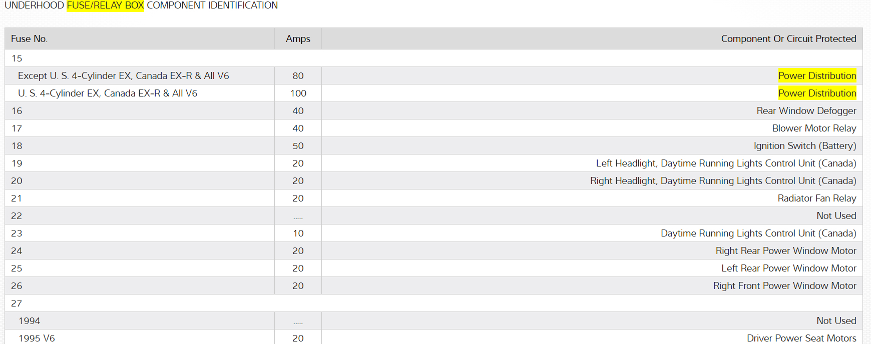

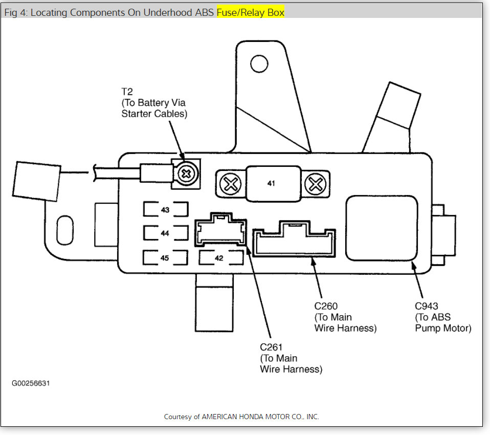

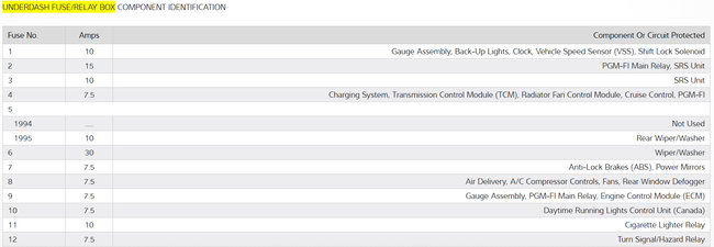

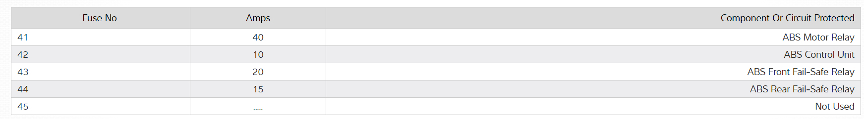

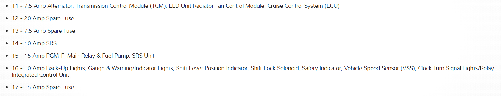

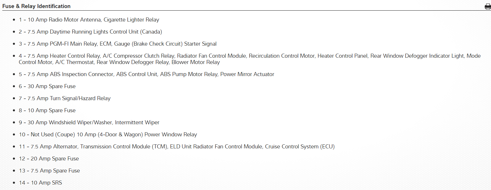

There is a fuse #2 15 amp i would check in the fuse panel, if that's okay here is a wiring diagram and a guide to help you check the wiring.
If the wiring checks out I would replace the PCM with a used one.
