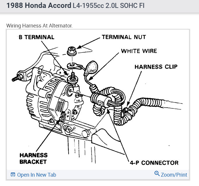

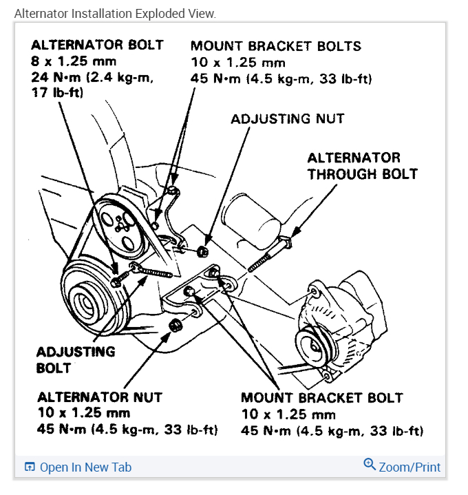

What is the EASIEST way to remove AND replace my alternator in my 88 Honda Accord DX?

Hi JDizzle420247,
You will need to remove the drivers side CV axle to get the alternator out here are guides to help you get the job done with diagrams below.
https://www.2carpros.com/articles/replace-cv-axle
and to walk you through the steps.
https://www.2carpros.com/articles/how-to-replace-an-alternator

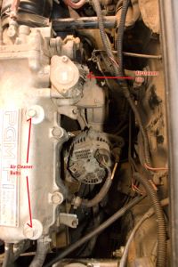

DGIMESON
My Answer
1. Disconnect battery
2. Remove Air Cleaner (4 clips and slide up and out)
3. Remove Air Cleaner Box (2 10mm bolts and low clip)
4. Remove Alternator tension bolt, move belt out of the way
5. Remove Alternator pivot bolt, lower part of Alternator
6. Disconnect wire clip from back of Alternator
7. Slide Alternator back towards firewall and were the Air Box was. Ta Da
8. Disconnect wires, left Alternator straight up and out.
Install in reverse order (8-1)
This worked for me. Remember to safety first.
https://www.2carpros.com/forum/automotive_pictures/467800_88AcrdAlt_5418_1.jpg
