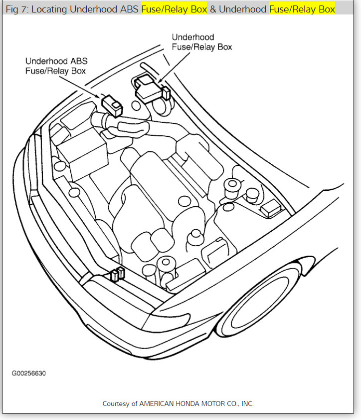

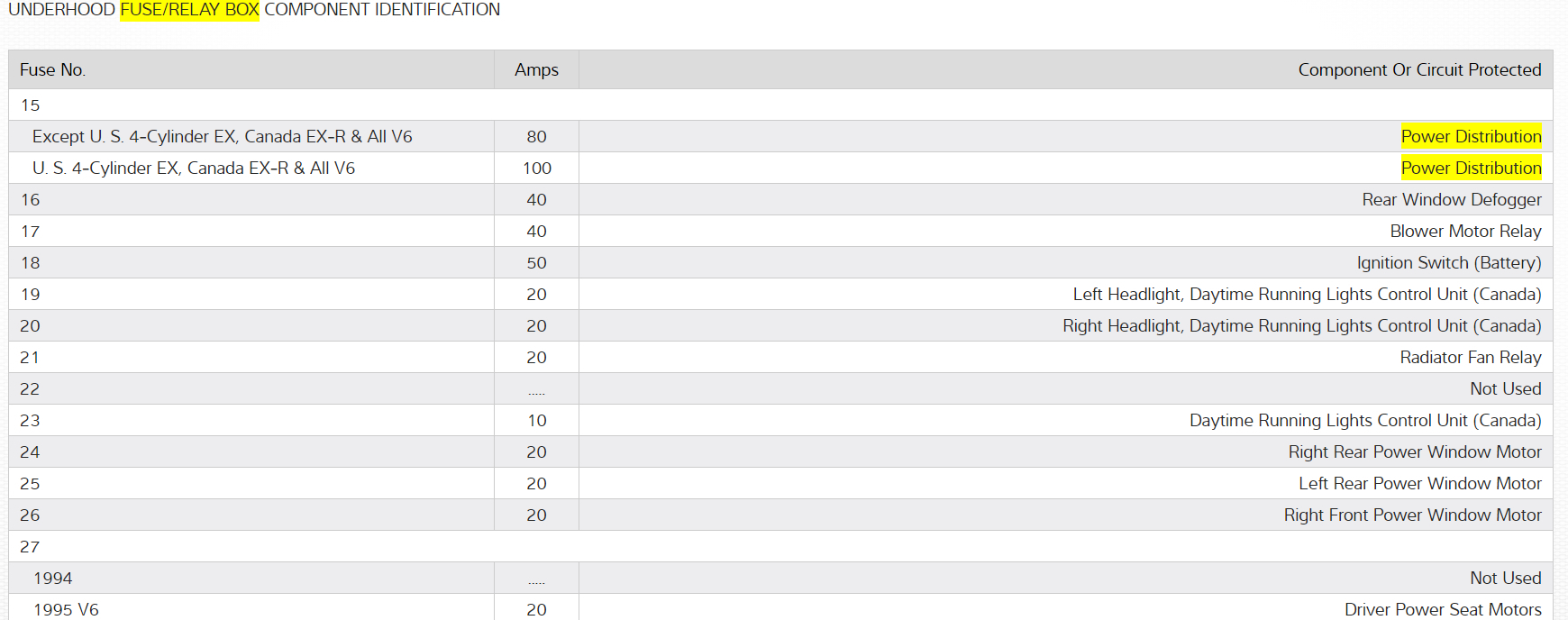

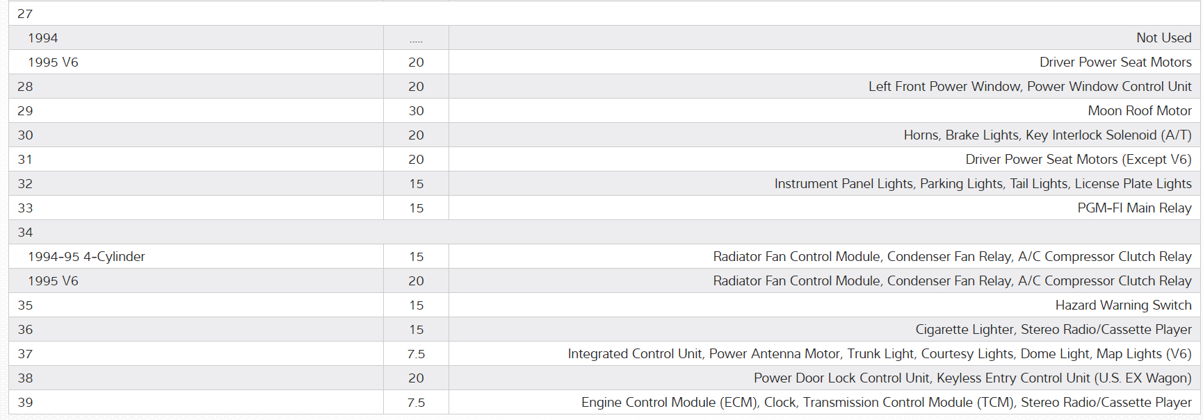

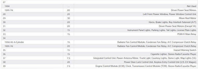

I tried to install a stereo and right after I had no taillights. There were headlights and turn signals but no taillights. I looked in the manual and there was no description of which fuse to replace for no taillights. Which fuse runs the rear taillights? Can you please tell me which fuse I need to replace?
Jan 2, 2009 at 4:29 PM
  • 75,988 POSTS

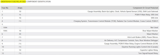

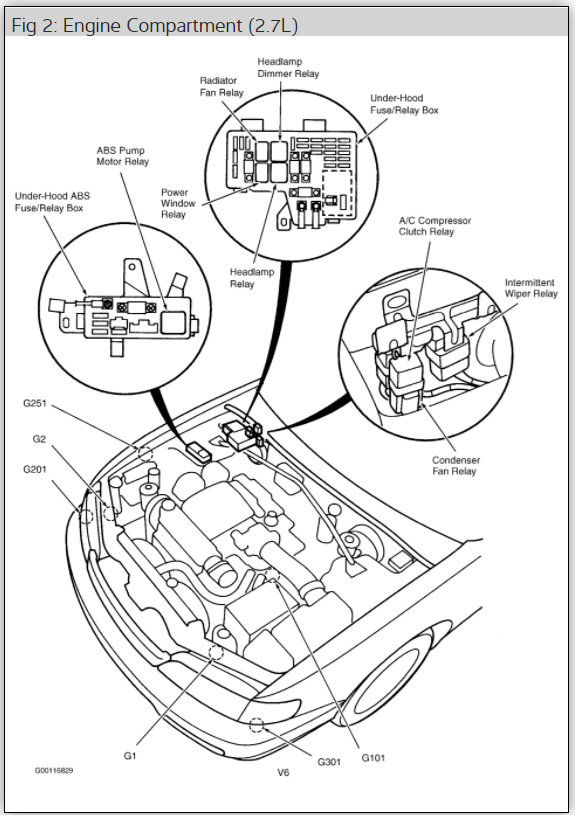

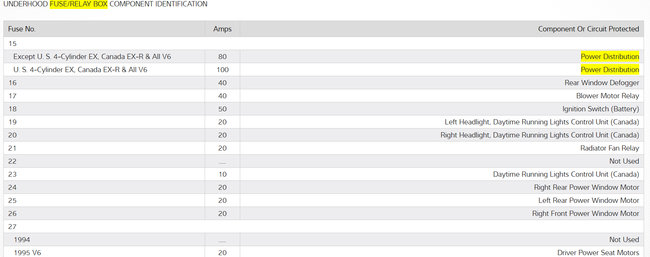

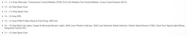

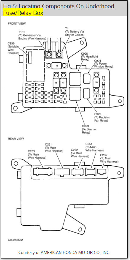

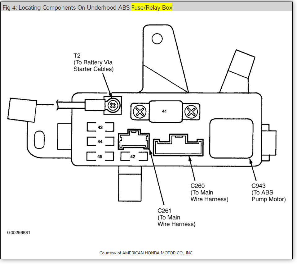

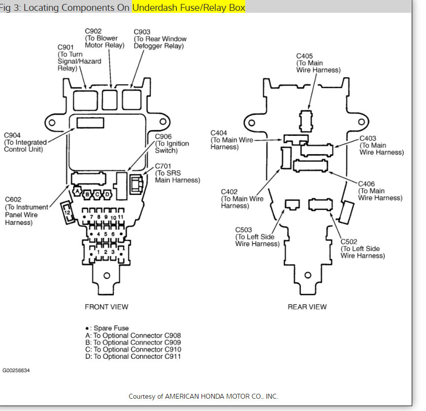

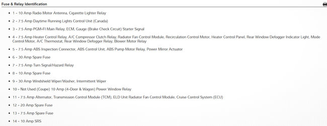

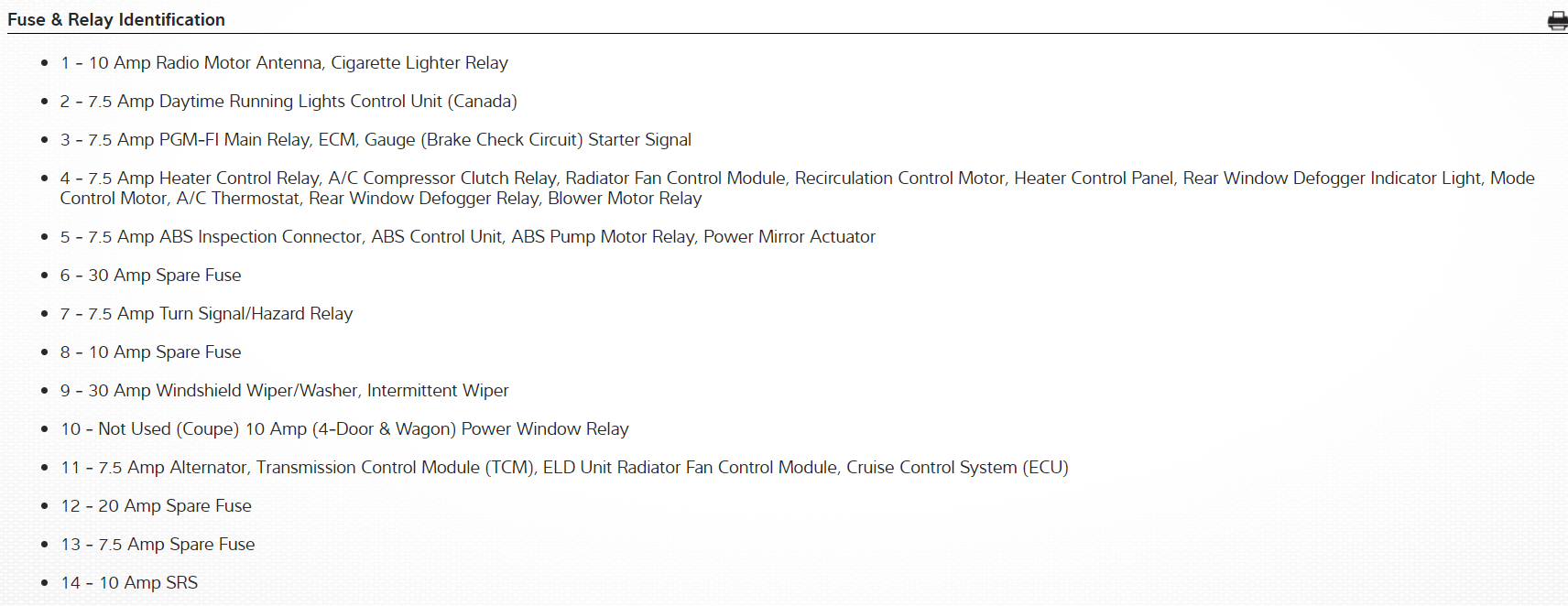

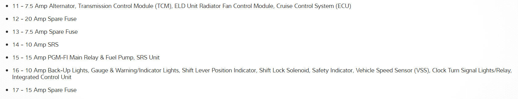

Please check fuse no. 32 and 30 both 15 amp it powers the headlight switch and then to the tail lights. Here is a guide to help you test for power and the fuse locations and descriptions below:

Thank you. It was the fuse. ;)
