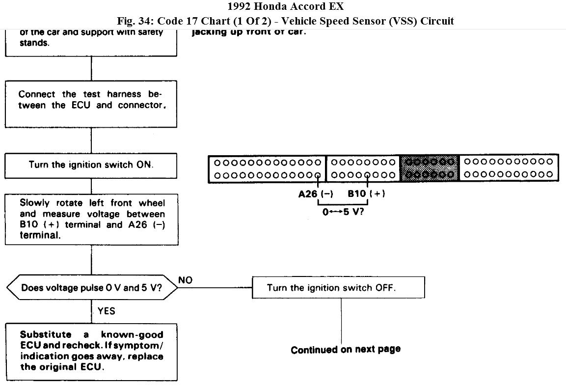

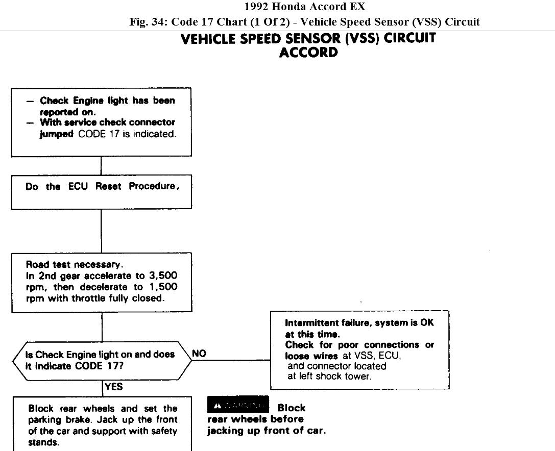

Pulled codes from TCU and ECU:
TCU Code 4 - VSS open/shorted - No signal from speedometer
ECU (Check Engine Light):
12 - Exhaust Gas Recirculation/EGR Lift Valve
17 - VSS - Speed Sensor
41 - Primary Oxygen Sensor Heater
I know codes 12 and 41 (probably) have nothing to do with a working speedometer. I know what an oxygen sensor is and what it does, but just out of curiosity what is an oxygen sensor heater?

DREW13
I have already replaced the speed sensor (VSS), the Transmission computer (TCU), and the speedometer cluster gauge and my speedometer still won't work. I swapped these parts from working vehicles so I know they are functional. What would be my next step?
Thanks in advance for any possible help.
Jul 14, 2020 at 12:56 PM (Merged)
PROMECHANIC
  • CERTIFIED EXPERT
  • 536 POSTS
Sounds like you either have a problem with the wiring to or from the VSS or maybe even a problem with the speedometer gauge itself.

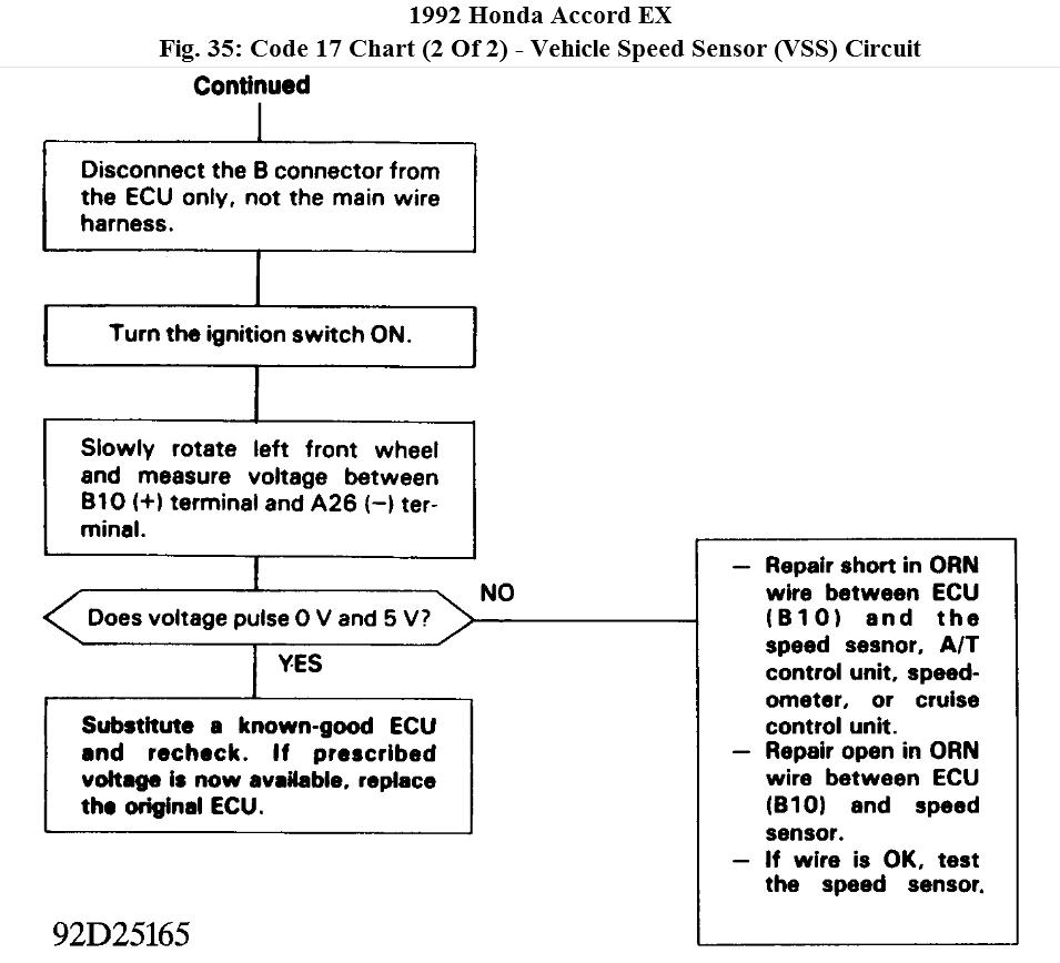

I have already replaced twice the speed sensor, the speedometer still does not work. well, that is not correct, when it rains hard, and there is alot of water all over the road, the speedometer starts working for about 30 to 40 miles, but for the most part it just doesn't work. what is the next step that i need to be checked out?
BLUELIGHTNIN6
  • CERTIFIED EXPERT
  • 16,542 POSTS
You will need to use these steps to diagnose the faulty speedometer.

recently my speedometer does not work when car first starts and drives, after 3-8 minutes it begins to jump around and finally works properly with no excess movement. does not happen every time as sometimes there is no issue and it works as it should. Looking for some quick checks or elimination tests to determine a possible source. weather has begun to get cooler, could this have any affect?
Thanks
Jul 14, 2020 at 12:57 PM (Merged)
HMAC300
  • CERTIFIED EXPERT
  • 48,601 POSTS
have your speed sensor checked
SUPERMOTO
Thank you, is this something i can test at home? how? or an autoparts shop? I can't get all four wheels off the ground to complete a running test with vehicle on and in drive
Thanks again.
HMAC300
  • CERTIFIED EXPERT
  • 48,601 POSTS
it's on the transaxle and it hs to pulse between 0-5 volts when turning. it could be a wiring issue as well unless there is a speedo cable if there is lube it
