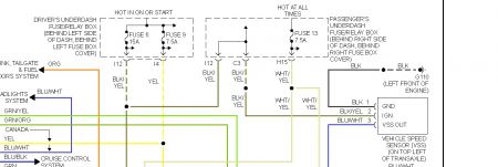

JDL
  • 16,098 POSTS
Any applicable trouble codes? There is a vehicle speed sensor, vss. I'd check voltage and ground at the sensor. Fuse 6-- 15 amp goes hot when you turn on the key, not only check the fuse, check for voltage on the fuse circuit.
https://images.2carpros.com/forum/automotive_pictures/170934_honda_accord_vss_1.jpg

KALEO707
Thanks man thats exactly what i wanted to hear.I greatly appreciate your info and timely answers!! Have a great day!
