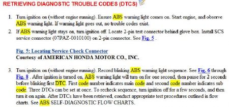

I was driving the other day and heard a sort of a "click" when I applied the brakes. At that time, my speedo went nuts for second and then my ABS light came on...Now the light comes on and off at times...Brakes still work but this is weird...Is it a fuse, the pump or?..I did look at the fuses and they "seem" ok...Can you help?...thanks Kim

i hope you can read that. That is how you retrieve the code for the ABS. Post the code up and we will help you out.
