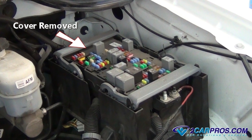

1. Lift the hood and locate the main fuse panel which is usually on the right or left side of the engine compartment and remove the lid, also you can consult your car's owner manual for exact locations. If you still cannot find the ABS-Traction Control fuse location please ask one of our experts at no cost.
