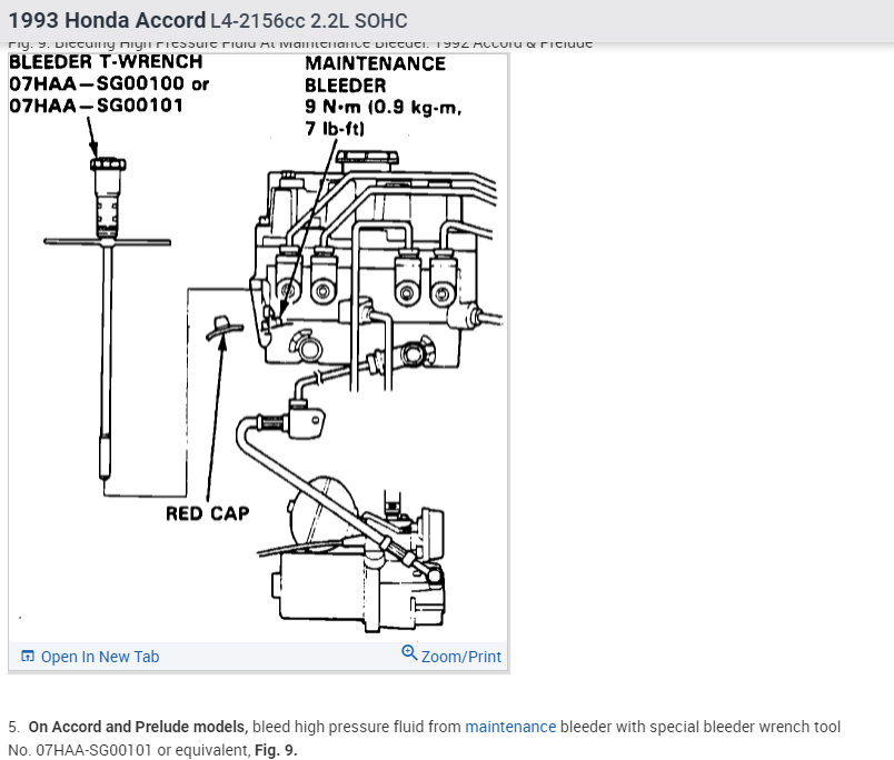

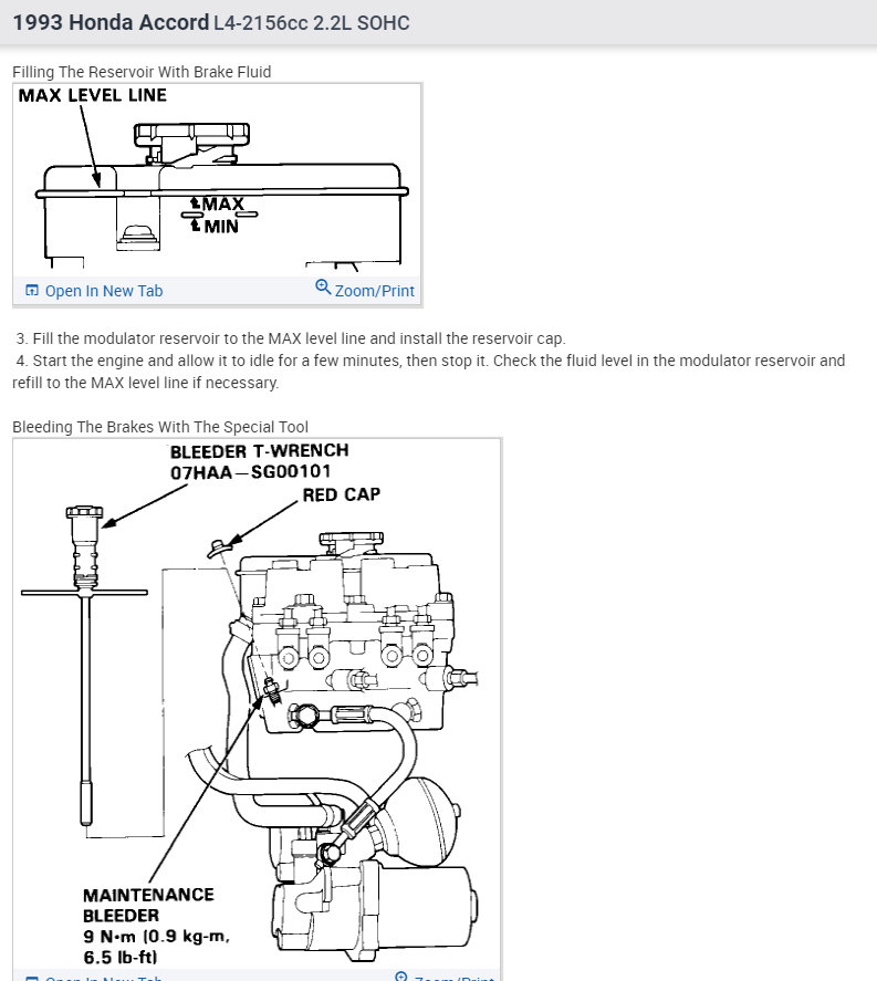

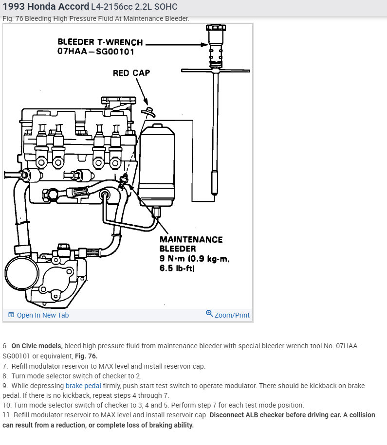

How the heck do I bleed the ABS system. Hooked up a hand vacuum pump and northin came out! I sent ABS out to be repaired and it came back nothing wrong! Checked all 4 wheels and the sensors check out good. This car only has 51000 miles. For good luck I replaced the master cylinder too!
Jul 7, 2008 at 1:58 AM
SQM
  • 6,383 POSTS

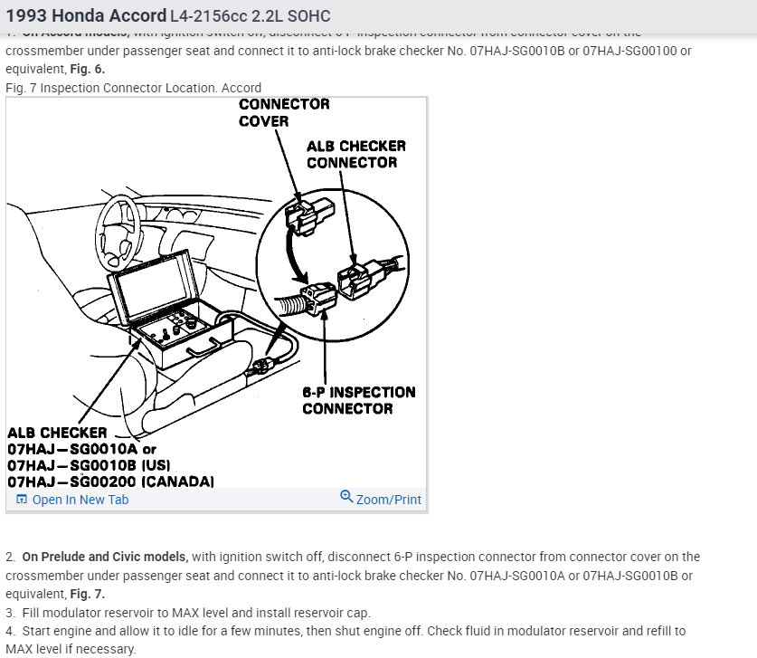

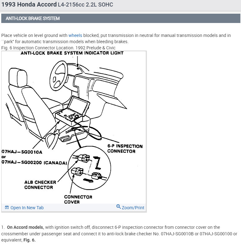

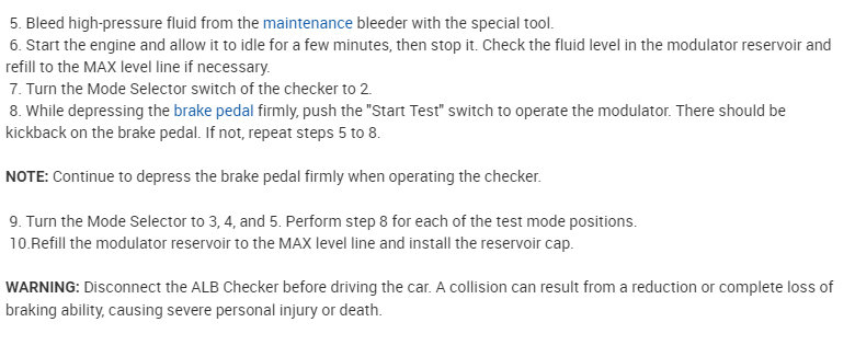

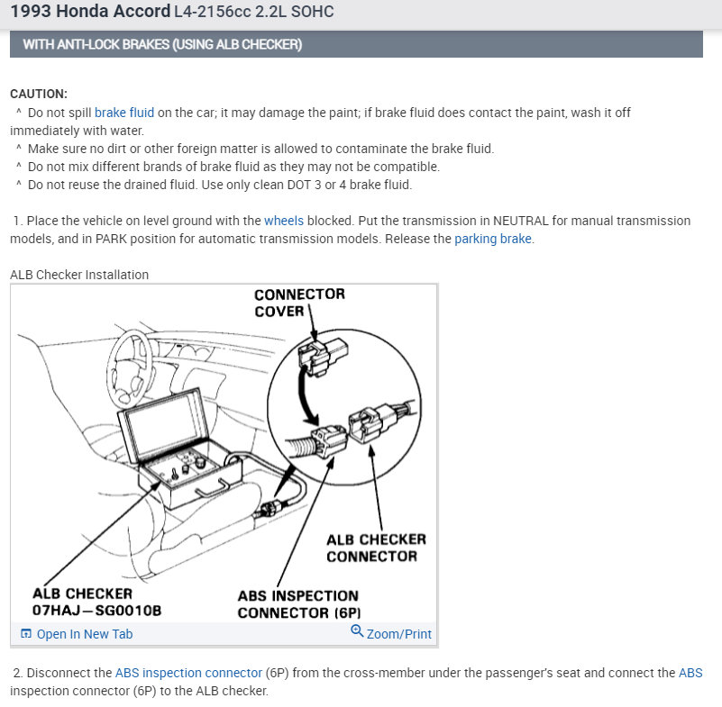

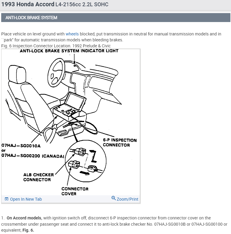

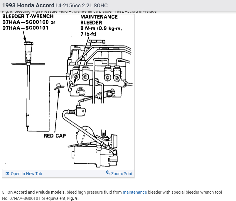

You will need to use a special tool in order to effectively bleed the ABS system on this vehicle.
https://www.2carpros.com/articles/how-to-bleed-or-flush-a-car-brake-system
I have attached the instructions below.
