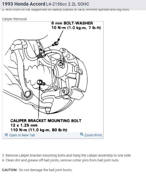

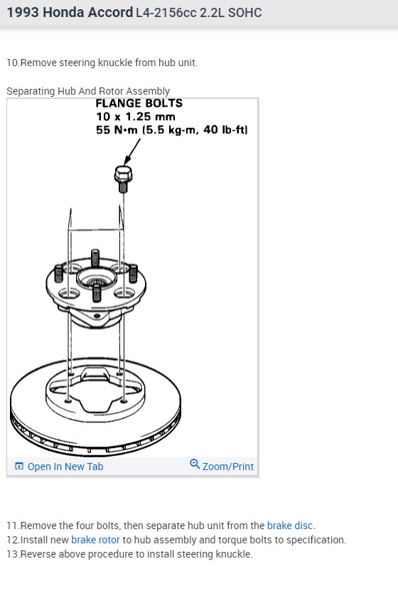

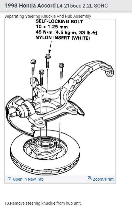

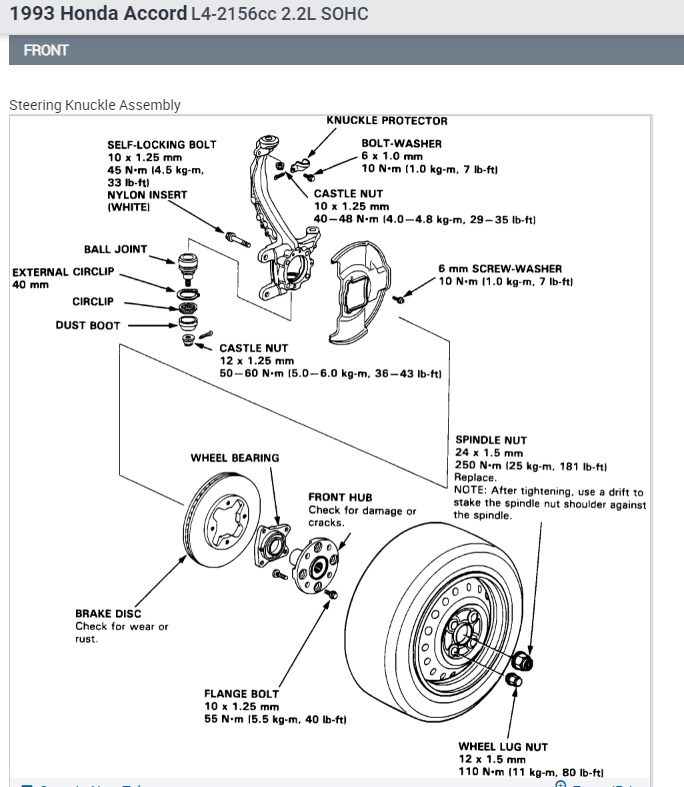

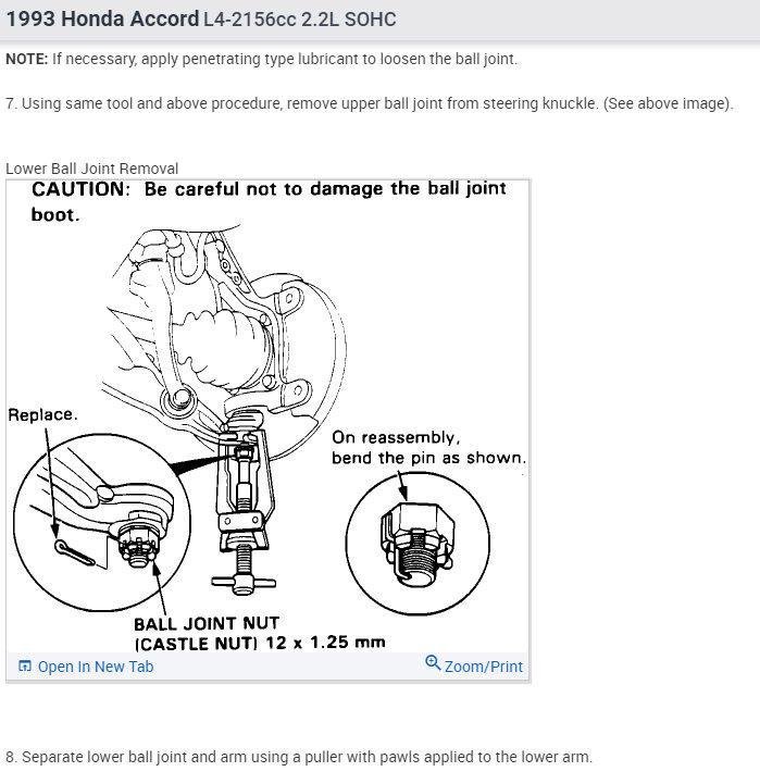

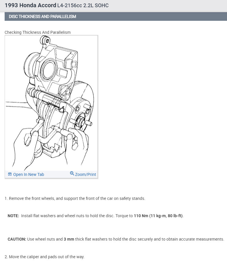

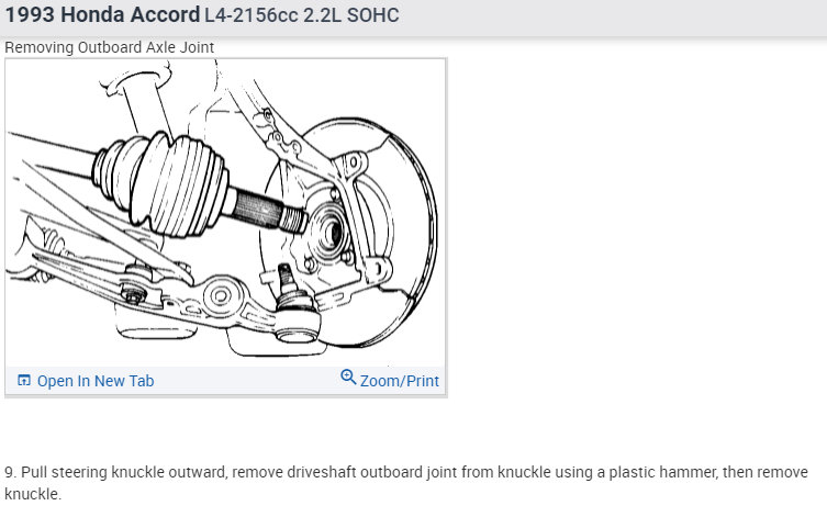

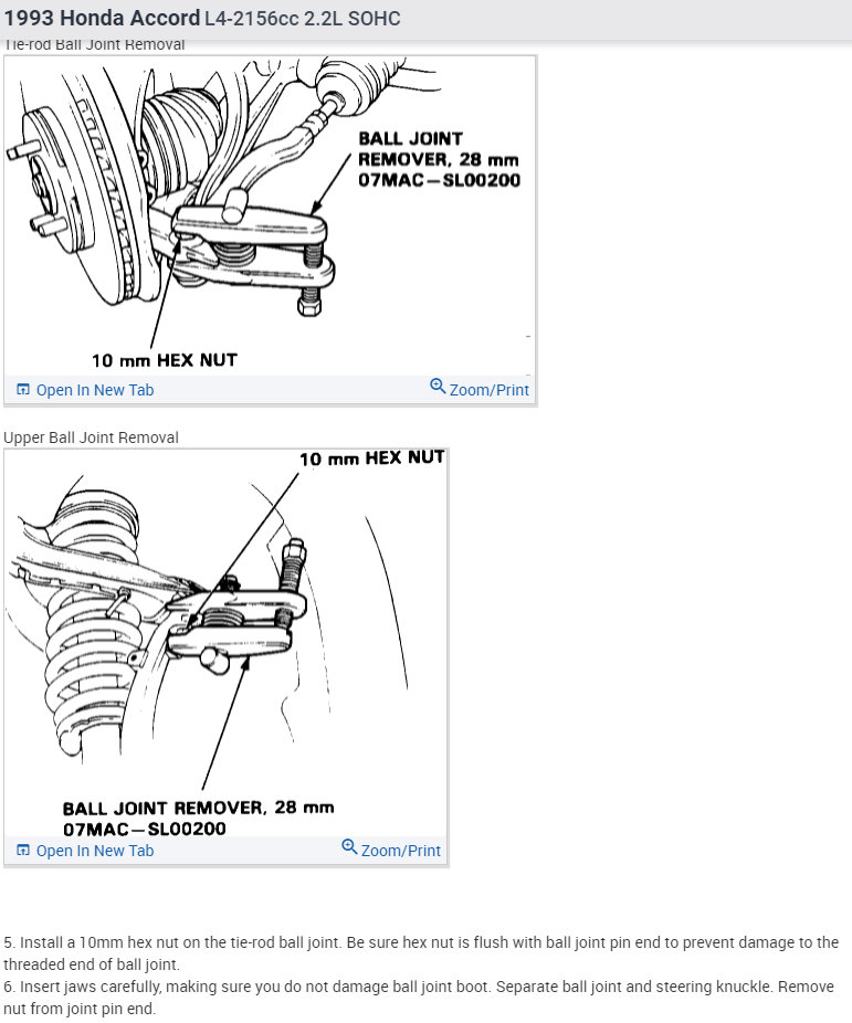

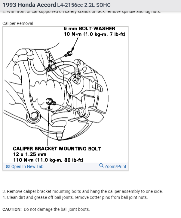

What do I have to do to get the rotors off my car for replacement? They don't look like they come off like they would on most cars.
Wednesday, January 28th, 2009 AT 3:59 PM
SQM
  • 6,383 POSTS

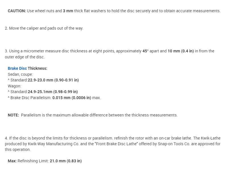

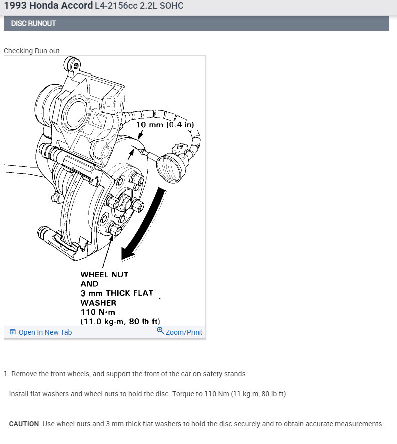

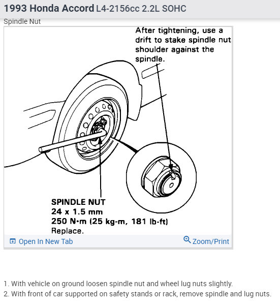

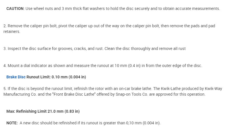

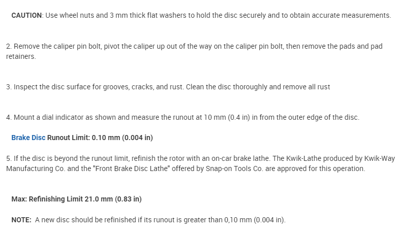

On this Accord, after you remove the caliper and the bracket, the knuckle needs to be removed with the rotor. Then the rotor can be removed.
I have attached the replacement instructions below.
