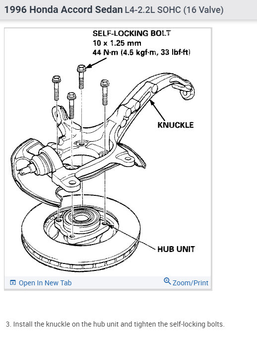

I am trying to replace the rotors on my Accord Wagon
KRUPER21
  • 1994 HONDA ACCORD
  • 4 CYL
  • 2WD
  • 194,000 MILES

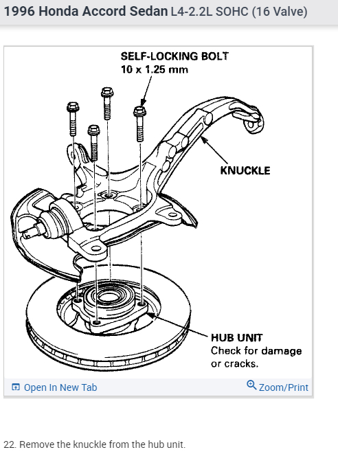

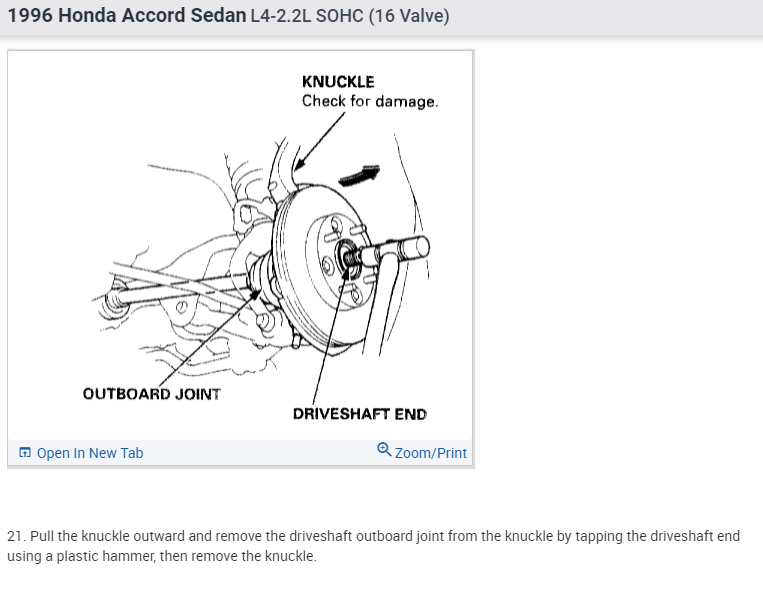

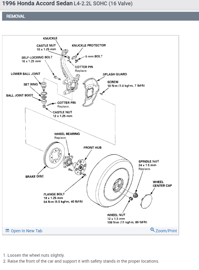

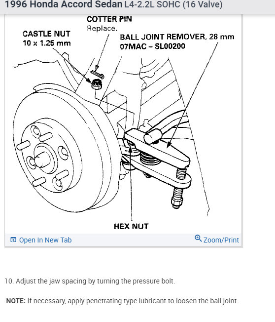

I am trying to replace the rotors on my Accord wagon. The rotor is behind the hub assembly. I have tried using a slide hammer with no success. I did remove the bolts in the back before using the slide hammer. Are there any other tools someone could recommend to get this apart so I can get my rotors changed? Thanks.
Thursday, October 2nd, 2008 AT 12:30 PM
SQM
  • 6,383 POSTS

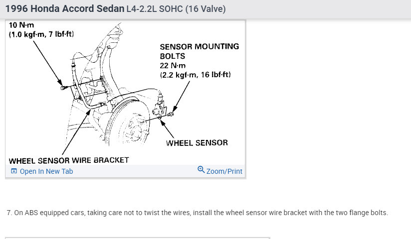

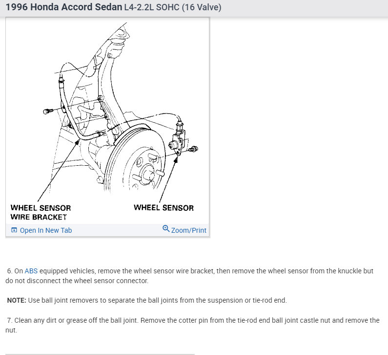

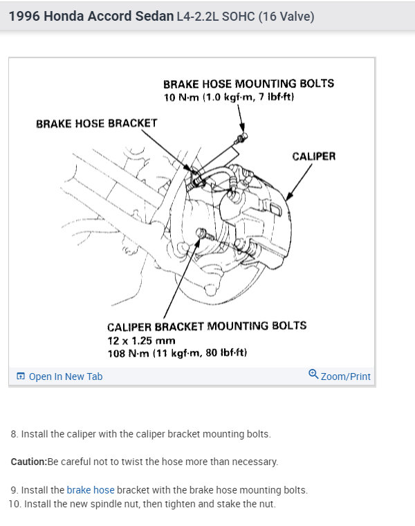

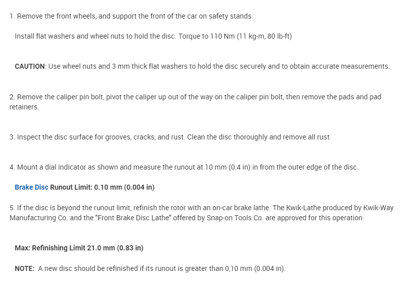

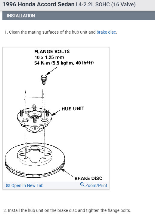

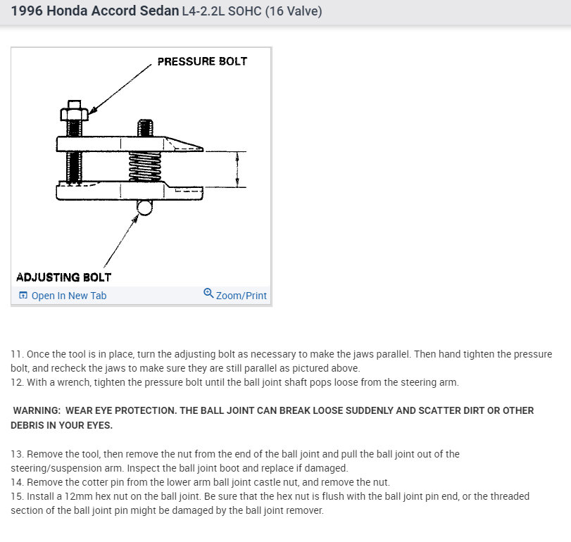

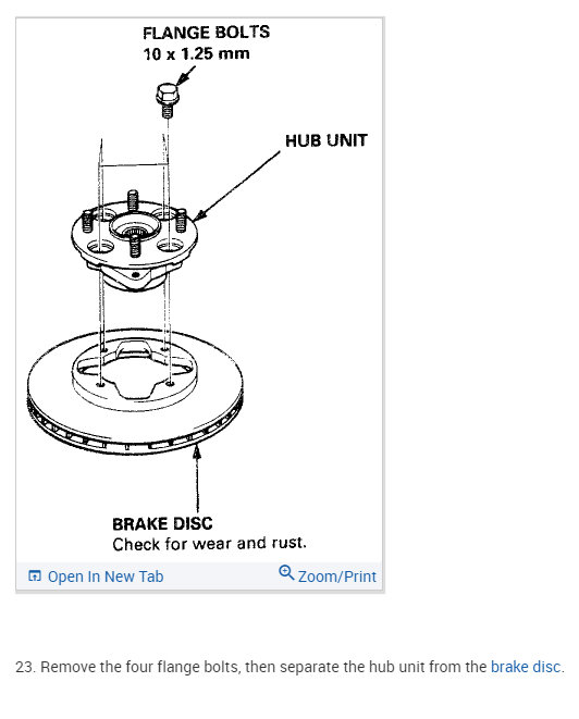

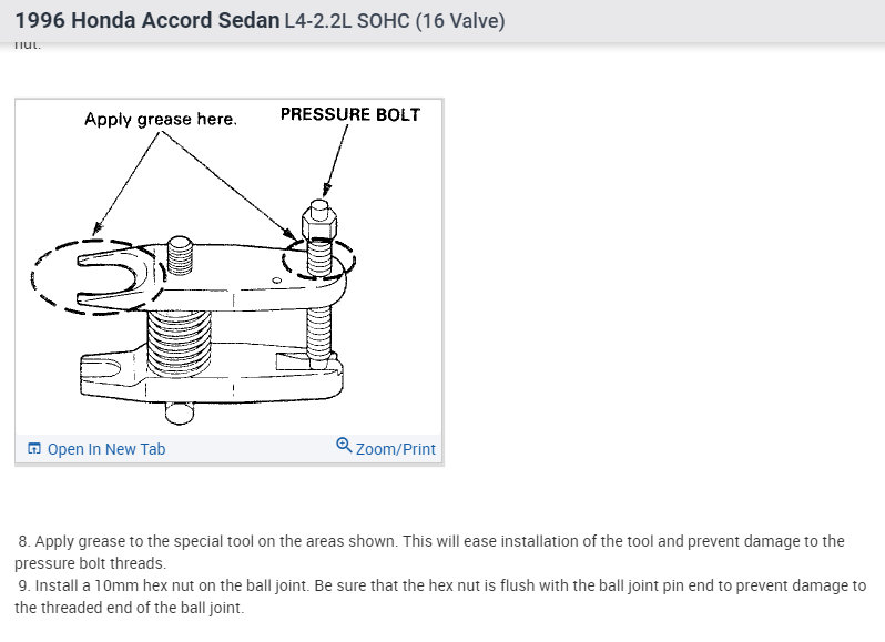

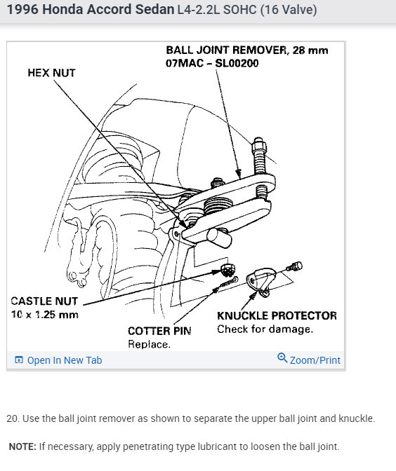

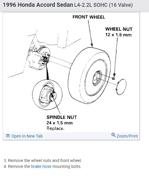

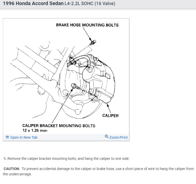

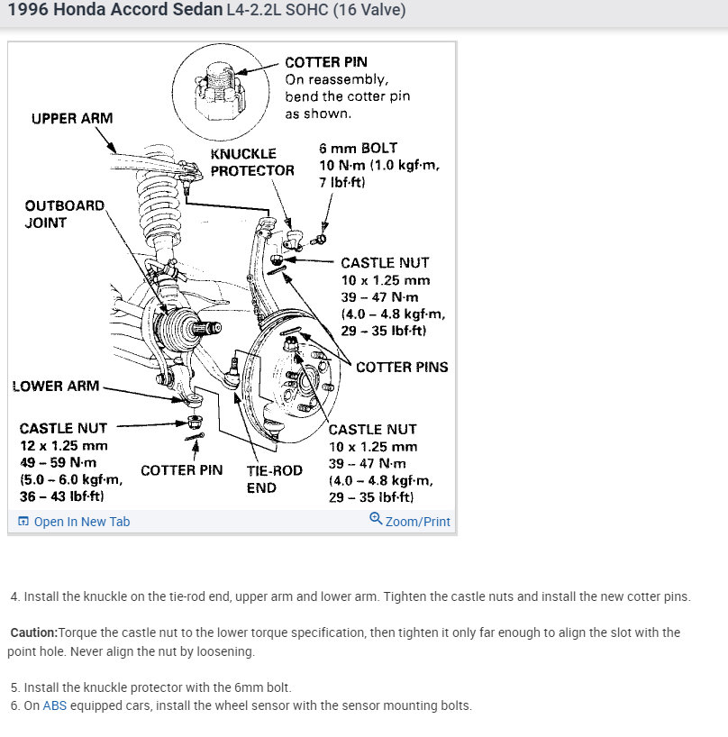

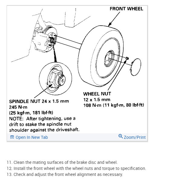

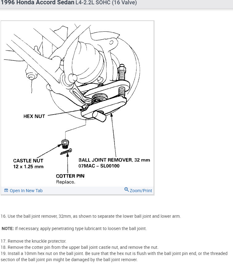

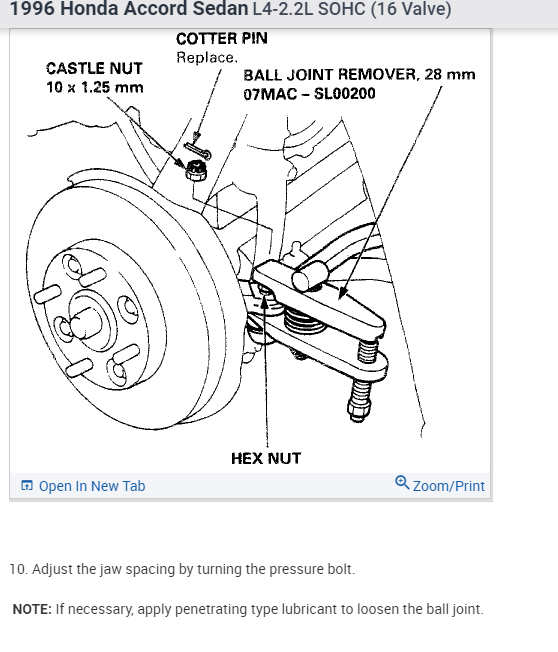

Replacing the rotor on these years / body accords will require you to first remove the knuckle with the rotor mounted on it.
Then remove the rotor.
It is little more time consuming than a typical front wheel drive rotor change.
I have attached the replacement instructions below.
