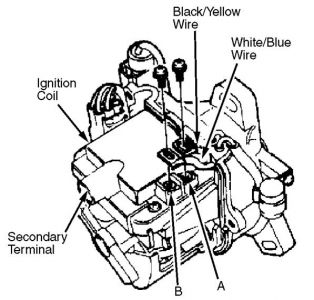

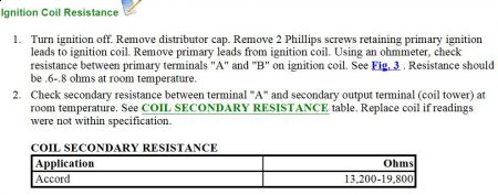

My friend tells me whenever she drives her car ( In warm weather ) its dies and wont start untill it cools down from normall operating temp.I drove it for about an hour,and I cant get it to die.When I drove it,it was raining.I was told in order to find whether the igniter,coil , or stattor is bad,it has to not start.With the ign. off,I checked resistance,ans got 8 when I checked a+ and b-. When I checked resistance with secondary terminal , and a+ it shows no resistance,or no continuity at all.But it still starts right up.I downloded the process from Alldata online,and it does not say to turn ign.on for these test.What am I doing wrong ? Can these items be tested if the car is still operatable.Please help.

Hi sumrplumr, Here are the testing procedures for ignition coils.
https://images.2carpros.com/forum/automotive_pictures/192750_IgnitionCoil90Accord01_1.jpg
https://images.2carpros.com/forum/automotive_pictures/192750_IgnitionCoil90Accord02_1.jpg

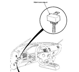

The other item you should check is the PGM-FI main relay. remove the relay and check the circuit board for cracked contacts. Resoldering them should do the trick.
https://images.2carpros.com/forum/automotive_pictures/192750_PGMFIRelay90Accord_3.jpg
