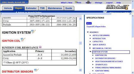

1992 Honda Accord ingintion coil
1992 HONDA ACCORD
200,000 MILES • 4 CYL • 2WD • AUTOMATIC
VEASNAVONG
is there a way to test if the coil still good?thank you
Jun 13, 2008 at 8:57 AM
  • 75,992 POSTS
You have to measure its primary and secondary resistances/ohms- see below
https://images.2carpros.com/forum/automotive_pictures/12900_coil_5.jpg
