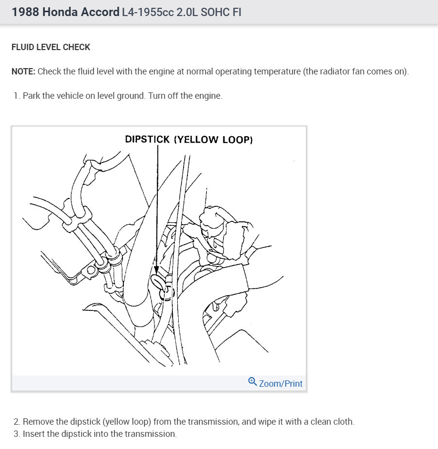

i just bought a honda Accord LX from my friends friend. The only problem is that i supposed to change the entire transmission fluid and filter but could not locate where the dipstick is. Tried looking underneath and almost every place but really could not find it. Please help me. thanks.

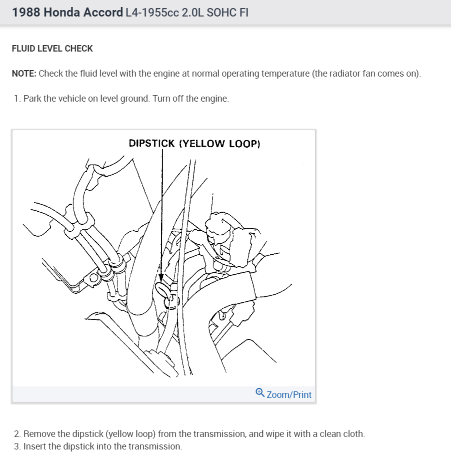

There is a yellow dipstick by the top of the transmission here is a guide to help you service the unit and a diagrams below to help you find the dipstick.
