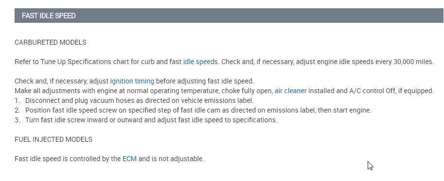

I attached how to replace the IAC assuming you have an electronic fuel delivery system (injectors not a carburetor). It could be the IAC but that normally causes an erratic idle or stall at idle.
If you have high RPM we need to check for a vacuum leak. Here is a guide that runs through this:
I also attached the fast idle adjustment. Again, if you have a fuel injection system then you don't have a way of adjusting idle speed. However, if it is high then we need to run through this info and go from there. There is a chance that it is a throttle sensor but that would normally have a fault code so let's start with this info and go from there. Thanks

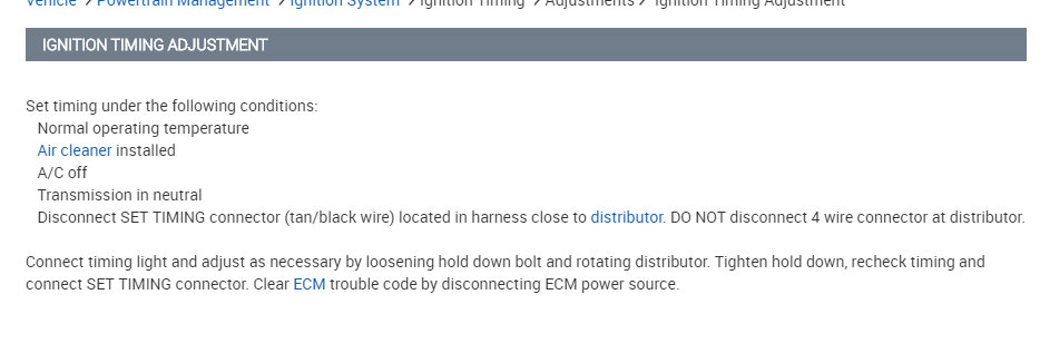

hi, tested the IAC and it moves so that works. I went back to checking timing and upon revving the engine the timing mark retards left way out the mark plate. I got the timing set at 6% btc. it idles with a dip randomly.

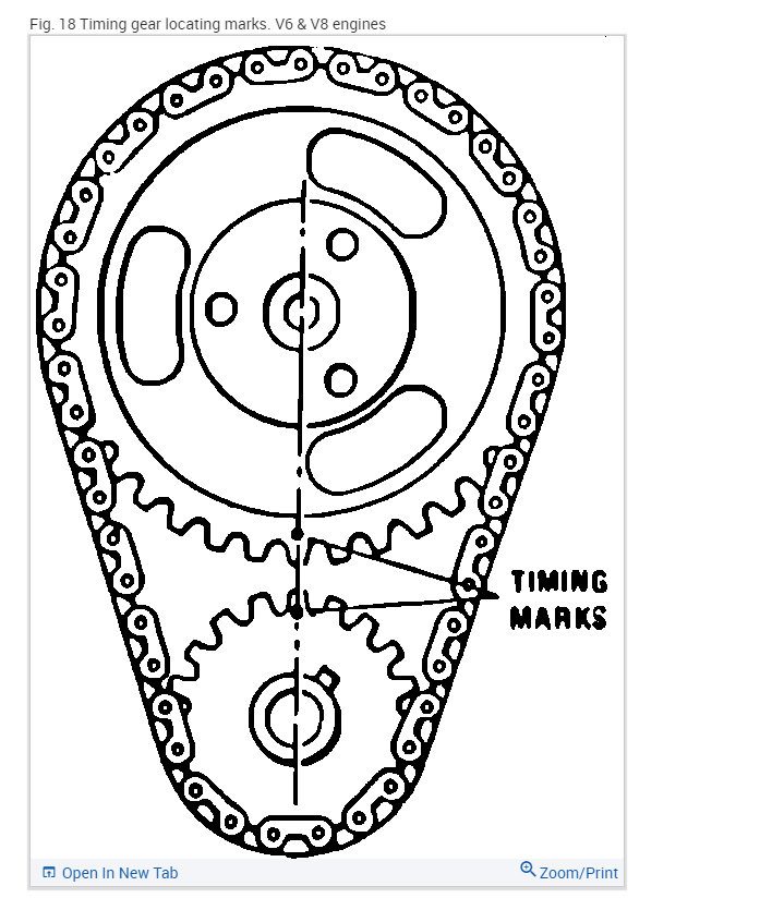

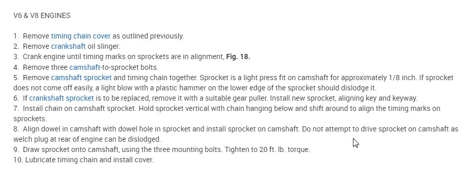

Hi, just a thought. the car starts on the button just perhaps the timing could have jumped a tooth after interfering with the timing it's now backfiring and very rough. also loss of power. plugs are new, the wires recently replaced.
Apr 8, 2020 at 2:50 AM
You have a timing chain and that is unlikely to jump timing but based on what it is now doing especially the backfiring, we need to check it. I attached the timing marks and chain replacement process. I don't think you need to replace it unless you find it is off. If it is, the chain could be stretched and need to be replaced.

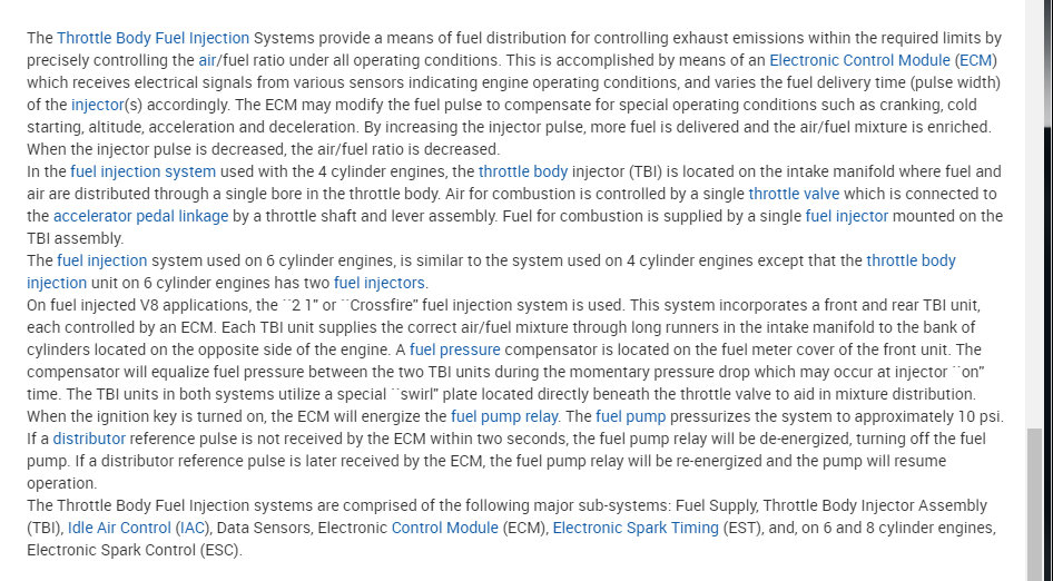

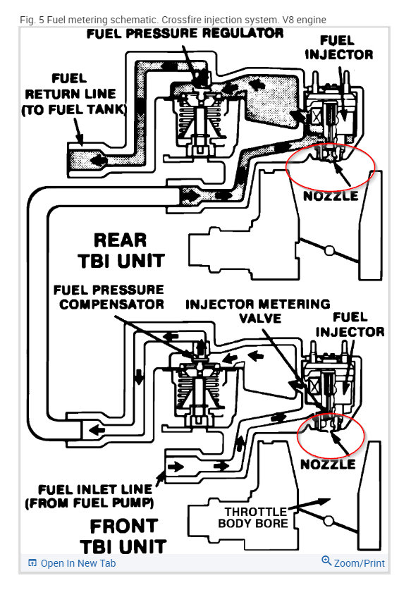

Thanks Kenny, I watched the injectors the spraying of fuel, when cold car idles 3,000 rpm's, no miss, when a little hot idle drops to 2,000 rpm's then occasionally I see extra fuel like drops in a second and causes the surge, is there any way to test the ECM? Also the oxygen sensor has never been changed. thanks, stay blessed.
Apr 10, 2020 at 6:23 PM
Okay. You mentioned it earlier but you have the Throttle Bore Injection (TBI) system, correct? If you did, where did you see the fuel drops? Were they coming from the injector? If this is the case, I don't think you have an ECM issue. I suspect you have a leaking injector or possible just a "dirty" injectors that is causing fuel to drip from it.
However, if you have seen this and that is when the surge happens then you found the issue. Clearly more fuel is going to raise RPM so we need to suspect an injector issue. The injectors are only supposed to deliver fuel when they are opened (pulsed) by the ECM and it is only supposed to spray fuel, not drip fuel. So if it is dripping fuel then that is either it remaining slightly open or there are deposits in the nozzle causing fuel to drip into the the intake.

Thanks Kenny, it's spraying like funnel constantly on idle, but occasionally just for a second it sprays extra then normal and both injectors spraying evenly not dripping. I'm stumped. Thanks for your time to respond, stay blessed.
Apr 11, 2020 at 7:49 PM
If both injectors are doing it evenly and they are normal spray patterns but just longer and that is causing the surge then that tells us that something is telling the ECM to open the injectors for a longer period of time. This means something is telling the ECM to do it or the ECM is faulty.
I know you said you checked hoses for damage but have you actually inspected for a vacuum leak? This will cause a random addition of fuel when the ECM sees a slightly lean condition due to the addition of the unmetered air.

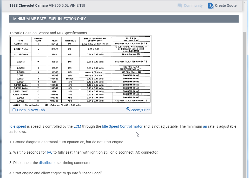

Hi kasekenny, trust all is well. we are in South Africa not too good (lock down stressful),but God is always in control.car question the car at timed at 6$ before TDC and idles smooth at 2500/3000 at warmed idles 15/20k. the following I done: had distributor and coil tested at a test center, new TSP, checked all hoses, IAC I took out and upon key on it came out fully (working),all plugs and leads working properly. took out TBI cleaned and that sprays evenly and fuel filter changed (was not dirty), obd no codes except 12 .revs no hesitation or backfire ,but the moment put in drive stars to miss behave slight backfire, rough engine rocks. i am now stumped .I even tried to move the TPS position slightly -no difference. the plug into TPS was broken and I don't know if I pined that right. i got the blue on top and bottom left black and white on bottom right. I tested the ref, on blue wire reads below 04 ohms. any help is welcome. God Bless.
Apr 25, 2020 at 6:49 PM
It's great that you always start your posts with the real priority.

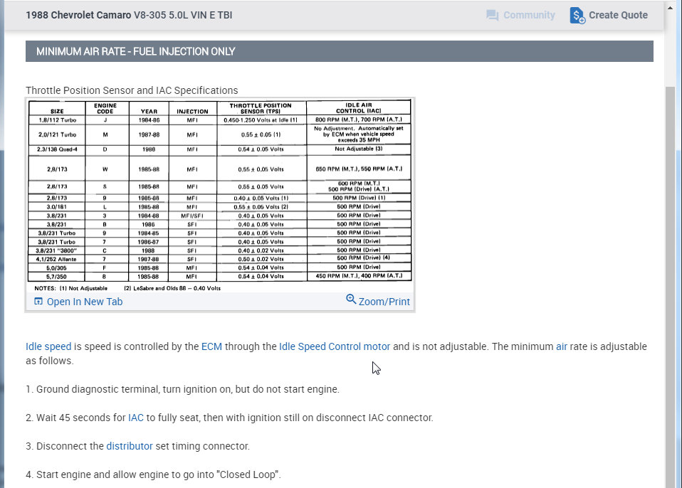

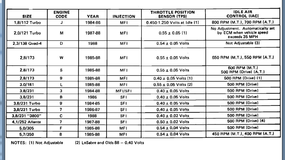

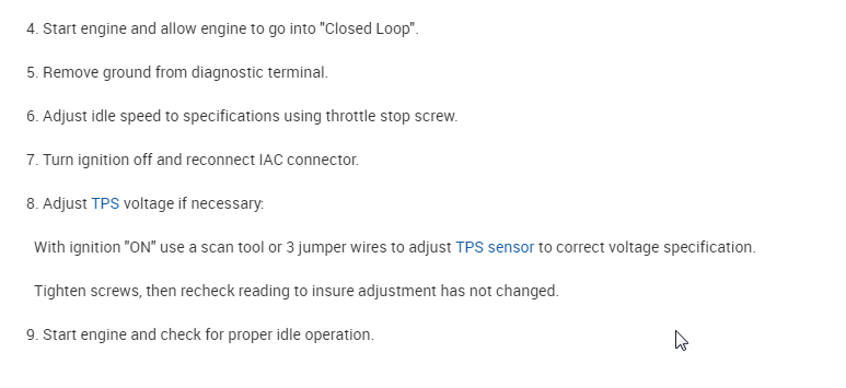

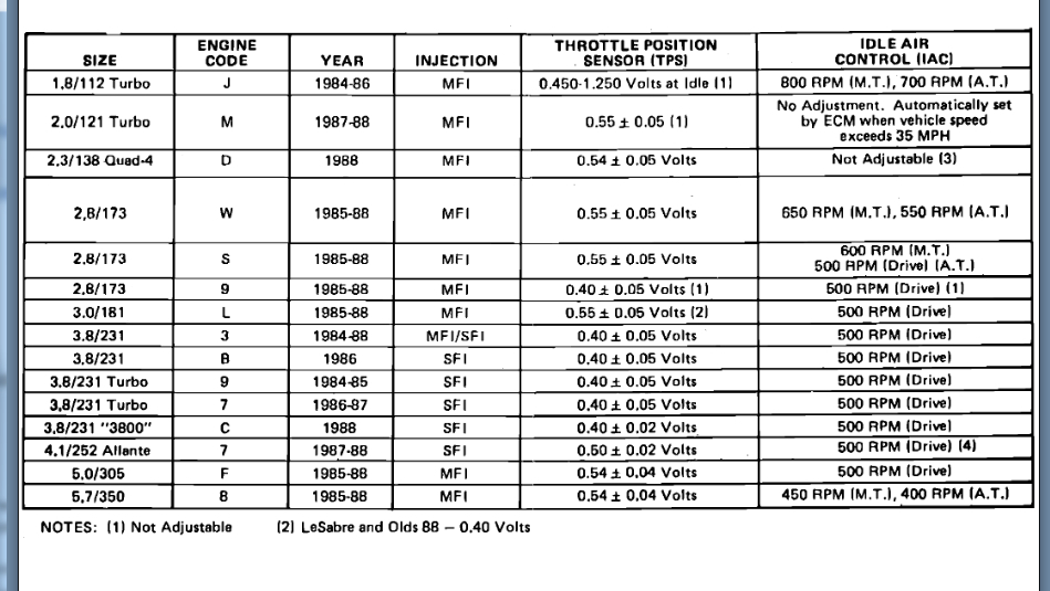

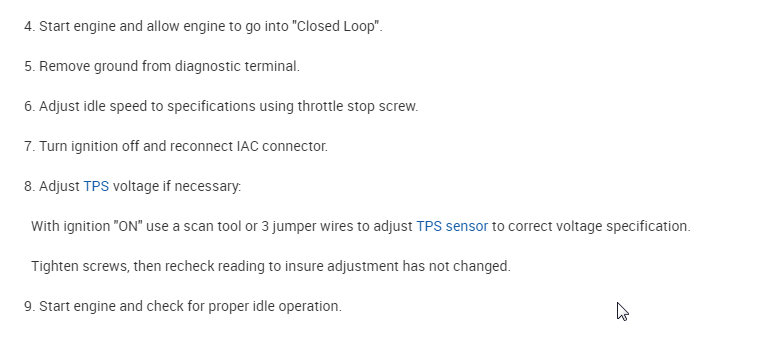

As for your high idle, as you are aware with it being TBI, idle speed is not adjustable. However, there is one process that we can try to reset which is the minimum air rate which will hopefully relearn the ECM's ability to control the idle.
I attached the process. Also, at idle we should be around 500 RPM and there is a chart showing the TPS voltage. When the vehicle is idling, note the RPM and then measure the voltage of the TPS. If the TPS is correct voltage but still has high idle then we know it is not the TPS.
Let me know what you find. Thanks

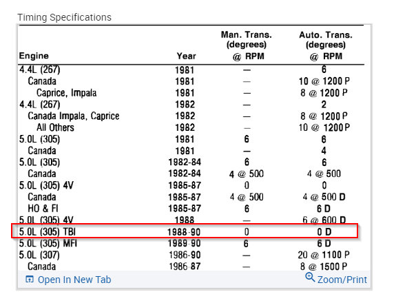

Hi Kasekenny, trust all is well on your side. we in South Africa still on lock down ,and the virus not flattening, but by His Grace he will see us through.i found that there was a break in TSP connector and fixed that ,also the color wire to pin connection was not roght as the original pliu in is broken.it seemed a little better,i also reset the IAC as per your guide; the car seemed much better but still not smooth when in gear. the idle seems around 20k and comes down to 15 rpms and fluctuates there ,the pintle came off and i screwed it back and i think that is now my major issue as to how much to screw in. i closed loop the engine but still its rough in gear ,but idles constant with no hesitation but dips below 20 rpm's to 15 and back up again ,the engine itself is not shaking ,and my timing set at 6 degrees before TDC. thank you for taking the time to walk me through. God Bless you and family.
Apr 28, 2020 at 8:42 PM
It will get better.
You mentioned it a number of times but I never checked it. The timing on this engine appears to be 0 BTDC. Lets set the timing there and then see what happens. 6 degrees shouldn't make that much of a difference but it could. Worth a try.

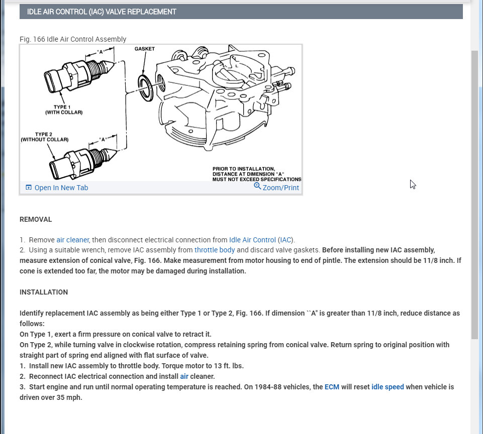

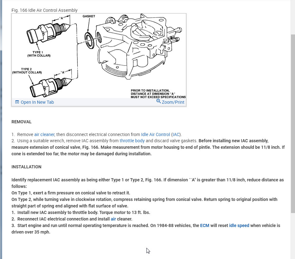

Hi Kenny, would you happen to know the measurement of the pintle in parked position in the IAC ,the to the open is 28mm .but my pintle came of and I refitted I also tried to reset but car still not right. thanks
Apr 30, 2020 at 12:25 AM
So this is interesting because I have never experienced this before. But you installed it at 28mm and the spec on installing the IAC is 11/8 inches which is 35mm (34.9mm to be exact). It cannot be any greater then this or it will damage the assembly. So let's install this at this length and retest it. Also, pay attention to the last sentence where it says on 84-88 the ECM will reset idle speed when driven over 35 MPH. So run through this process and then drive the vehicle and see if that fixes it.
Also, make sure you are measuring as the image shows. Thanks

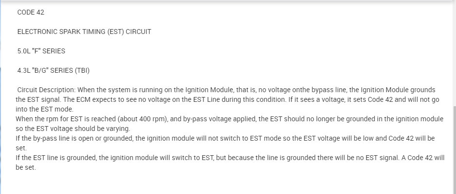

Hi Kenny, trust you are well. thanks for your time to address me. we in S.A . back to usual life with precautions, my car listed above 5l. TBI, v8 so far this what I done: I replaced the whole TBI unit with a second hand set, new rotor, plugs, wires, cleaned EGR and co2 sensor, MAP sensor, checked no vacuum leaks, timing set at 6% bdc. the spray from injectors evenly both sides, another temperature sensor: here is where we are at : normal temperature idling at15/25k , no missing or hesitation ,drive 30 seconds and then backfires through exhaust lots and if throttled then backfires through carburetor, the code 42 says est gnd or open. I don’t know how to fix .any help will be appreciated thanks God Bless.
Jun 18, 2020 at 4:49 AM
Great to hear. Parts of the USA are getting back to normal as well.

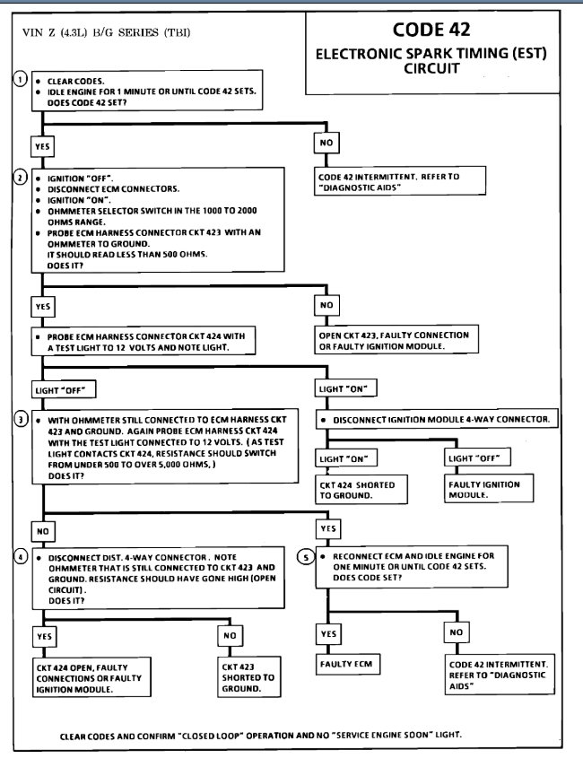

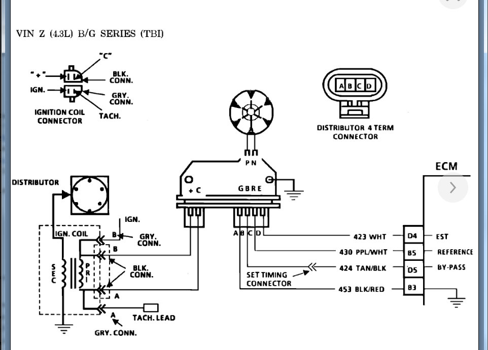

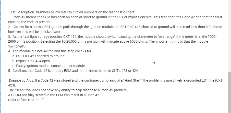

As for this issue we are going to have to get a new post started. Unfortunately we need to keep each post pretty tight to what the heading states. That way when others have the same issue you are they can find the answer. Backfiring is just a little too different then high idle, plus some may have backfiring on this vehicle and not a high idle so they will never find it under this post.
I attached the info about this code so if you can run through this and then post your results on a new post we will tackle this one with you as well. Thanks
