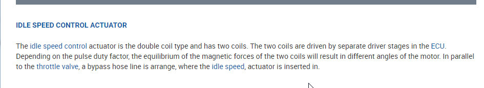

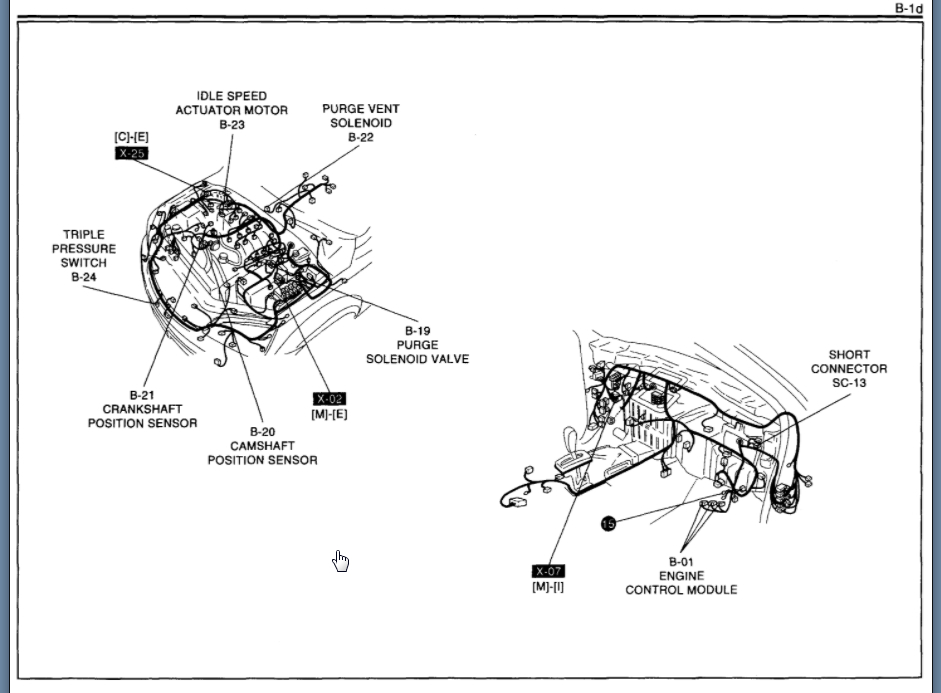

If the idle is returning that slowly and remaining that high then yes this will hurt your economy.
Sounds like you still have a vacuum leak. Can you put a vacuum gauge on the engine on a vacuum line and see what the gauge is doing?

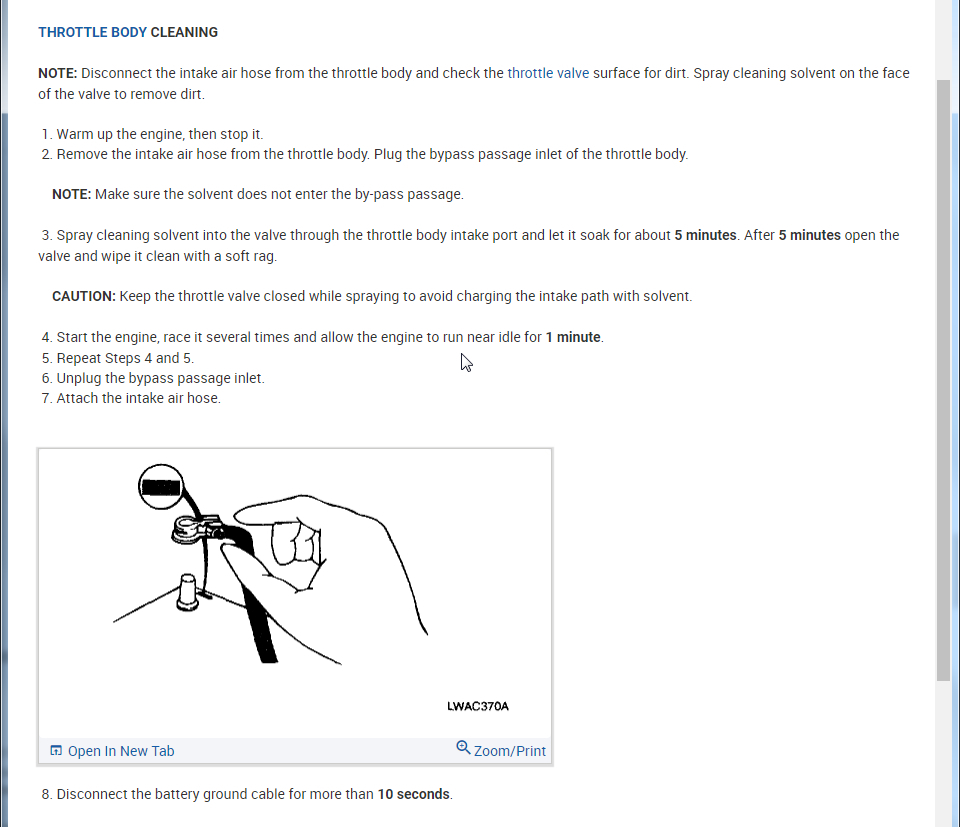

Also, we may have an issue with the throttle relearn. Basically when you clean the throttle body the ECM has not learned the new position of the sensors so the idle is high. The issue with this is that I don't see a relearn process which normally means it is an auto relearn after you disconnect the battery.
Below is the info from the manual.
I would suggest checking for a vacuum leak with the gauge and then disconnect the battery for a few minutes to force the ECM to go through a relearn.
Let us know what you find with this.
