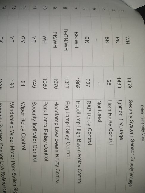

Okay, am I right on the connection c1 pin 7 on BCM?
Sunday, January 24th, 2021 AT 5:47 PM
  • 109,885 POSTS
According to the schematic, pin 7 is correct, but it comes from C2. Where are you seeing C1?

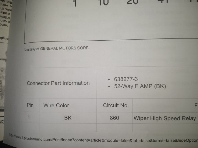

I gave them the VIN and that is what it came up with at one of the best auto shops in my area your schematics is for Pontiac gpx 2006. What color is connection 1 and 2?

Here is the con 1 and con 2 part number see if they match up to yours.
Sunday, January 24th, 2021 AT 8:10 PM
  • 109,885 POSTS
I'm sorry, but I can't read what you attached. Also, I am looking at a wiring schematic and can't tell what you attached.
