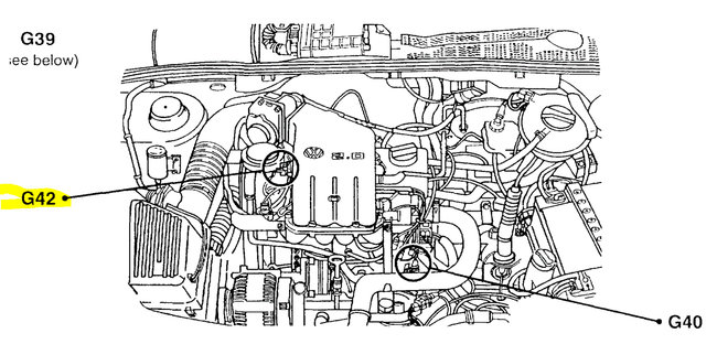

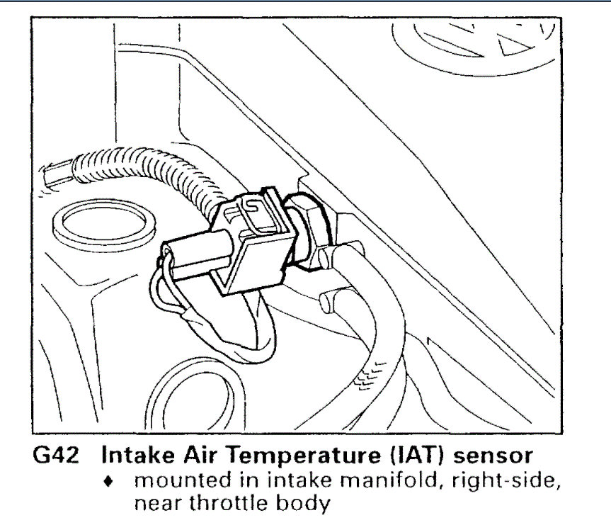

It's on the intake. Take a look at the two pics I attached below and let me know if you are able to find it.

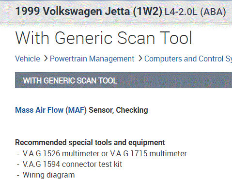

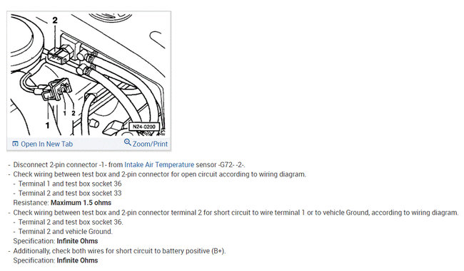

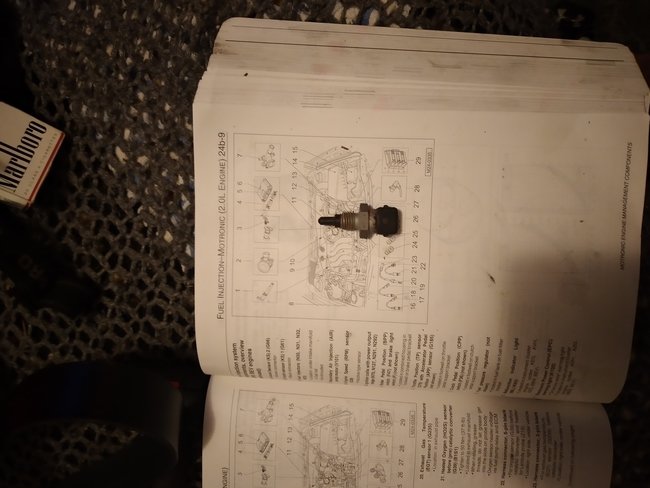

Okay, where is this intake air temperature sensor? i ordered one and this is the one they sent me.
May 3, 2021 at 12:45 PM
ADAM COWSERT
  • 41 POSTS

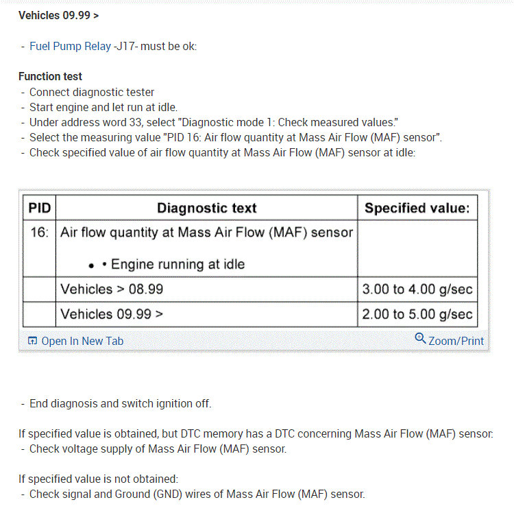

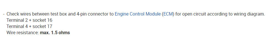

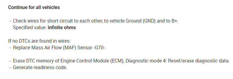

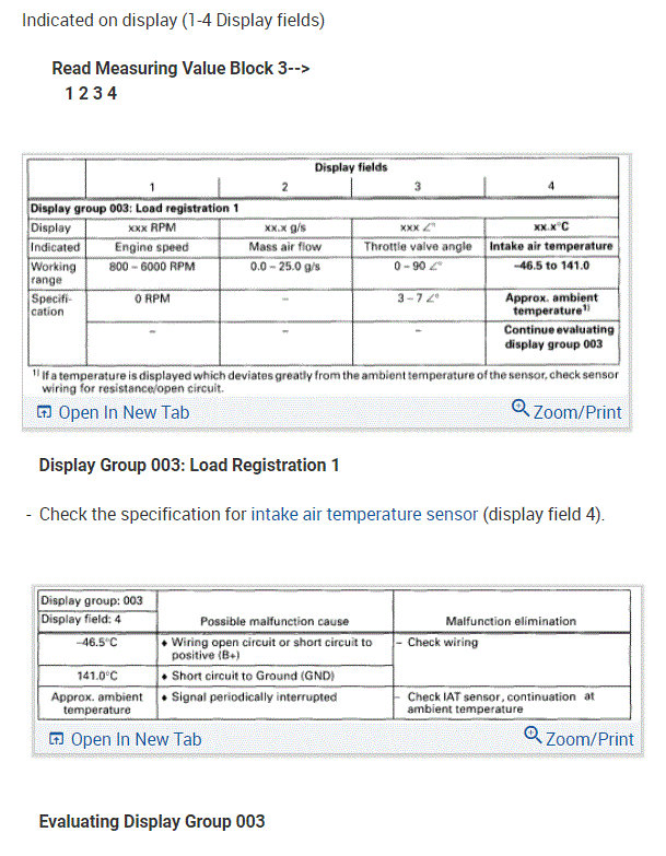

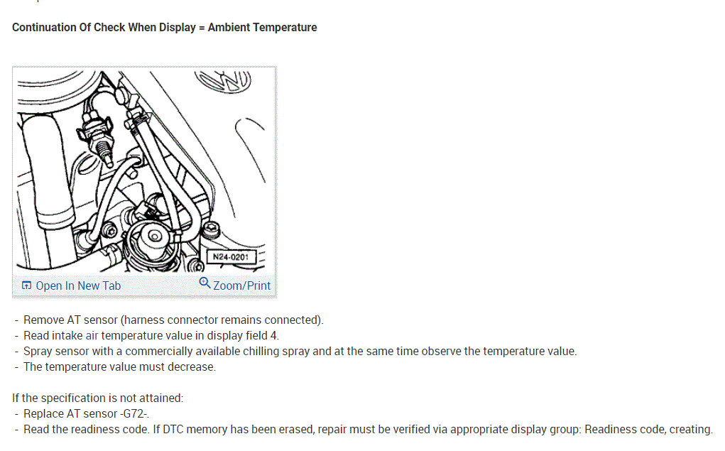

Well, now my car flashes up these codes p0112 and p0440 and the book that i have says the intake air temperature sensor is built in with the mass air flow sensor which i have replaced twice.
May 4, 2021 at 5:49 AM
  • 110,244 POSTS
That is correct. The two are combined.

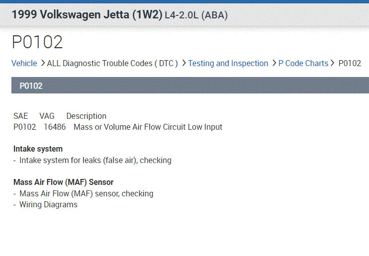

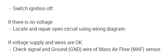

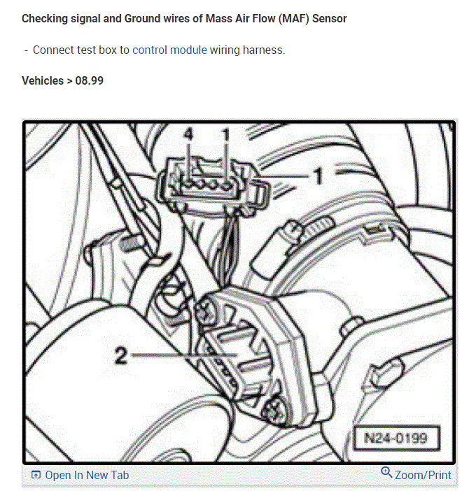

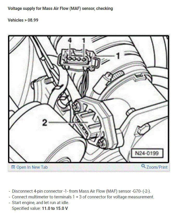

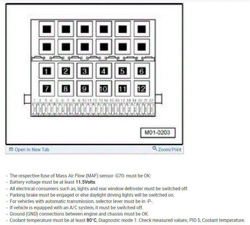

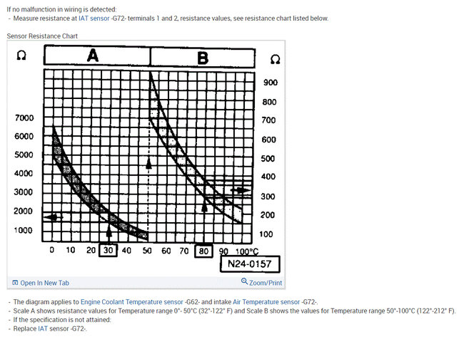

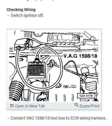

The problem is likely in the wiring. Clear the code and try a wiggle test to see if the code resets right away.

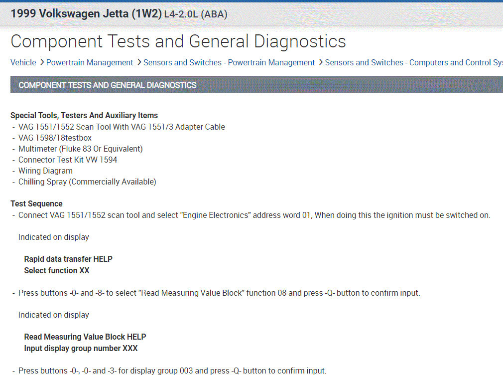

Other than that, you need to perform the diagnostics located below. It requires specific VAG tooling to complete. If you look at pic 1 below, it lists the things needed.
Let me know if this helps.
