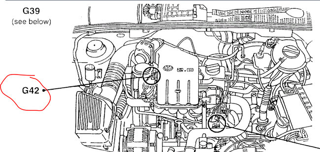

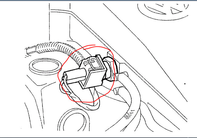

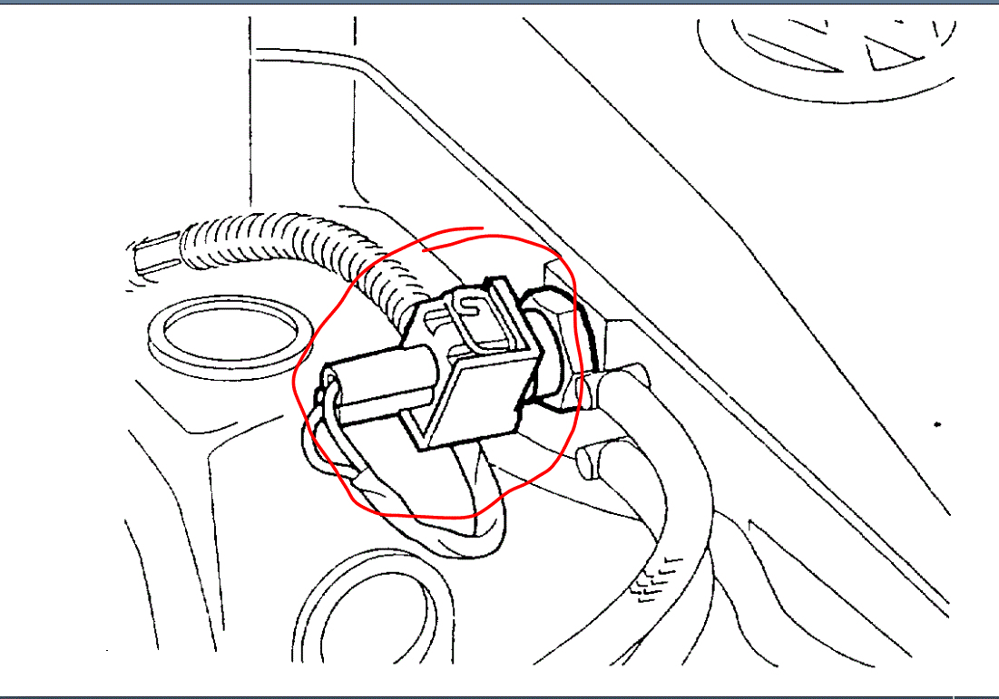

The P0112 indicates an issue with the air intake temperature sensor. That can cause drivability issues. I attached a pic below showing its location. Check to make sure there are no wiring issues, the connector is tight, and make sure there isn't corrosion in the plug.

I attached a pic below showing the IAT location. Check to make sure the connector is tight, clean, not corroded, and none of the pins are damaged.
Let me know,
Mar 19, 2021 at 11:54 AM
ADAM COWSERT
  • 41 POSTS
My motor doesn't look like that.
Mar 19, 2021 at 4:19 PM
  • 110,244 POSTS
It is a 2.0L, correct? That's the only one that was used.
Do me a favor. Take a pic of yours and upload it for me to see.
Mar 20, 2021 at 2:17 PM
ADAM COWSERT
  • 41 POSTS
Okay, my air filter goes the other way.

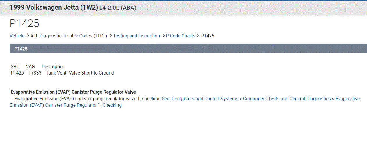

  • 110,244 POSTS
Hi Adam.

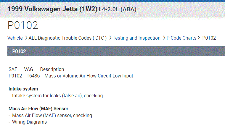

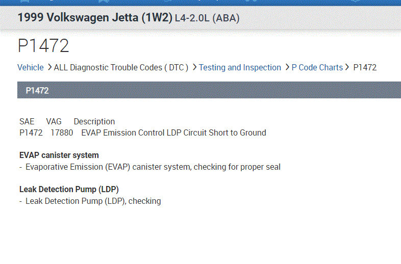

I attached pics below showing exactly what the new codes mean. Any can cause drivability issues. What I suggest is to first try to find engine vacuum leaks. Here is a link that shows how it's done:
Below are the definitions for the codes. The reason I'm suggesting checking for a vacuum leak is because that can be causing the MAP code. Two of the codes are likely related to a leak.
Let me know what you find.
Mar 21, 2021 at 11:17 AM

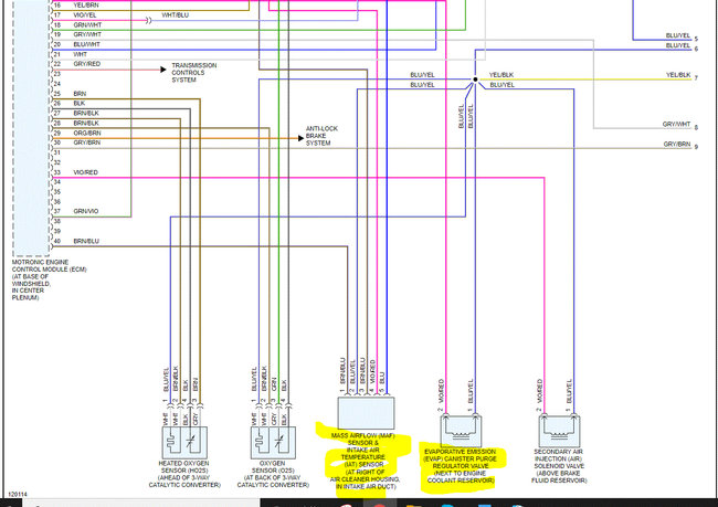

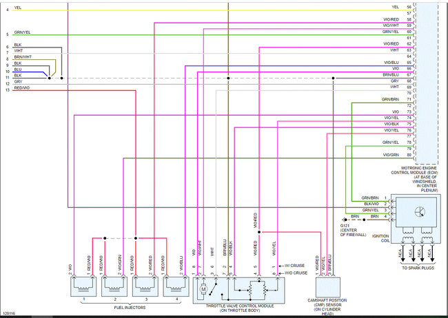

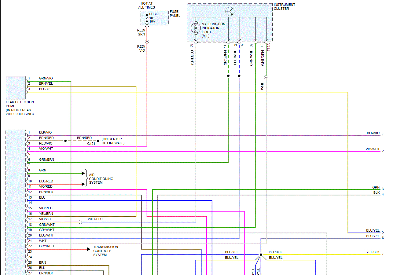

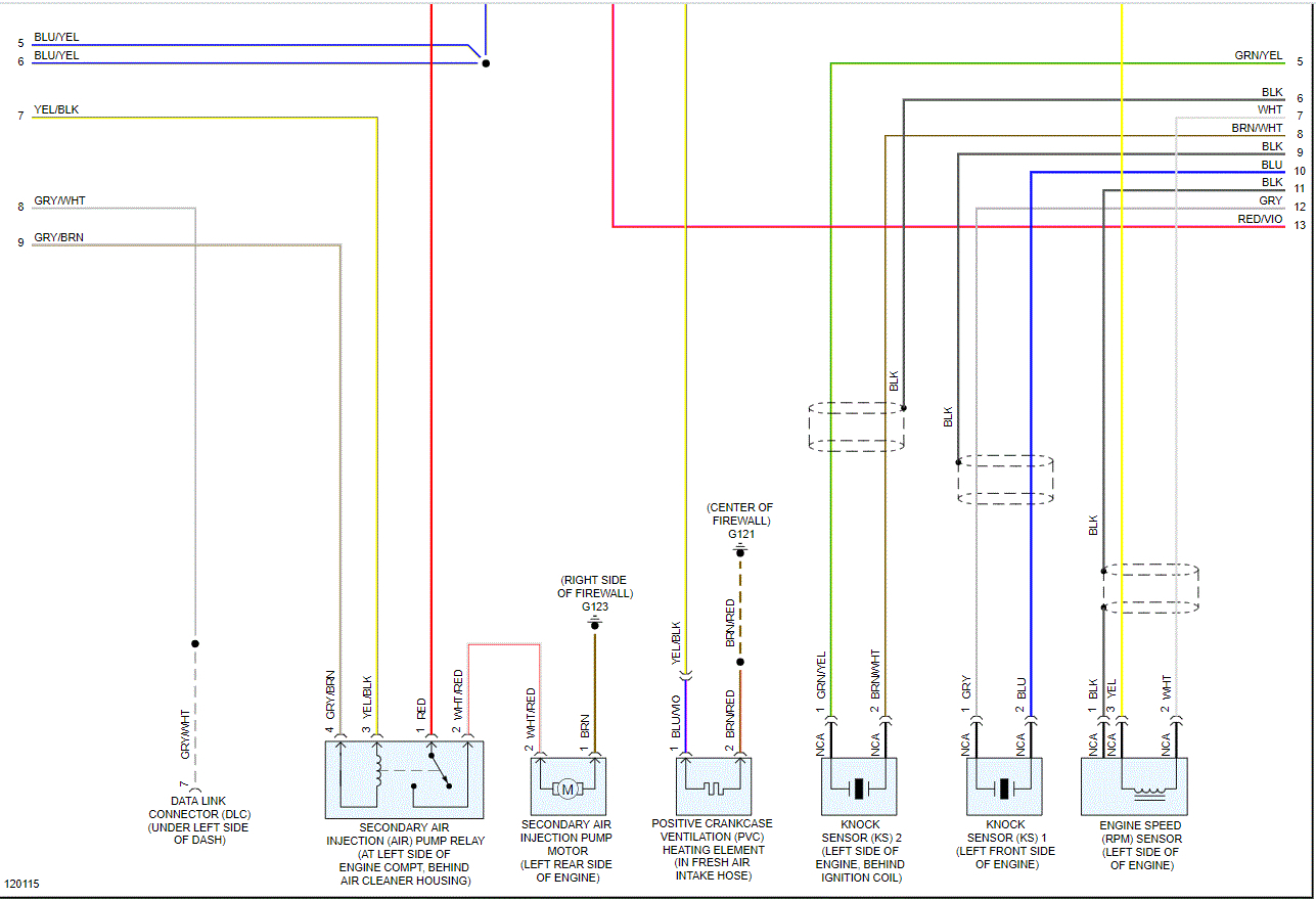

And the codes that keep popping up are p1425 tank ventilation valve short to ground, and a p1472 evap control system ldp circuit short tk ground and then a p0102 mass or volume air flow circuit low input. so wouldn't that mean that it's in the wiring?
Mar 22, 2021 at 12:54 PM

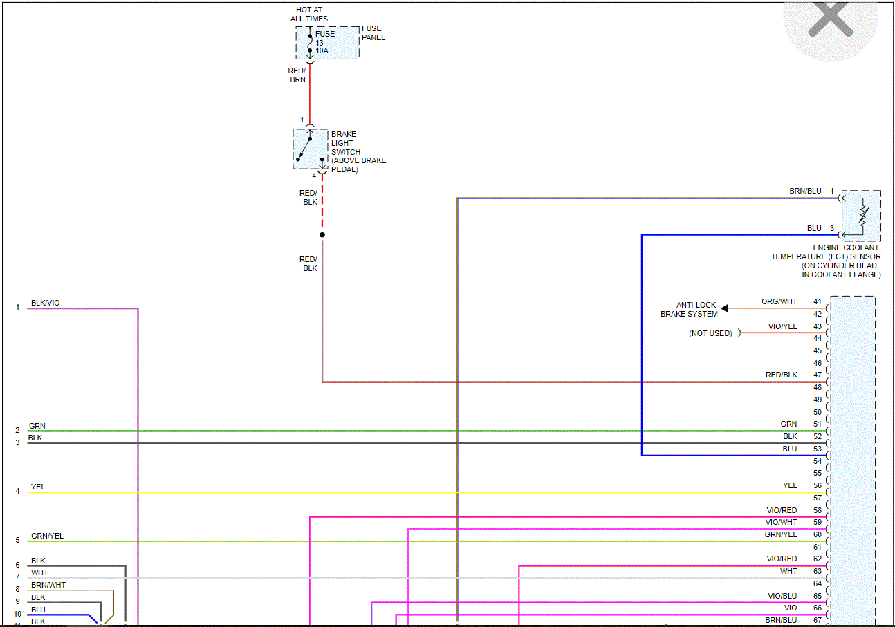

  • 110,244 POSTS

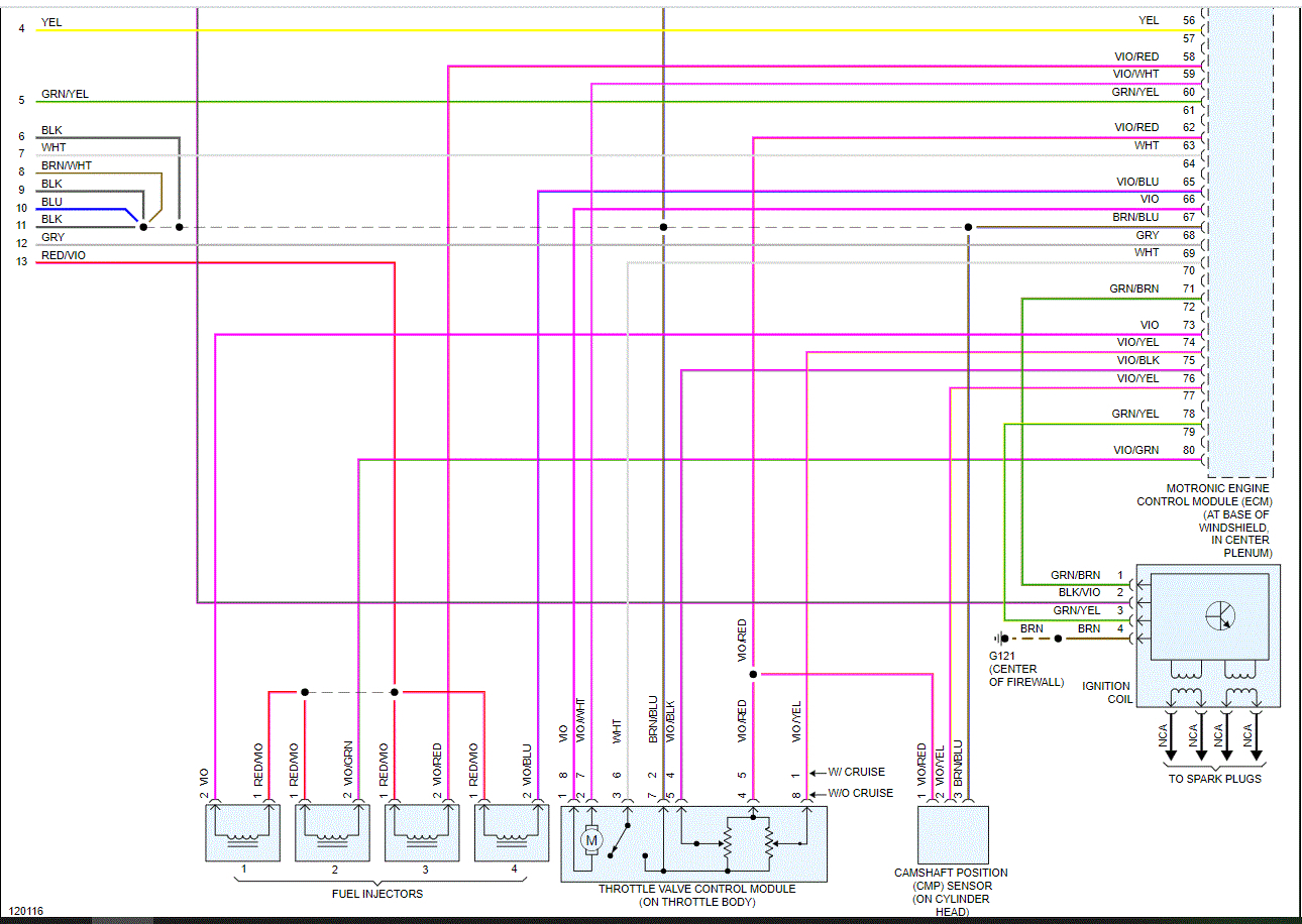

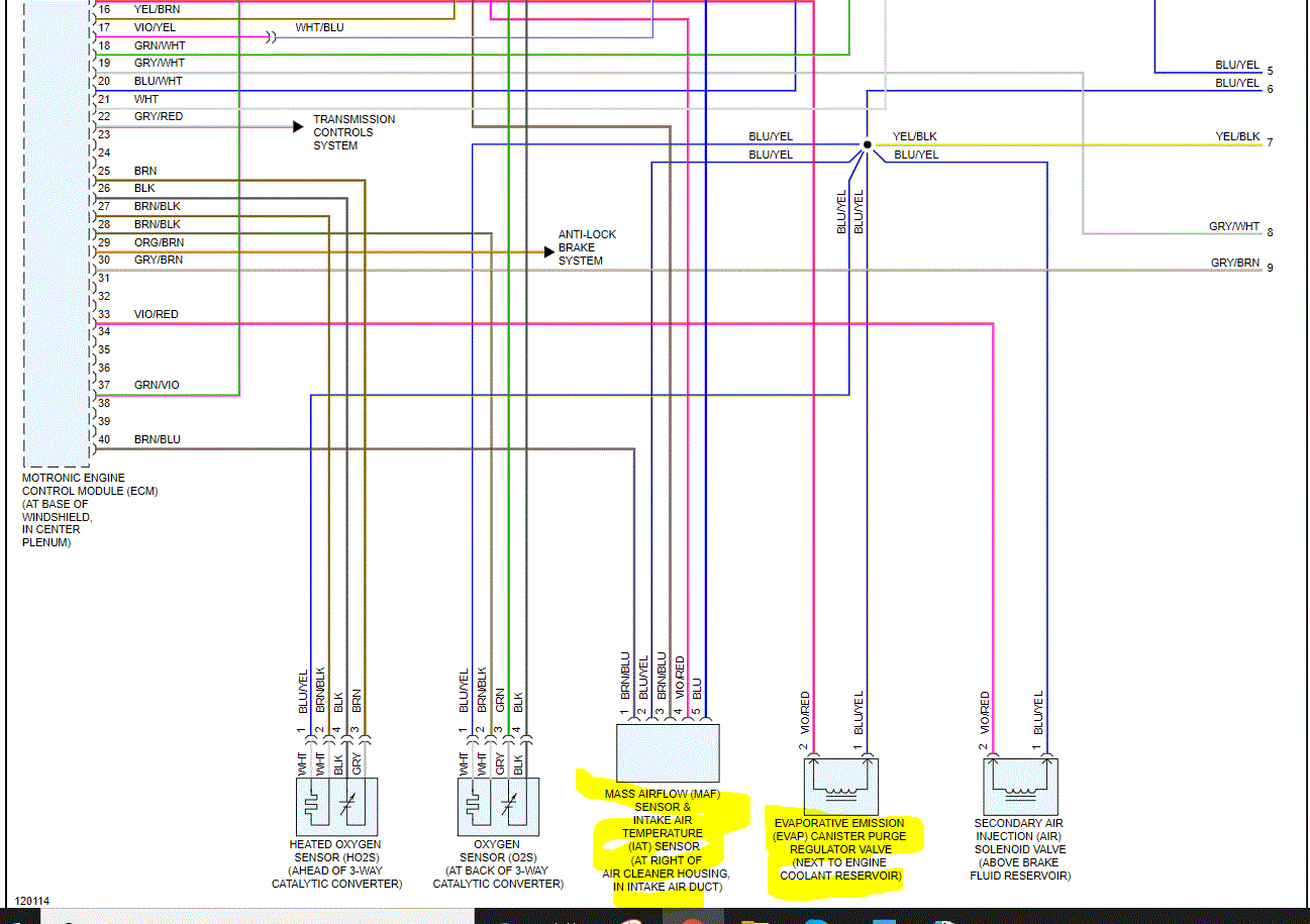

The sensor itself can be bad. If it is related to low input, it could also be a short. As far as the EVAP components, they are certainly indicating a short.
I attached the entire powertrain management schematic below. I had to cut the pics in half to make them readable, but I did overlap them so you can follow them easier.
Mar 22, 2021 at 1:39 PM

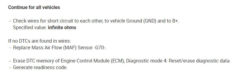

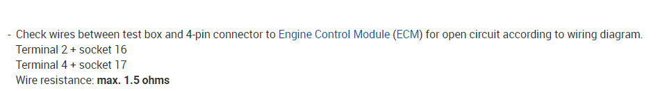

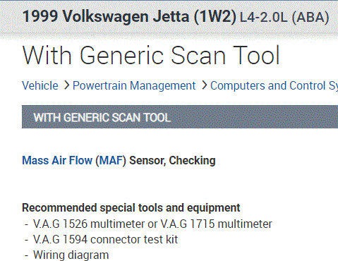

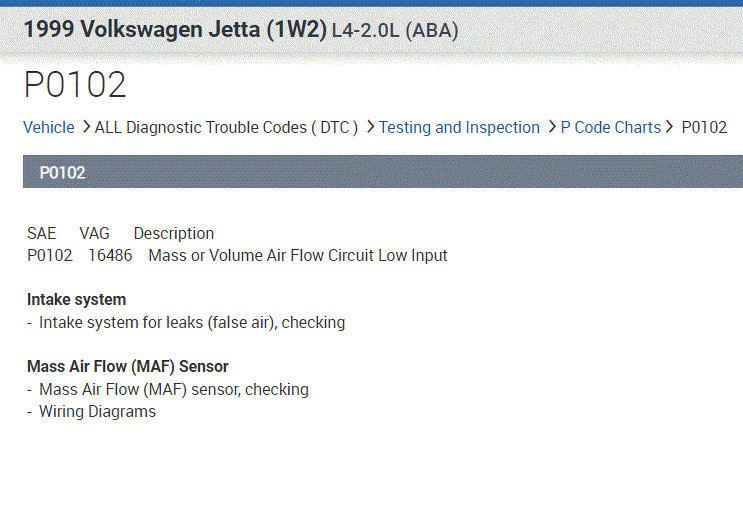

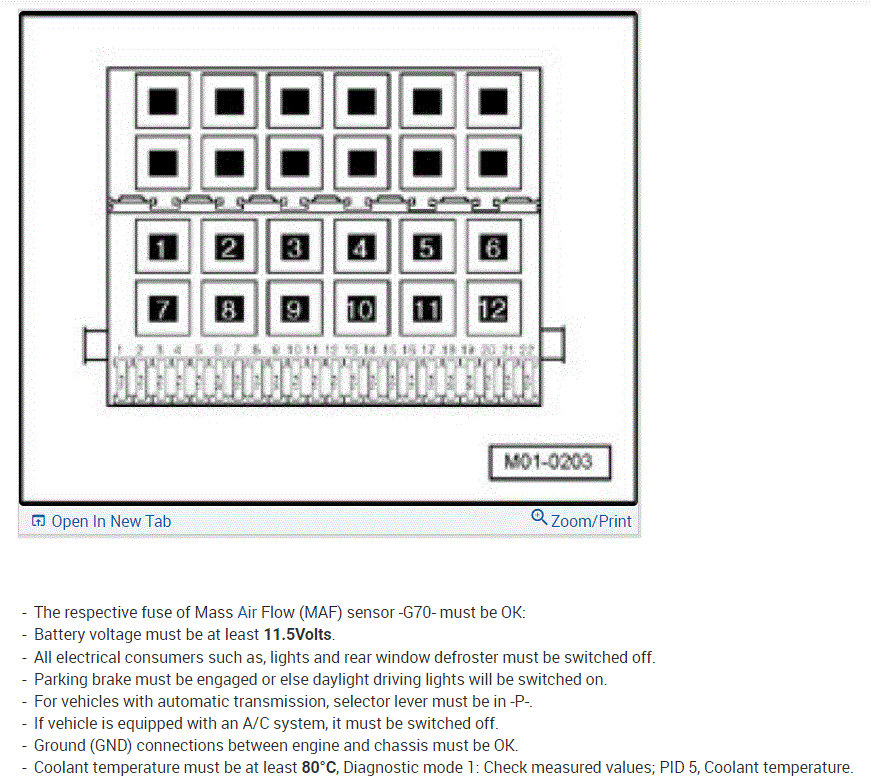

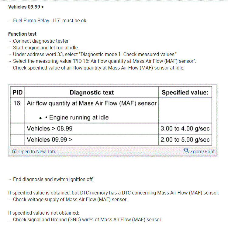

  • 110,244 POSTS

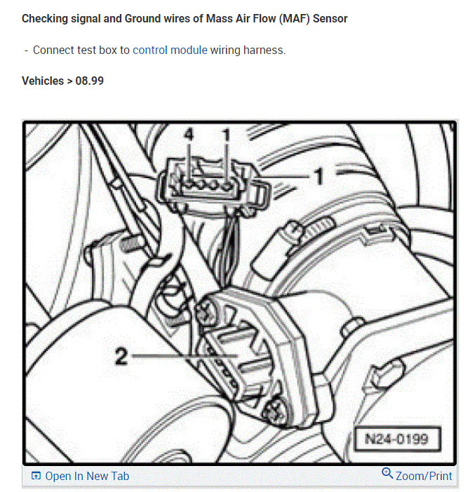

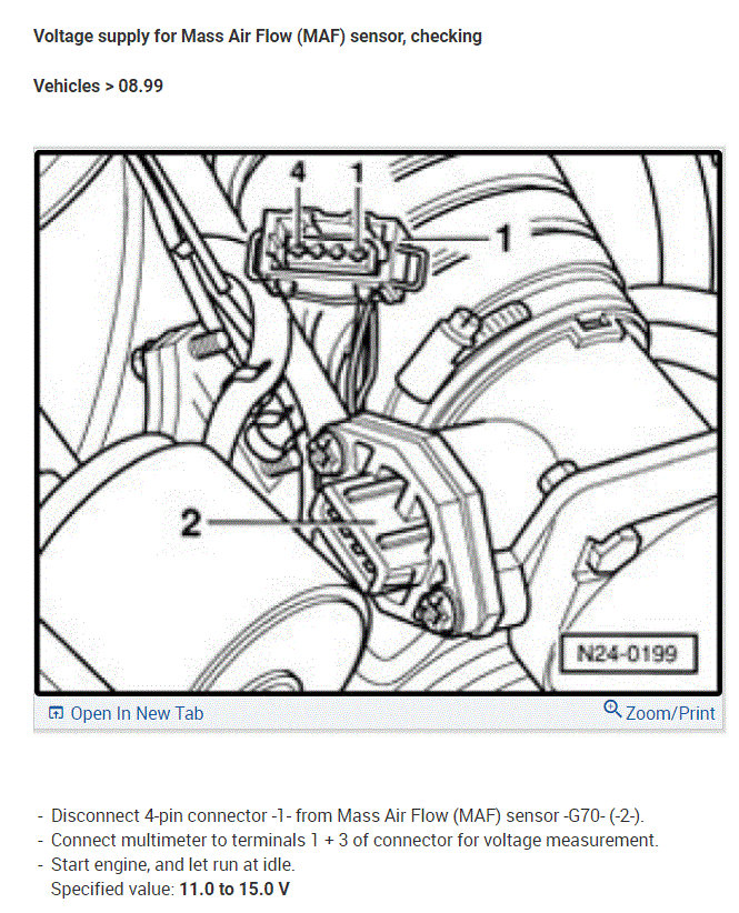

I think we need to focus on one at a time. If we try to hit all of them, we'll go crazy. So, let's start with the P0102 (mass air flow) code.
If you are certain there are no engine vacuum leaks, follow the directions specific to this in the attachments. The flow chart should point you in the right direction.
Note: I selected the diagnostics to be done with a basic scan tool. If you have access to VAG codes, let me know what they are. I can narrow it down further.
I picked the MAF first simply I feel that if it is fixed, other codes may go away. I realize you replaced the sensor, but there has to be a wiring issue. Following the directions below, you will be confirming power and ground to the maf. I suspect you will find a ground issue.

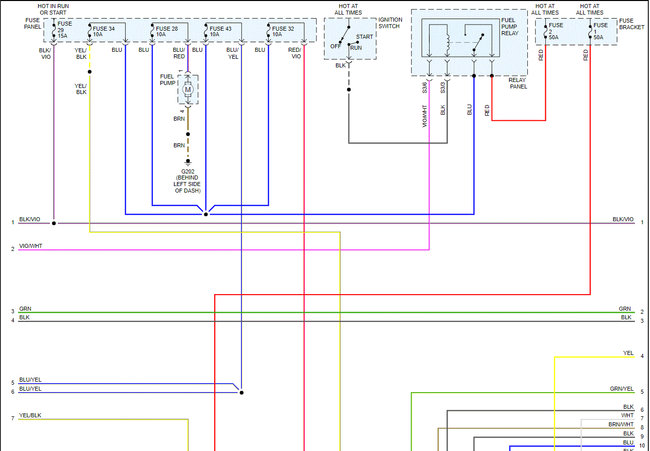

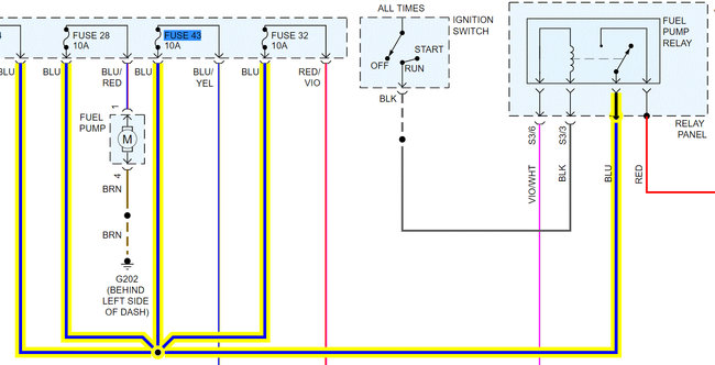

Okay, if the fuse in slot 43 was taken out that would probably make the check engine light come on, huh?
Apr 25, 2021 at 5:52 AM
  • 110,244 POSTS
If you remove fuse 43, it shouldn't run. That powers different engine controls. So, yes, it should turn the check engine light on. It will stop the fuel pump, and power to the fuel injectors.
I attached a pic of the schematic showing the fuse.
Apr 25, 2021 at 11:31 AM
